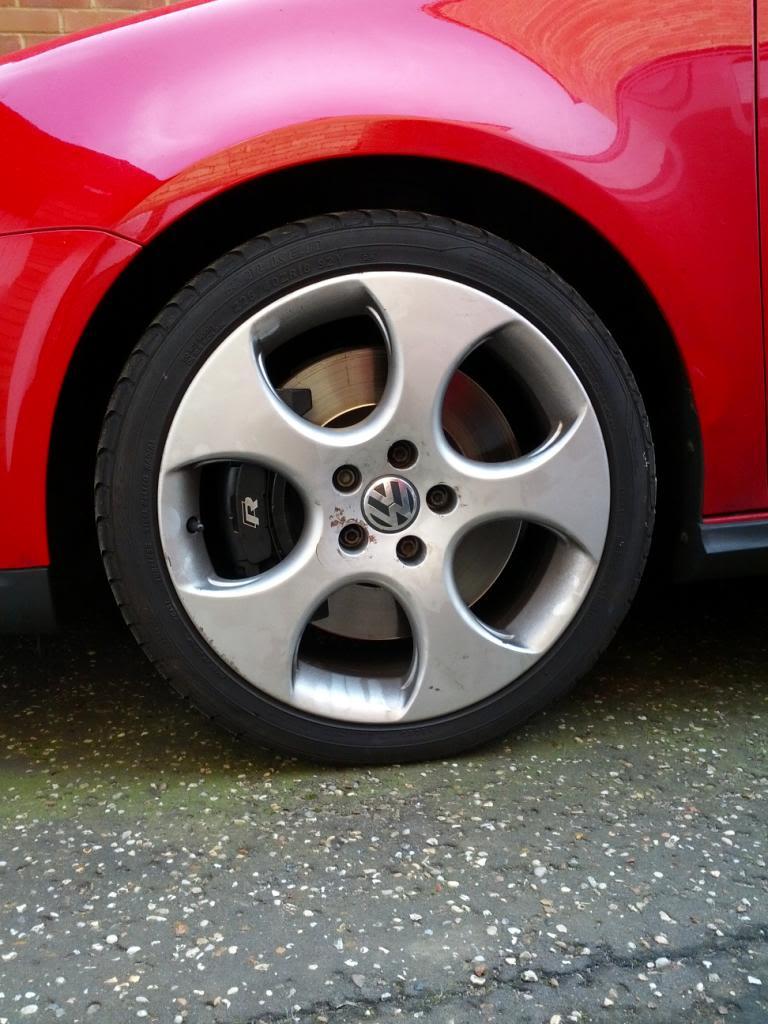

Time for some more pictures and words about how I’ve achieved nothing with the car over the last month. So to start, I’ve got the first official picture of the (long awaited) Golf R20 front brakes installed!

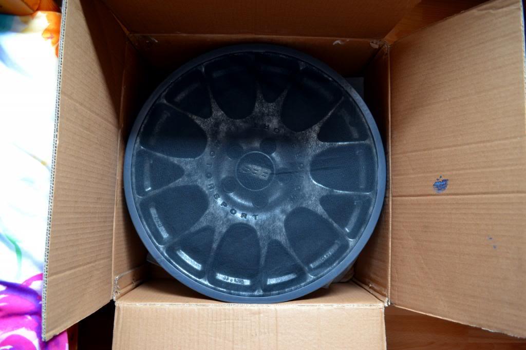

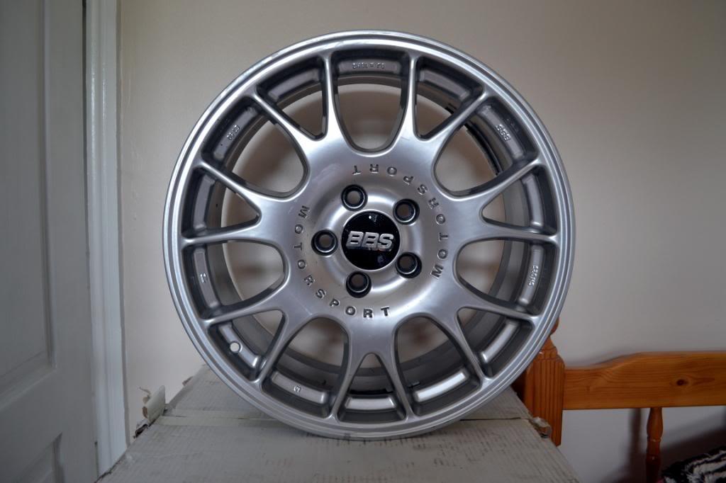

I endeavour to get some much better picture once the cars all up and running again, which is still TBC at the time of writing this. Next up, finally got some nice new alloys cheap.
Bagged these for a tidy sum of £450, few scratches but nothing a refurbishment won’t cure. Going to get them powder coated, but as for colour, I’m swinging towards a gun metal grey at this moment in time, but like everything that’ll be subject to (a lot of) change. On the subject of powder coating things;

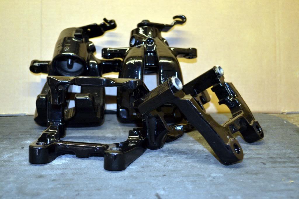

They came up pretty well considering how corroded the calipers were in the first place. The inside finish is a little off in my opinion but considering it’ll never be seen, I can forgive them. The parts on display are finished to a high standard though, and it’s on there pretty well so fairly pleased. Got the hand brake part of the calipers sorted and starting rebuilding them but ran out of time this weekend;
Next step is to get the calipers rebuilt fully, stainless steel brake lines ordered, some new pad retaining clip things as I’m missing one from the original set and clean up the discs. Just to ensure that everything is lovely and all that jazz when I finally get her back on the road, I decided it best to get some decent pads;

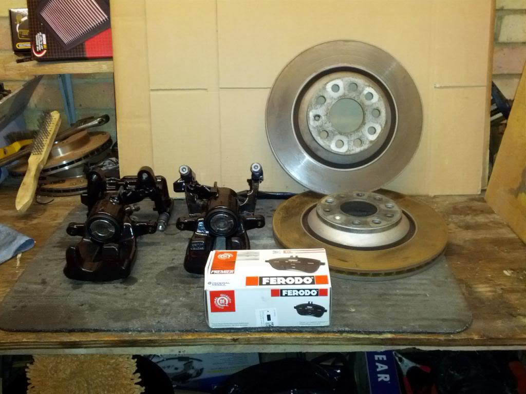

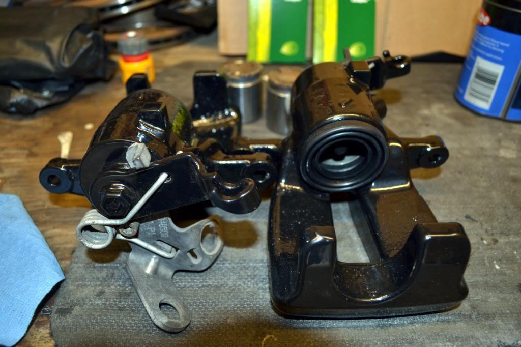

So today I've worked more on the rear calipers, but in the process I've damaged the guide bolts so they're being replaced. Also bought new bleed nipples and a piston rewind tool to finish off the piston part of the build. Also ordered the rear stainless steel lines.

Slow and steady progress again, but pleased to report that the rear calipers are now fully back together (respectively) and discs have been cleaned up, HEL lines ordered and everything placed ready for the trip to AmD.

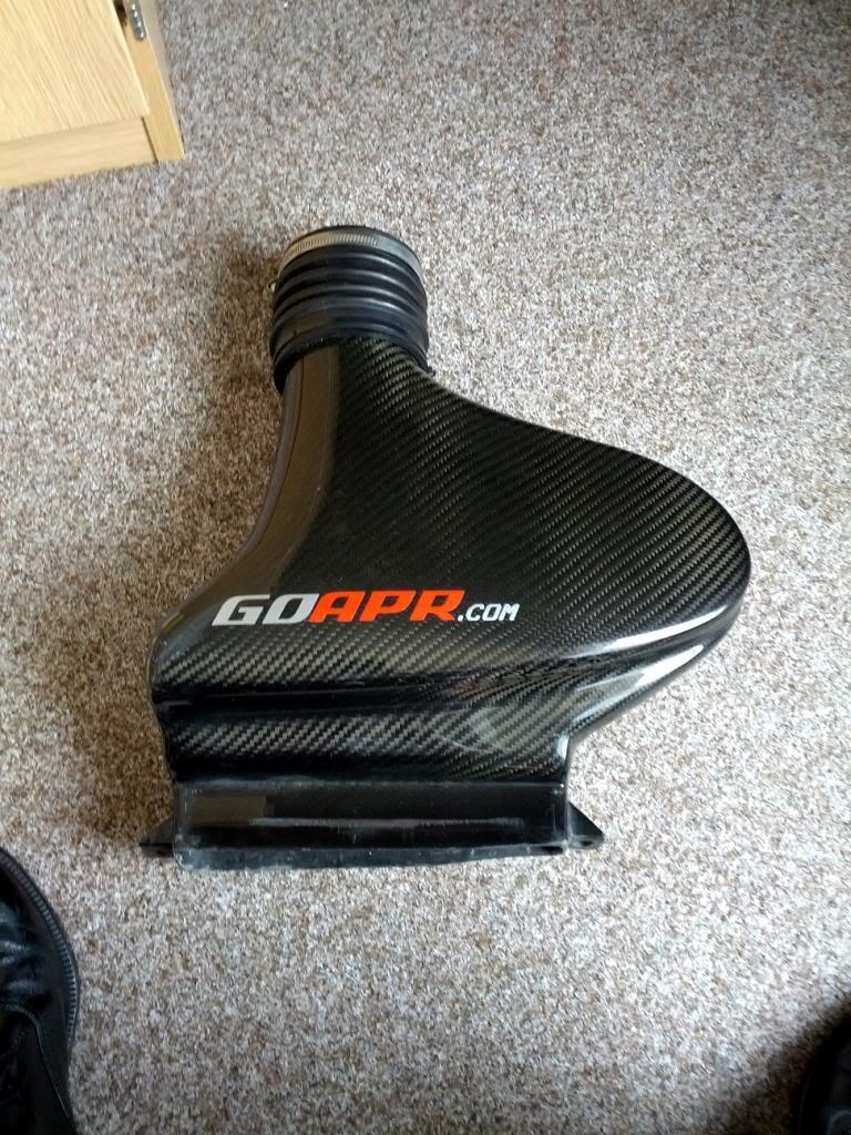

Also decided it was time to begin stage two tuning;
I reckon 10-15BHP extra easily with that fitted to the car, shall report back once I get her back on the road. Going to bring the day at AmD forward to this coming Monday/Tuesday, can’t be dealing with a week off and no car so bringing it forwards. I think it’s nearly two months since I last properly drove her beyond my driveway!

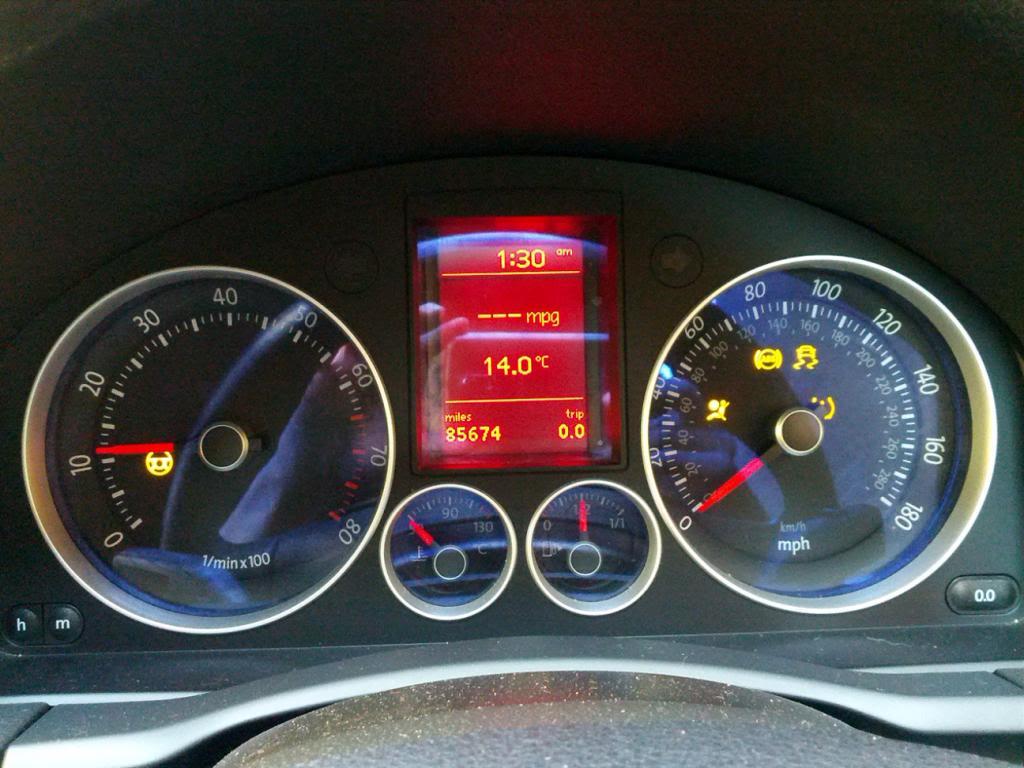

So, going back in time a little, this is how my heads up display looked prior to this weekend;

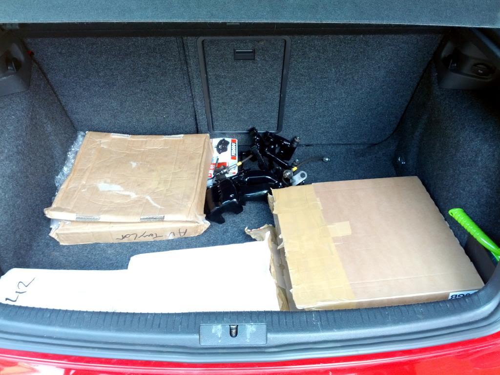

Ever been Southend sea front at Christmas? Reminds me of that. Loaded up the boot with the rear R32 brakes in preparation for my tow to AmD;

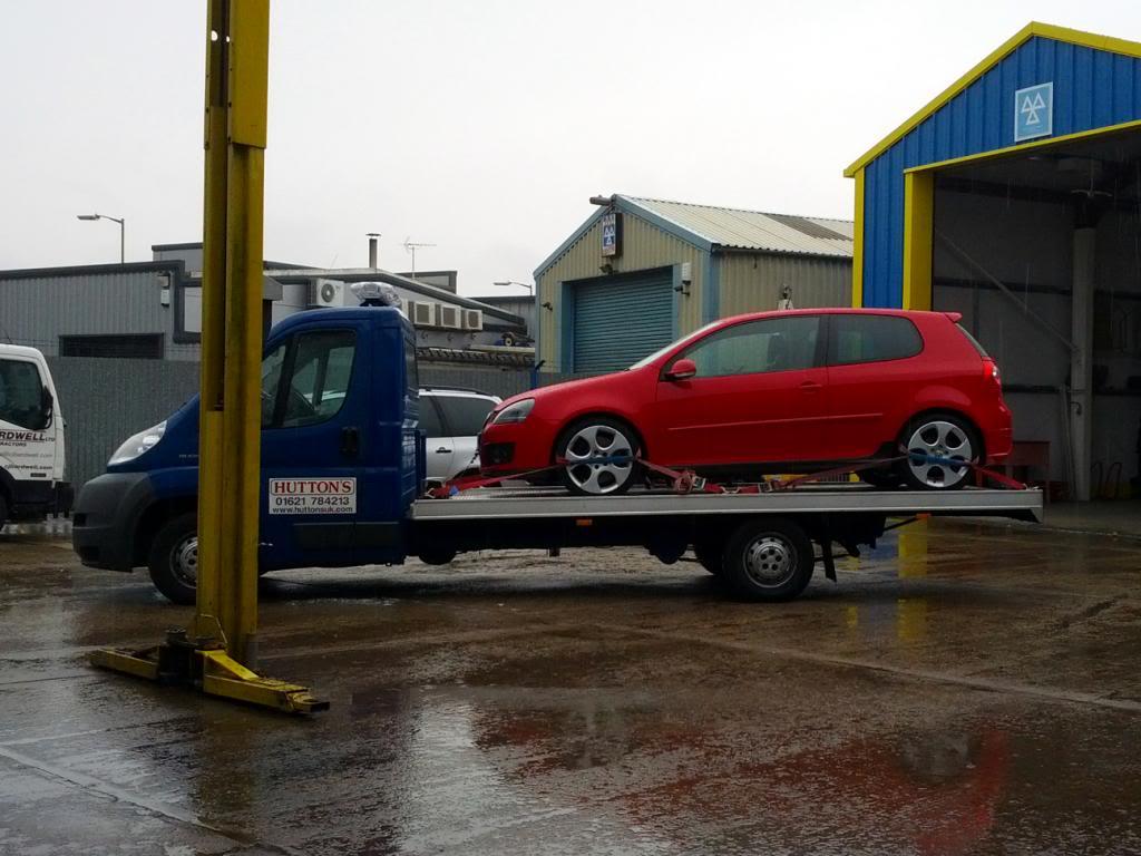

Thursday rolls round, time to put her on the back of a flat bed. Feels like admitting defeat, or that hung-over walk of shame the morning after…
Early start on the Friday, get to AmD for about 10am, spend a lot of time waiting to get a phone call saying the rear brakes didn’t fit correctly. Was a little bemused, but transpired they meant my rear dust shields didn’t fit as they’re for a mk6 Golf R which has a different axle shape so they're not backwards compatible. Not the end of the world running without them but still slightly annoyed.
Many, many hours later, the guys pop up to the waiting room and tell me there’s another problem with the rear brakes. The passenger side caliper was just losing all the fluid in a rather bad manor where the brake hose meets the caliper, looks like I’d cross-threaded the bolt as I screwed it in so fluid was just flowing out, even at normal pressure. Result: new caliper needed, along with new hose mountings (solid lines that then attach to stainless steel lines). So they didn’t end up going on and I had to get my stock rears re-fitted. Devastated.
Also found the reason my brake pedal was just sinking to the floor even though there was no apparent air in the system after several bleeding cycles. I’d somehow managed to fit the front calipers upside down (effectively swapped the sides over). So because the bleed nipple was at the bottom, all the air was trapped in the top of the caliper. Felt like a massive c*** in AmD, decided there and then to give my tools away and give up doing things myself for the sake of further embarrassment! Credit to the guys there, they were really good about it and told me of some worse case situations they’ve had to fix to cheer me up.

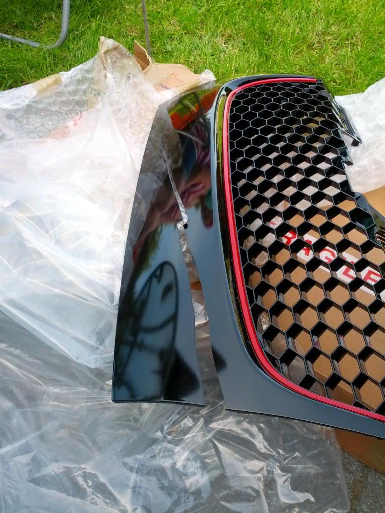

I managed to find a JOM badge-less grill on eBay going for £55, but sadly when it arrived it was damaged;
A quick message to the eBay seller and they said they will replace it as soon as more came into stock, and I shouldn’t need to ship the old one back to them, so potential repair and sell it on cheap I reckon. Need to now look into the best way to secure a front number plate using magnets.
