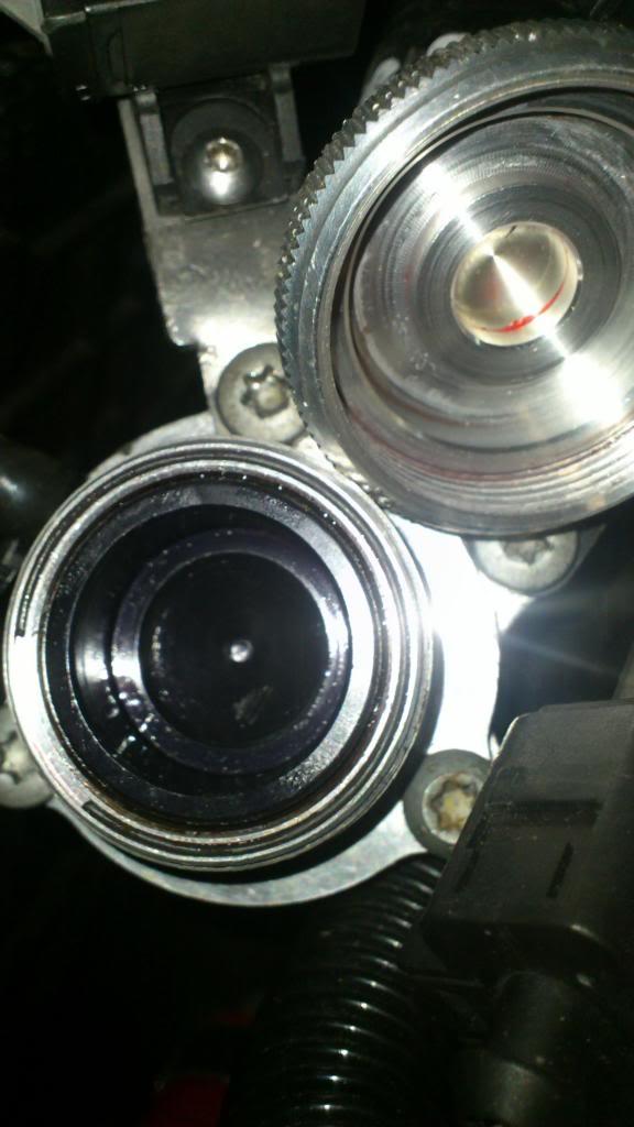

Also found this:-
 :confused:
Silver is the way !
Offline vRSAlex
  • -Receive: 253
  • Posts: 2761
Re: Engine shut down under boost - fail safe?
« Reply #16 on: February 14, 2014, 09:50:23 pm »
Seen that a few times with that o ring.
Try a g valve.
Follow AKS tuning on Facebook
Offline bacillus
  • -Receive: 453
  • Posts: 6340
« Reply #17 on: February 14, 2014, 09:57:58 pm »
What are we looking at here Alex?

The O-Ring on top of the Piston, has a part missing  :sad1: Will try the rev G on, could something so simple cause the problem, of it dropping down on the rev's so far it cuts out?
So is that an opened Forge DV I'm looking at Neil?
Offline scopes
  • -Given: 131
  • -Receive: 115
  • Posts: 2283
  • Wolfsburg Edition
    • My GTI
« Reply #21 on: February 14, 2014, 10:48:42 pm »
Yes Ayoub, that's were the spring goes, with the top/lid beside it  :happy2:
Silver is the way !
Offline bacillus
  • -Receive: 453
  • Posts: 6340
« Reply #22 on: February 14, 2014, 10:58:00 pm »
Have you rung Forge, explained your problem and asked for a service kit?
iirc it includes a new rubber O-ring, new piston and some grease and they sent it out for free a while back.

Yes emailed them today, with the pictures, still waiting to hear back, be early next week i would assume  :happy2:
A service kit would be useful !

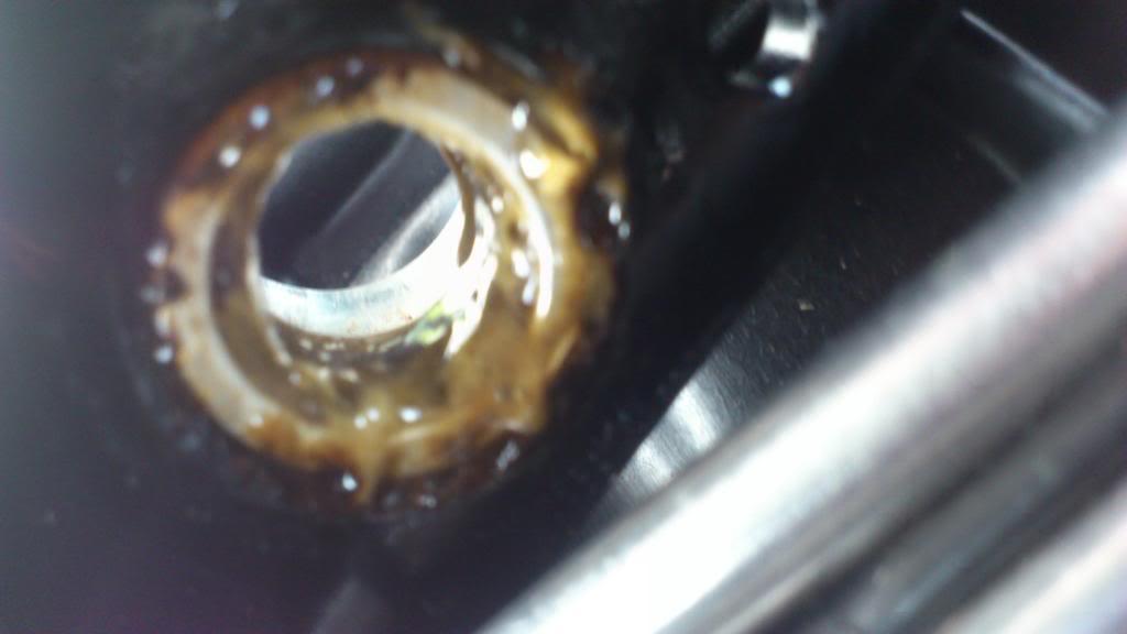

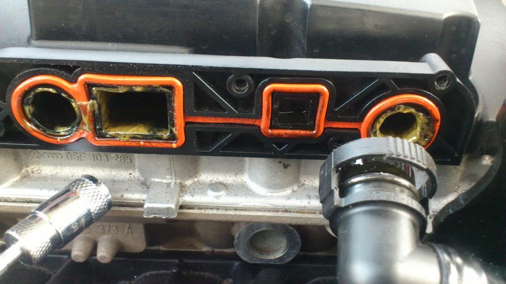

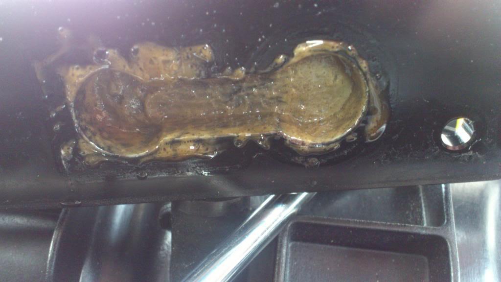

Well tried the OEM pcv on today, trying to rule things out... Didn't fix it, Like the pcv fix much better. I did the dipstick test and idle went funky, i did test the pcv first, that just double told me it was ok.
Anyways when i took it of, i found some of this :-

From what i'm aware this can be down to the weather, or cold/war air causing moisture...
Maybe a new gasket for the PCV fix and a good run!
 :confused:
Could a boost leak cause this to happen?
Silver is the way !
Offline H17YD_L
  • Posts: 137
« Reply #26 on: February 20, 2014, 12:44:47 pm »
Mine looks like that all the time, is the under side of your oil cap like that? Short journeys is all I do and its like that.
Hey matey
no no, the odd time i would get the milky stuff round the oil cap, but thats only on short journeys, most the other times i check it clean.
car getss serviced every 4-5k miles, always used castrol 5 - 30.
Always geniune parts.
I did clean it the other day, then checked angain the day after, it was not anywhere near as bad, so i will run it for a week and then check and again 2 weeks after that...
Anywhere i have read about this, it seems to be the cold weather, with the cold weather in, i would not get on, many longer journeys, maybe just needs a good run...

Just thought I'd mention as my PCV looked like that till I removed it and fitted a catch can. Still get that sh1te everywhere tho, but I just give it a decent run and it goes. Don't think it's anything to do with your other fault. Hope you get to the bottom of it.
