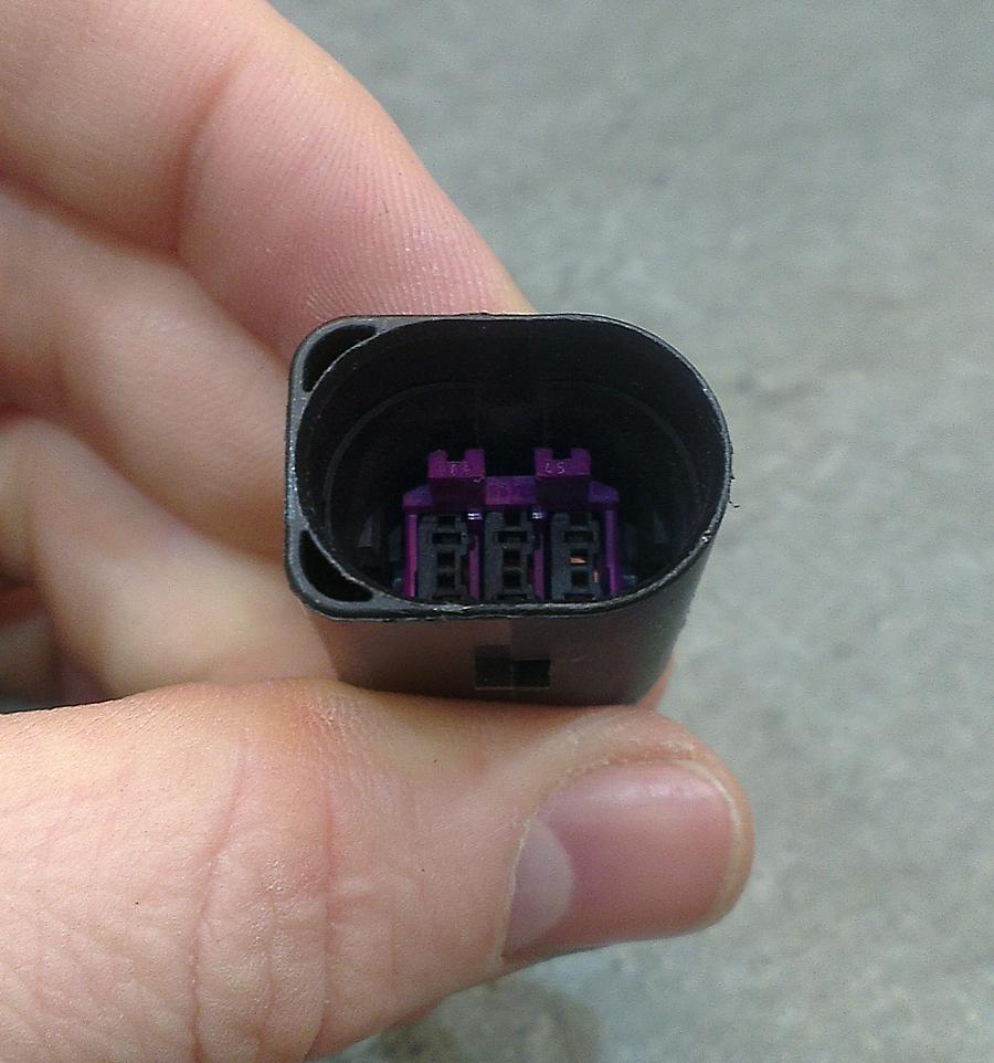

This is the EGR plug. You can see the top right hand corner is squared off.

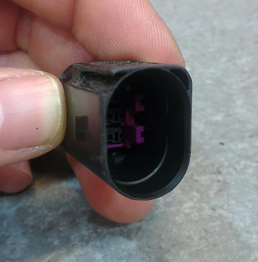

And this is the plug as it came.

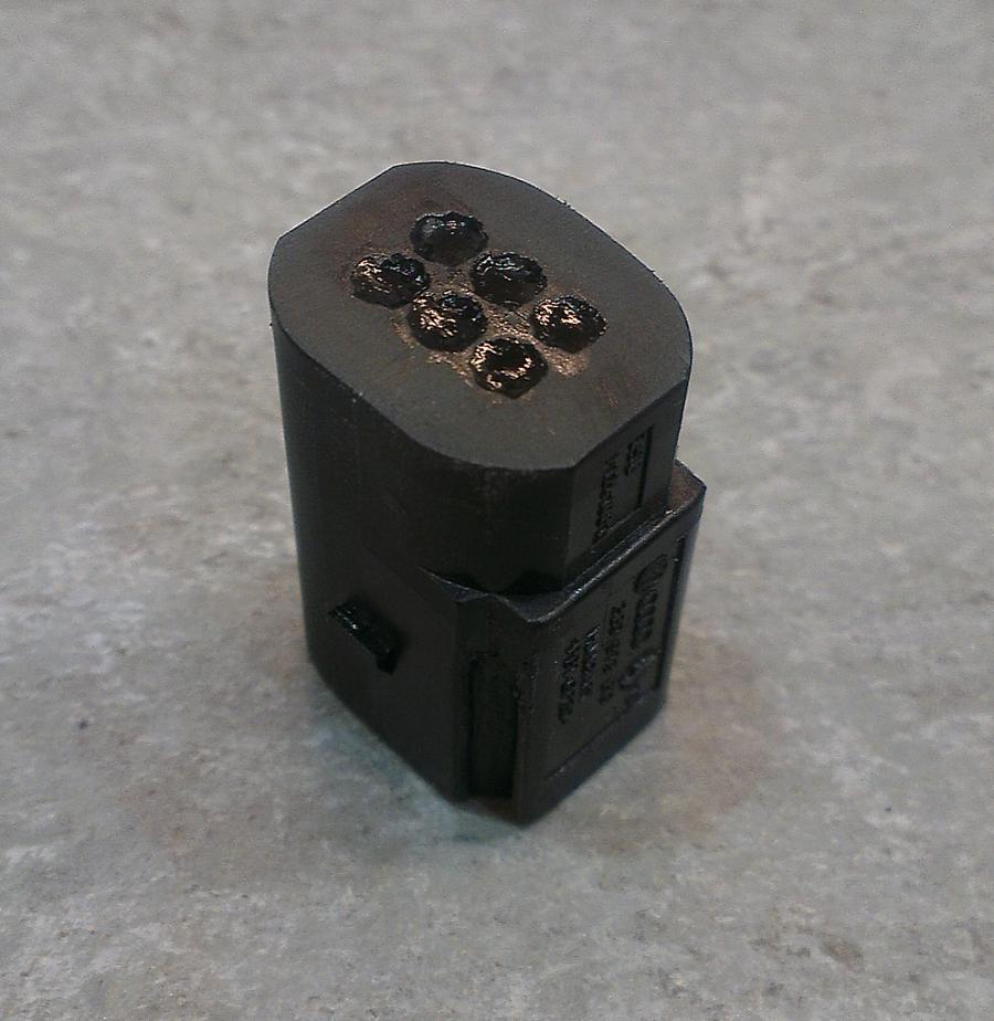

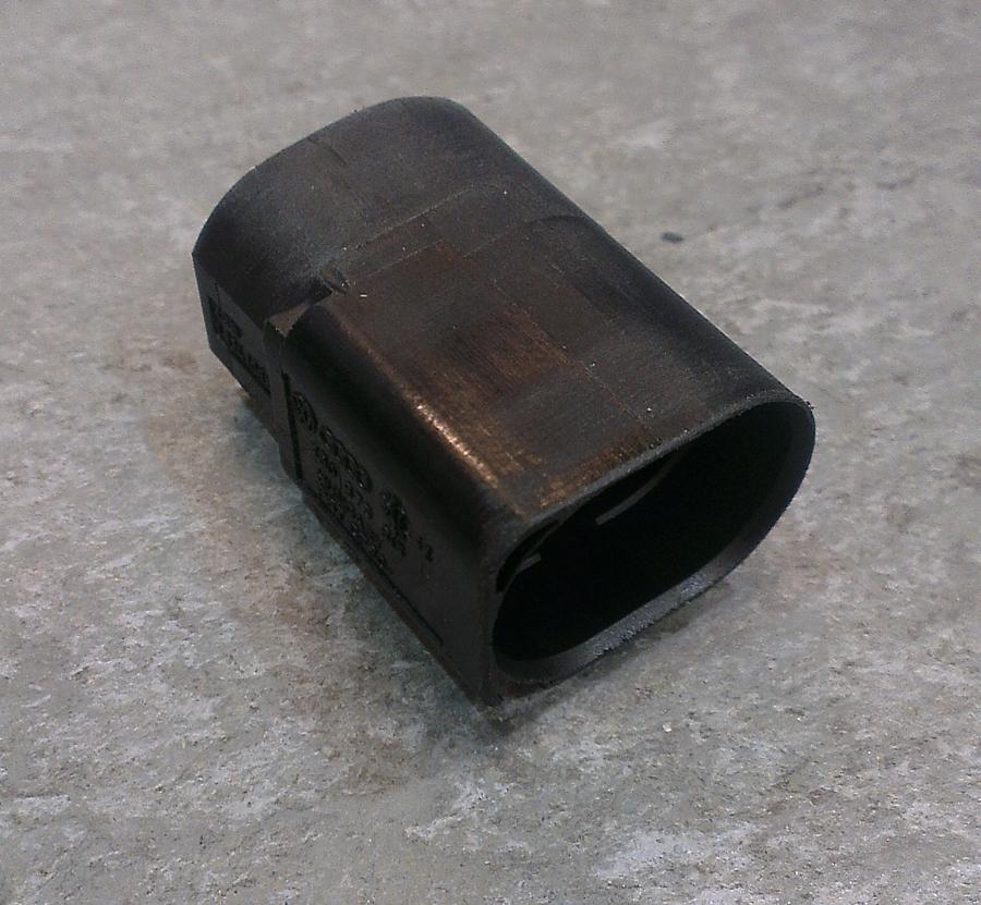

So cut a piece out to allow it to fit plus shortened it and removed the lugs.
Sealed with silicone.
