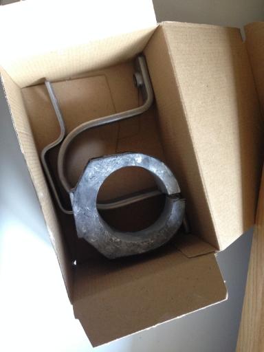

Just watched the video and it COULD be the rack bushes but i wouldn't want to replace them without a pit or ramps.

Not that I am aware. I replaced with OEM bushes, part number 1K0498884. You will need two of these. Each repair kit comes complete with the rubber bush and saddle clamps.

Can't remember exactly, I think I paid £60 for both.
I still have them if you're interested. :)
