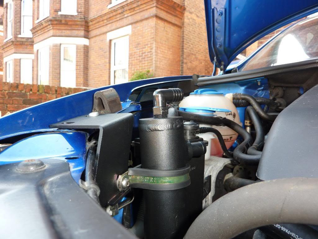

Do you know yet if you'd have to loosen the P-ring and lift it out to empty?
I will have a look later today, hopefully.
RR I have the larger can fitted, and can get to the drain quite easily to empty.

Re: PCV and the inner workings of the system on the tfsi engine
« Reply #48 on: November 12, 2009, 05:20:38 pm »
wouldnt recommend the larger catch can RR
the V shape for the 2 tube fixings means the pipes look odd when fitted.
too large for most areas to fit . the dipstick works but a sight glass is better
theres also a 90 deg bend piece for the outlet drain now (not shown in that pic)
Id stick with the smaller version (which I'm now waiting for from dubtek)

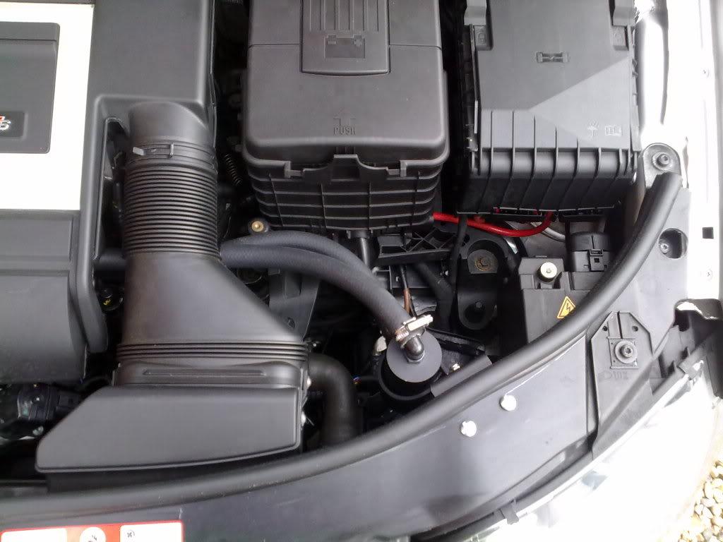

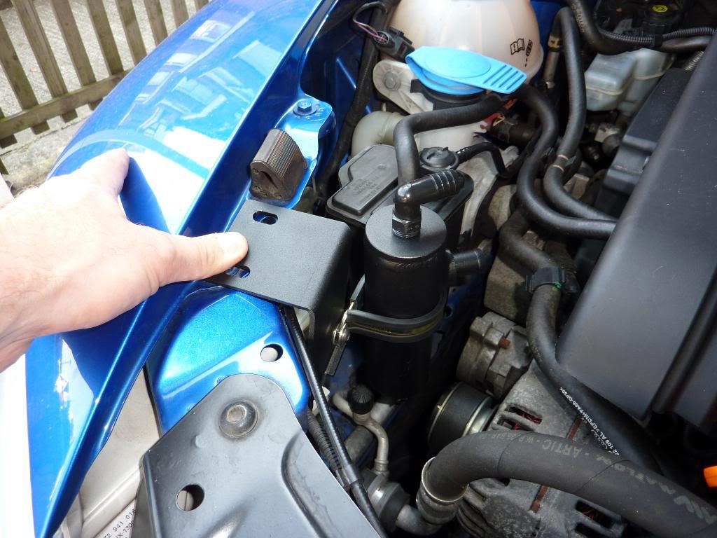

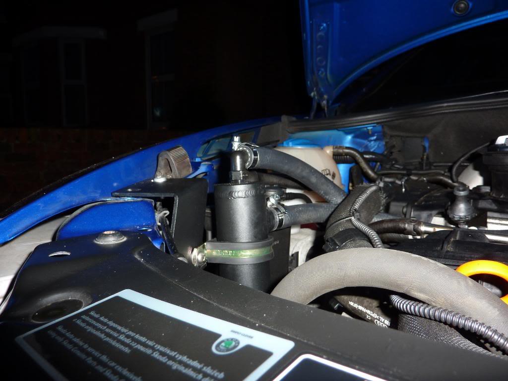

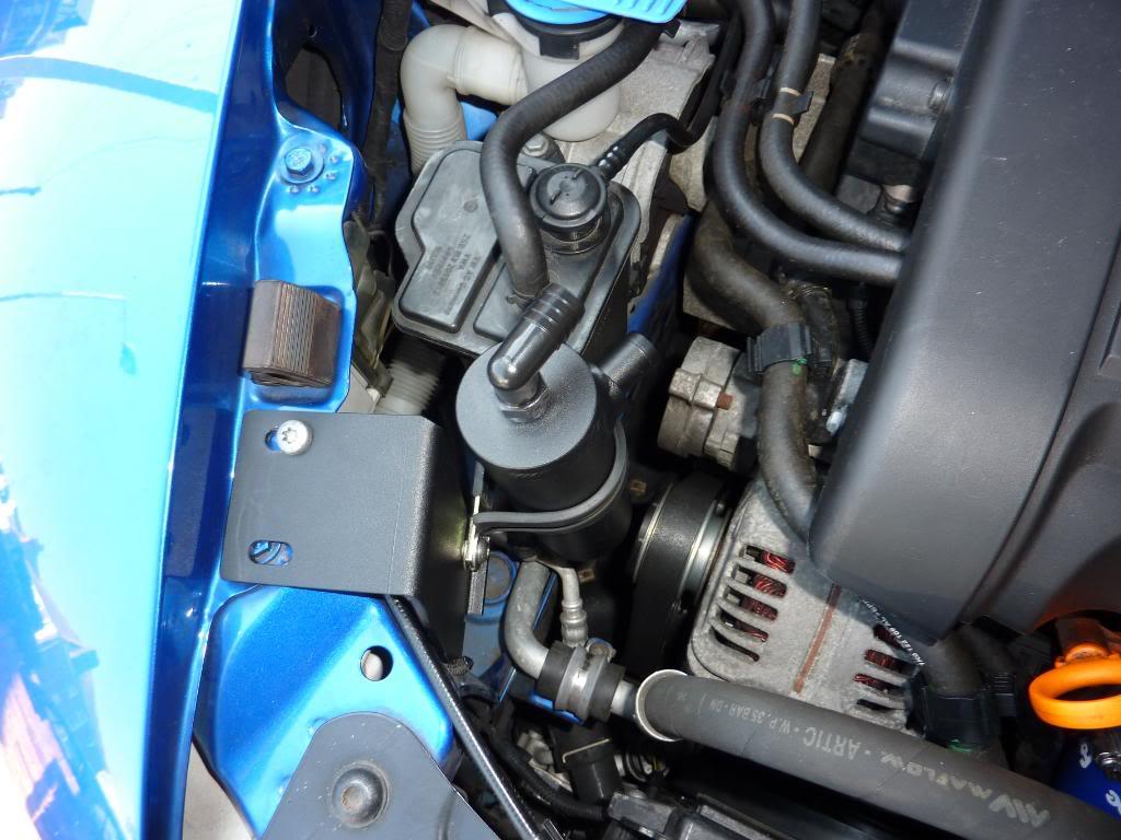

Robin, looking at pics of the twintake I wonder if you still might be able to fit the catch can in the headlight area:
I have mine in a similar position:
« Reply #54 on: November 14, 2009, 12:27:59 am »
Good idea! I could perhaps drill two holes in the slam panel and just move it along. The SS braided hoses I'm getting from Dubtek for my catch can are more flexible too - Which will help the routing.
I'm probably going to get the Forge Twintake and go OTT and run an extra air feed via a flexi-hose from the foglight panel. NeilM is also interested in doing this. Where that goes will be the deciding factor.

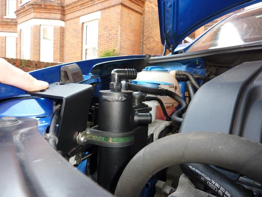

Here are some pics of the high capacity catch can fitted to my vRS:
http://www.mk5golfgti.co.uk/forum/index.php?topic=7885.15
RR, to open the drain I just wind the wingnut in.
