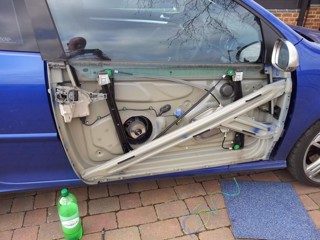

The side impact sensor it under the doorskin

Yes its under door skin mate, plus it may not be sensor wire might be nearly broke between car and door?
its the blue sensor in the middle of the door

I'd also check the wiring in the door bellows, done 2 cars now (mk5 golf and an Octavia vrs) that had airbag lights on with the side crash sensor showing as the cause in VCDS, both were due to broken wiring within the door to body loom  :happy2:

its only ever going to be in the rubber bellows, so i'd just patch new cables in between say 8 inches in the door and the plug, solder it all up job done, no need for new loom mate

You need to remove both really, door card off to drill out rivits then skin off to get to either the wires or sensor
