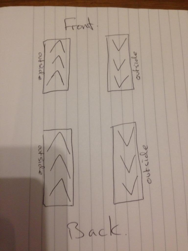

Hey guys,
I bought 4 brand new Uniroyal Rainsport 3 couple of months back and had them fitted at a garage.
I noticed that they have a very distinctive tread pattern and have looked on the internet at the direction they should be facing.
On the left hand side of the car they seem to be facing the right way so that the water would be taken away to the edges should it go over water. Yet on the right hand side of the car the edges would take the water to the middle of the tyre. Basically the right hand side is facing the opposite way to the left.
However all 4 tyres say 'outside' on them and the word 'outside' is facing the outside on all of them. I'm getting confused even just writing this.
How has this happened? Surely they should all be facing the correct direction? If I bought 4 identical tyres and they all said 'outside' on the same side then 2 are always going to be backwards?
SORRY ABOUT THE DRAWING LOL
Craigh

« Reply #2 on: March 09, 2014, 07:09:26 pm »
I think a photo will be required  :grin:
Photo added :)

So mine would be classed as directional. So in that case you would have to buy 2 left hand side tyres and 2 right hand side tyres?
However if you buy 4 identical ones then you would have to put 2 of them that say 'outside' actually on the inside.
This is hurting my head lol It just doesn't make sense that they would all say outside on the same side as each other or two of them will always be the wrong direction  :confused:
No.. From what I can tell from your OP, the tyres are asymmetric and so are fine  :happy2:

So from your pic Ed (which are the Uniroyal rainsport 3's) the right hand one of them is dragging water to the middle of the tyre. Why would one side be different?
