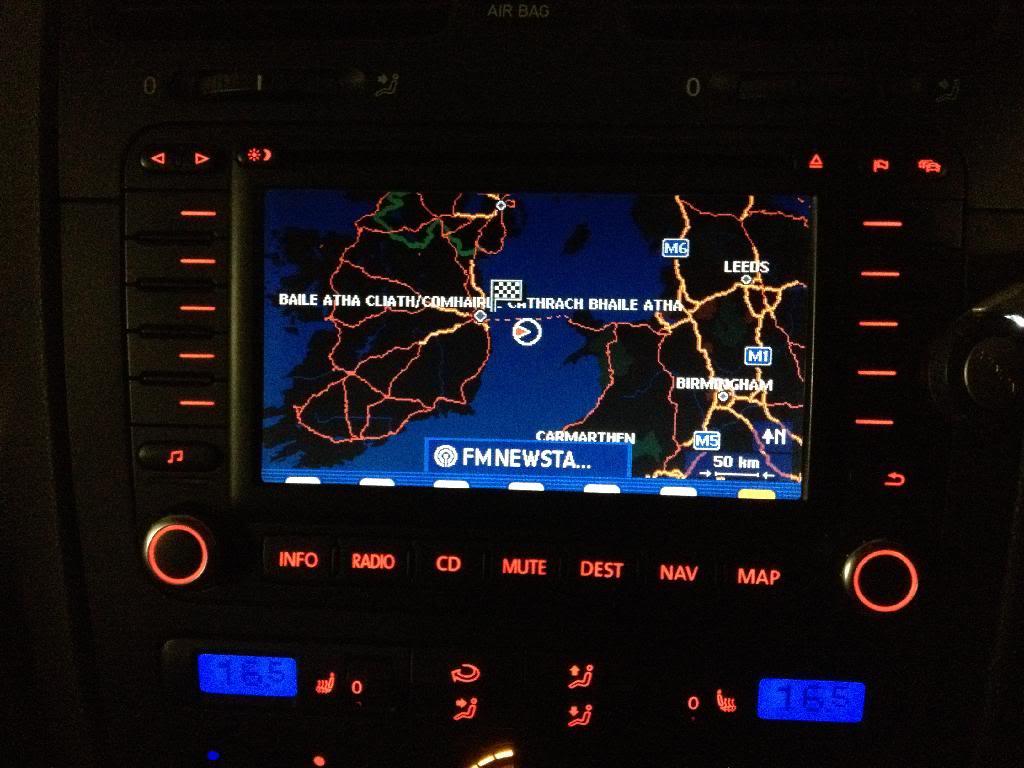

I'm having a similar issue - GPS was working fine originally with the car (we are the 3rd owner). However it now shows us we're driving in the sea :)
Where is the GPS antenna/puck located ? so I can see about replacing it, or even making sure its connected still
