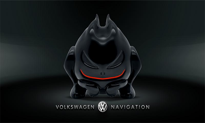

Hi All,
Just curious to see what Boot Screens you guys are running.
Ive seen these on Fleabay for £15 which is ridiculous  :fighting: seeing that it only takes 30 seconds to do.
Here my new one for today

That is class looking!
How do do you go about addng this screen?

This website has a catalogue of images: http://netdata.be/iso/?old=vw
Download or save the image you like, use the website to create an 'ISO' and then I would recommend using CDburnerXp to burn the ISO to a CD.
Link: http://cdburnerxp.se/en/home
Select ISO and use Track at Once to burn the CD.
The whole process takes 3 minutes.
Go to your VeeeeeW, do not put the key in your ignition.
Power up your RNS and insert the disc, after a few moments and some blank screens it will load the file 'Job done'
Alternatively you will need to press Eject - Star or i (depending on unit) and Setup at the same time. This will put the RNS into Firmware mode .
After a few moments you will be prompted to insert the CD.
Happy Days
