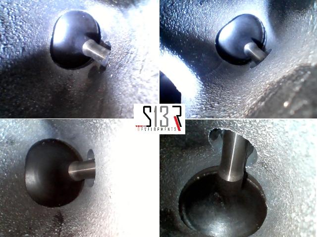

Below are bore pics of my most recent blow-by using equal parts solution of white spirits, pump fuel(petrol), and either NAPHTHA or xylol(xylene).
Before:
After:

thanks for your input. So you have removed the worst of the deposits using this method ? Or are you using your cleaning mixture to keep it clean ? or both ? I'm a little wary about doing it this way on a high miles engine (like mine, 110k miles) as the carbon buildup is likely to be significant.  I'll probably get mine cleaned manually and then use your method to keep it clean(er). How often do you do it ? Has it affected your cat ? Or do you fix that by an Italian tune-up ? :driver:
Your boroscope looks like mine, cheap China one ? Did you go through the spark plug hole to get those pictures?
I have never done a manual clean out on it. I do my blow-by method with my solution every 10k miles in order to keep it free flowing...and I started doing this at about 60k miles and have 115k miles now. I had a cat up to 100k miles, but now it is catless. I didn't have any problems with the cat...I only removed it because I wanted to run less expensive 100 octane low-lead fuel($5usd/gal) versus the 101 octane unleaded($16usd/gal) we have available. Yes...my bore-scope is a cheap Chinese Supereyes type...and I went through the IAT location as I do for the blow-by process.  :drinking:

I see, 'scope through IAT, more direct than going via the spark plug, good idea.

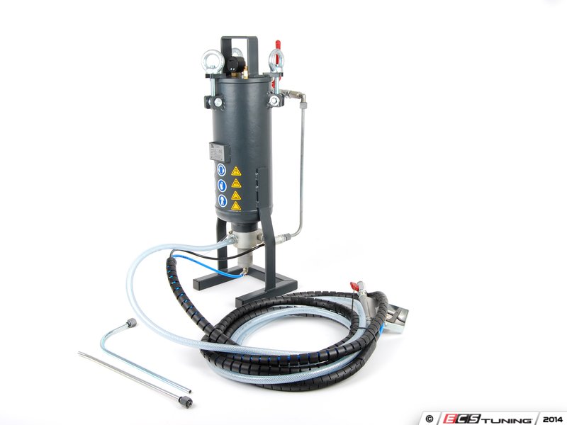

Recognised as an issue by BMW, they've issued all the dealers with a Strahlmittelgeraet - BMW part number 81292208034.
Looks like this :
http://www.ecstuning.com/BMW-E90-335Xi-N54_3.0l/Search/Tools/ES2101847/
Costs about €900.
I haven't found any one local to me that specialises in this service yet.
AKS - you getting a Strahlmittelgeraet  soon ?

Media blasting does produce very clean results, but the problem with all of the elaborate or expensive methods is that you will have to repeat. That is why I just do the blow-by religiously.
