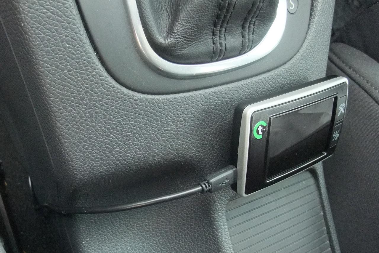

^ No holes drilled - The wiring is tucked in the flexible plastic sides of the console ^
Mine is hardwired to be automatically active on ignition - Yet another startup beep!
Please note that if you hardwire by keeping the supplied 12v male insert and not cutting it off (sensible to keep for the future), then make sure it's deeply set into the female socket and also taped up well. If not, power can get cut off to the TyreSure display, as happened to me.

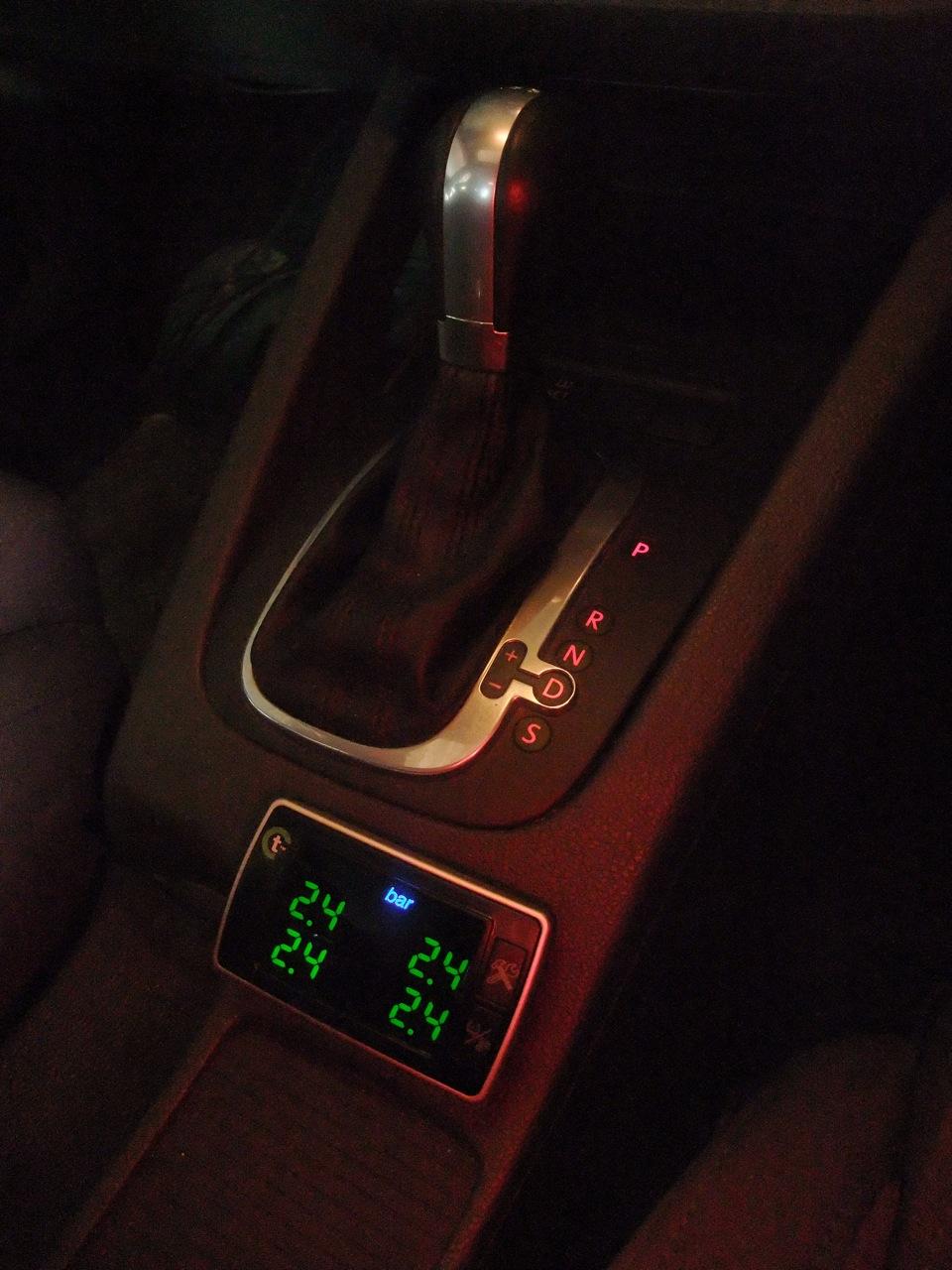

Note that the display looks very bright while driving at night and so this may limit where you locate the unit. Mine is hidden from view by my forearm while driving (always both hands on the wheel at 'quarter-to-three' position but I just lift my elbow and can then see the displayed values very easily.

....Regarding 'visibility'/security, the display unit can be attached using velcro and so can be easily unplugged and removed.
Regarding positioning, there are several places it could be attached by using velcro. One position I considered was in the bottom of the rev counter as you don't need to see the needle register less than 500 revs and neither does it max out (or you've then got other more pressing problems!). Surprisingly it almost looked oem because the thin aluminium surround matches the oem dials. But I decided that the lit display would be too strong.
Consequently I have positioned it next to the handbrake - Yes, I have to look down but a very quick glance is all that's needed and not often (until I am used to it!). I would not wish to alter settings while in motion.
How do you find using it in practice? Especially given that it's not within your normal field of vision so you have to turn your head? This is the main thing I don't like about the rns - I have to take my eyes off the road for too long to see where I'm supposed to go next.

I went for the position below the rev counter as i found it too distracting in the previous place (In the ash tray)
At night i diddnt find the display too bright so thats were it stayed.  I also chose not to hardwire the system in, with a little positioning the wire was hidden from view so this ment that when leaving the car anywhere i could store the unit in the glove box.
