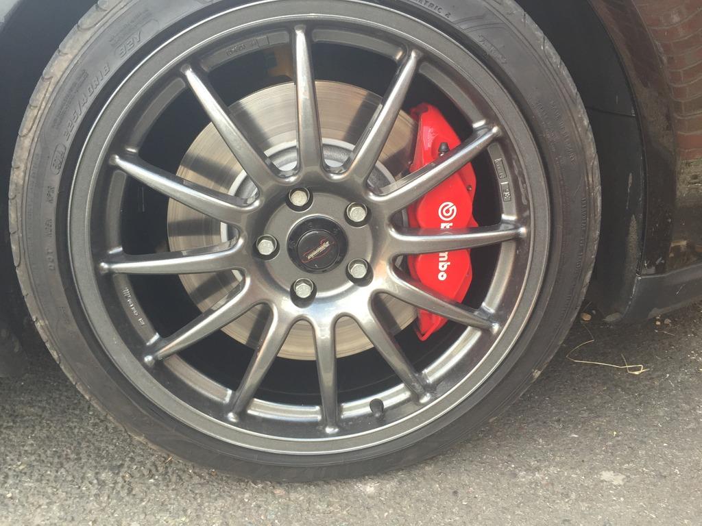

« Reply #90 on: July 22, 2015, 11:29:17 am »
Brakes are looking very good  :happy2:
TTRS brakes are defiantly a good mod to do, and they look great.

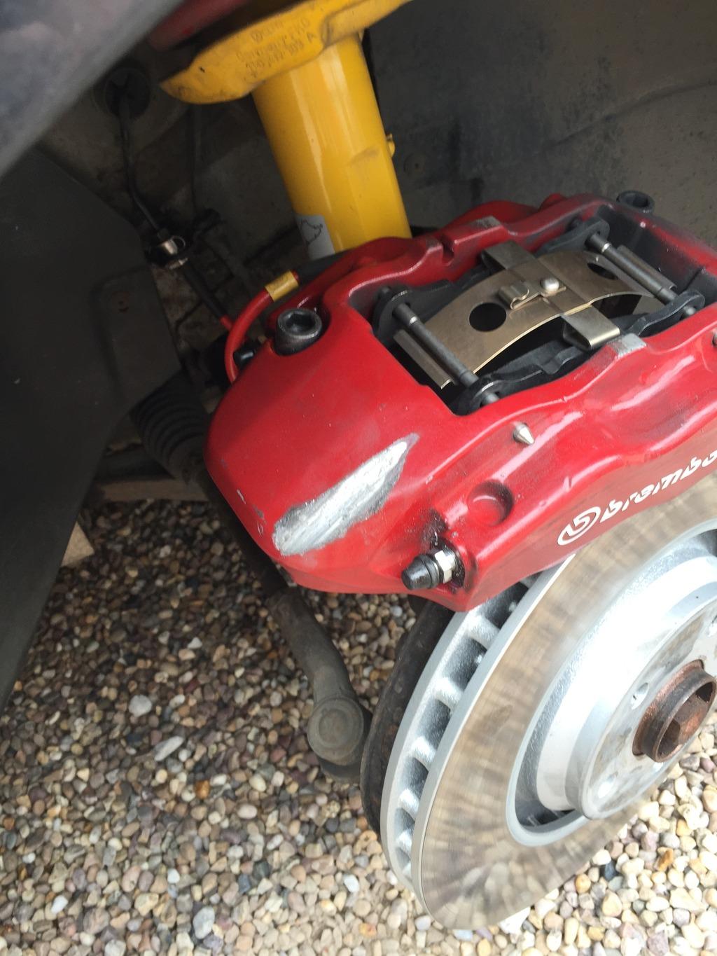

So after being on my car nearly a whole 24 hours the brakes have had to come off again. The garage that fitted them have employed a total knobhead who forgot to check the tightness of the bolts he used to attach the calipers to the car.
On my way to work this morning I heard a bit of a noise whilst driving along the A38, as l went to slow for my junction there was a horiffic grating noise and the car pulled violently to the left. I managed to control the car and found a suitable place to stop. On examining the car, the caliper on the drivers side was hanging on by the lower bolt only!

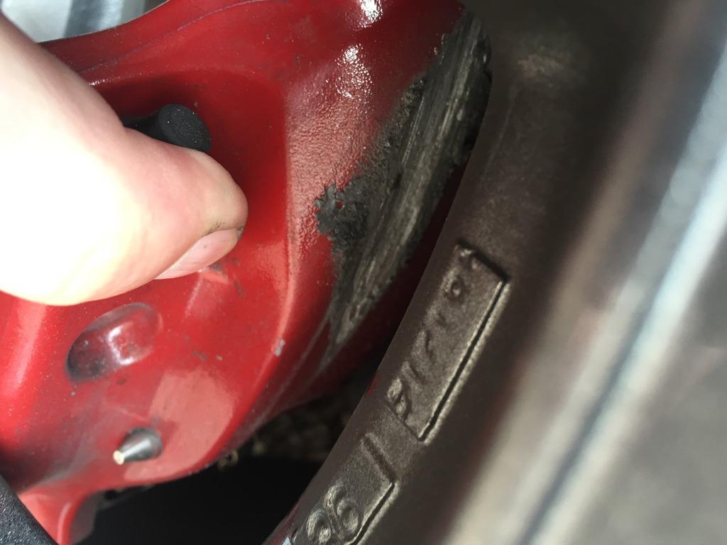

Caliper damaged by rubbing on wheel:
Better picture:
All in all Im not happy. Caliper is screwed, and the wheel will need a refurb too. Gutted as lve only had them a month or so.

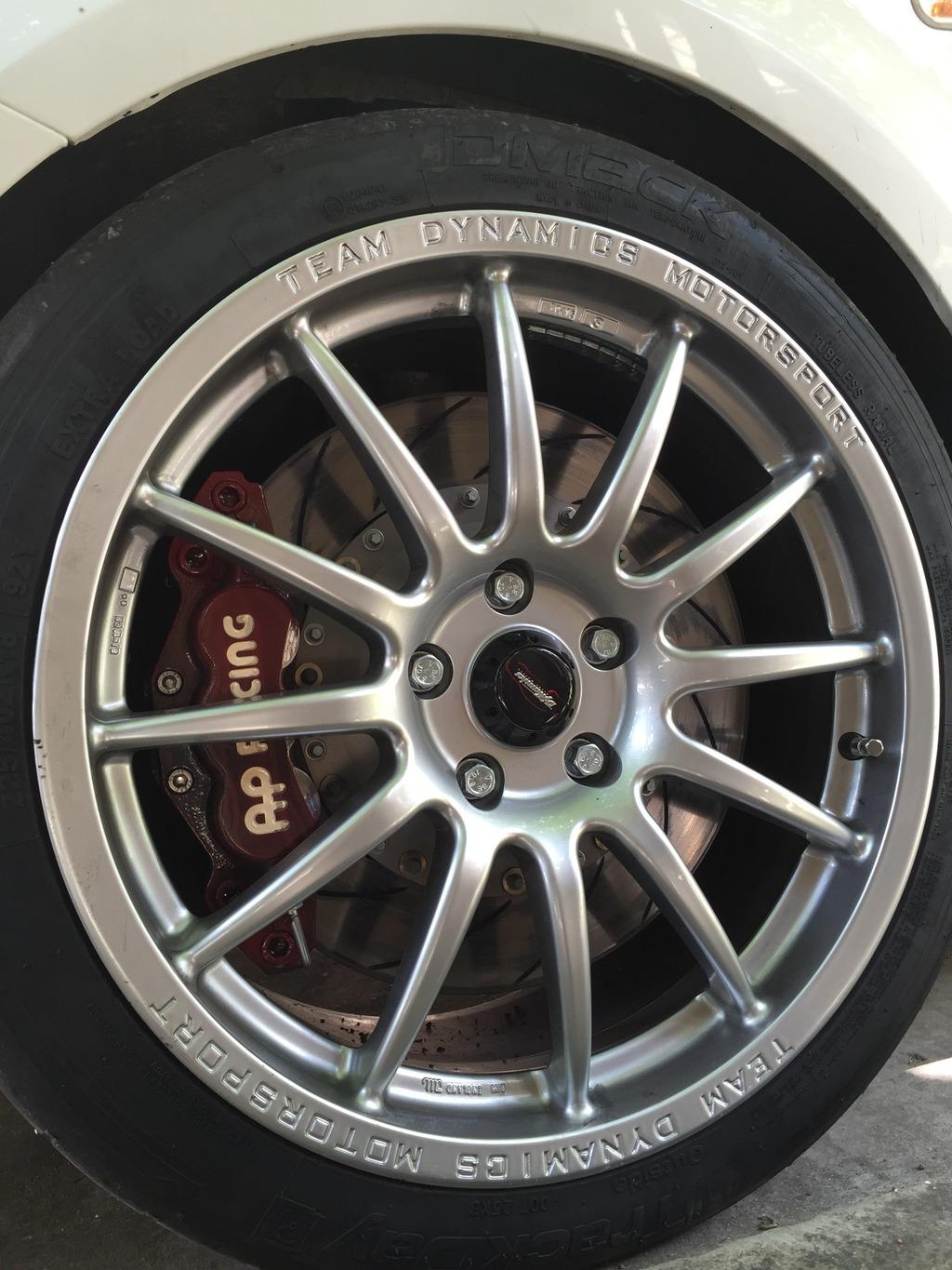

I had somewhat a similar experience with my new AP Racing BBK, the mechanic did not center it properly so that the pad was in continuous contact with the disk.
Went to a trackday and this is the result:
Cooked calipers. I've asked him if he had used the centering washers from AP Racing, he told me there was no need as the calipers centered perfectly.

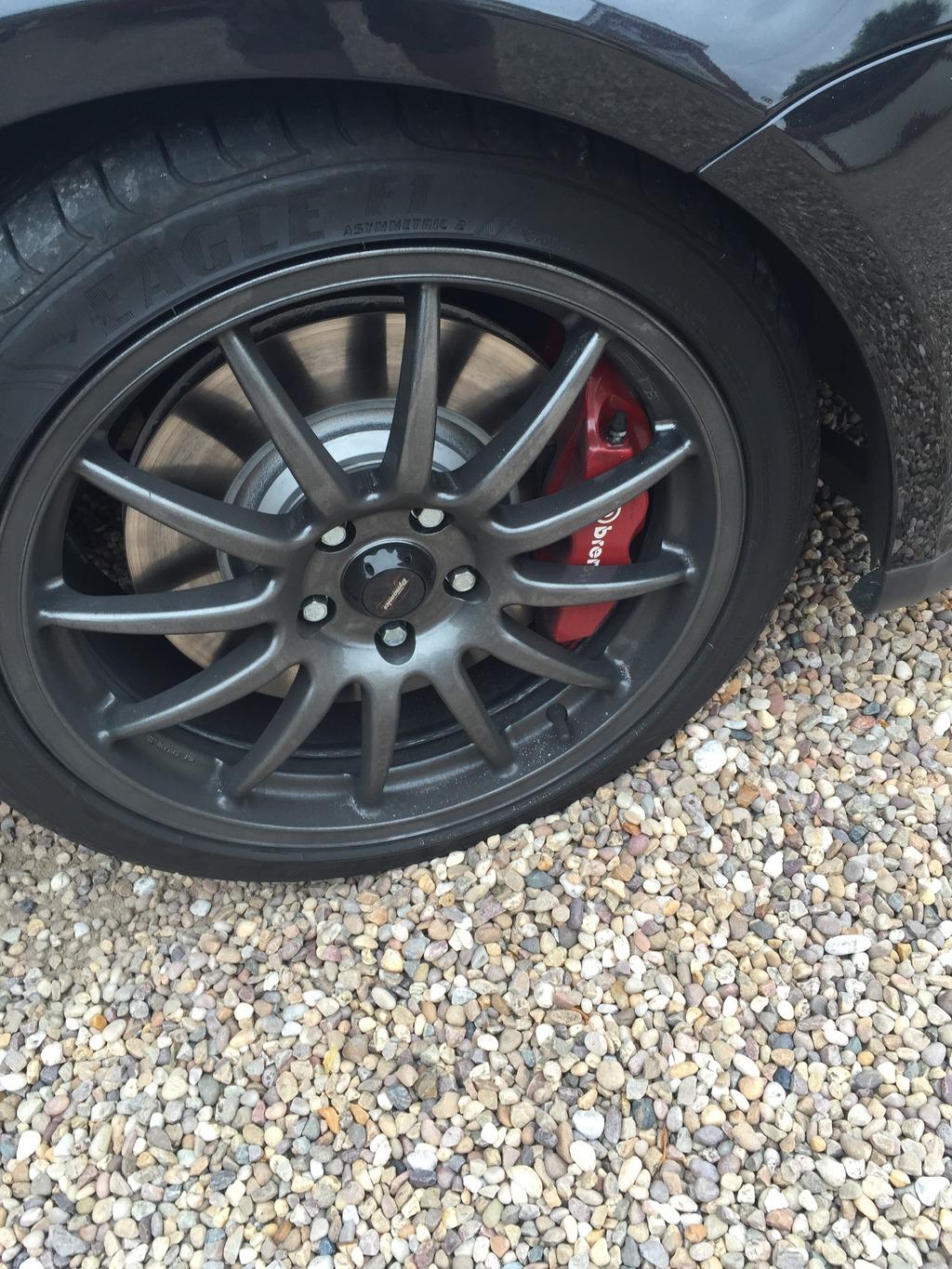

So I returned from Cornwall suitably relaxed and sunburned to find my car waiting outside my house. As I didn't get home until late I didn't have a chance to properly inspect the car, but it looked good in the fading light. Got up this morning and had a proper butchers. Initial thoughts are good. Wheel looks 100%, and the brakes aren't too bad either.
Only slight gripe is that the colour isn't quite the same as the previous calipers. Old ones were a more 'cherry red' compared to these being more of a Tornado Red, but I don't mind that too much.
