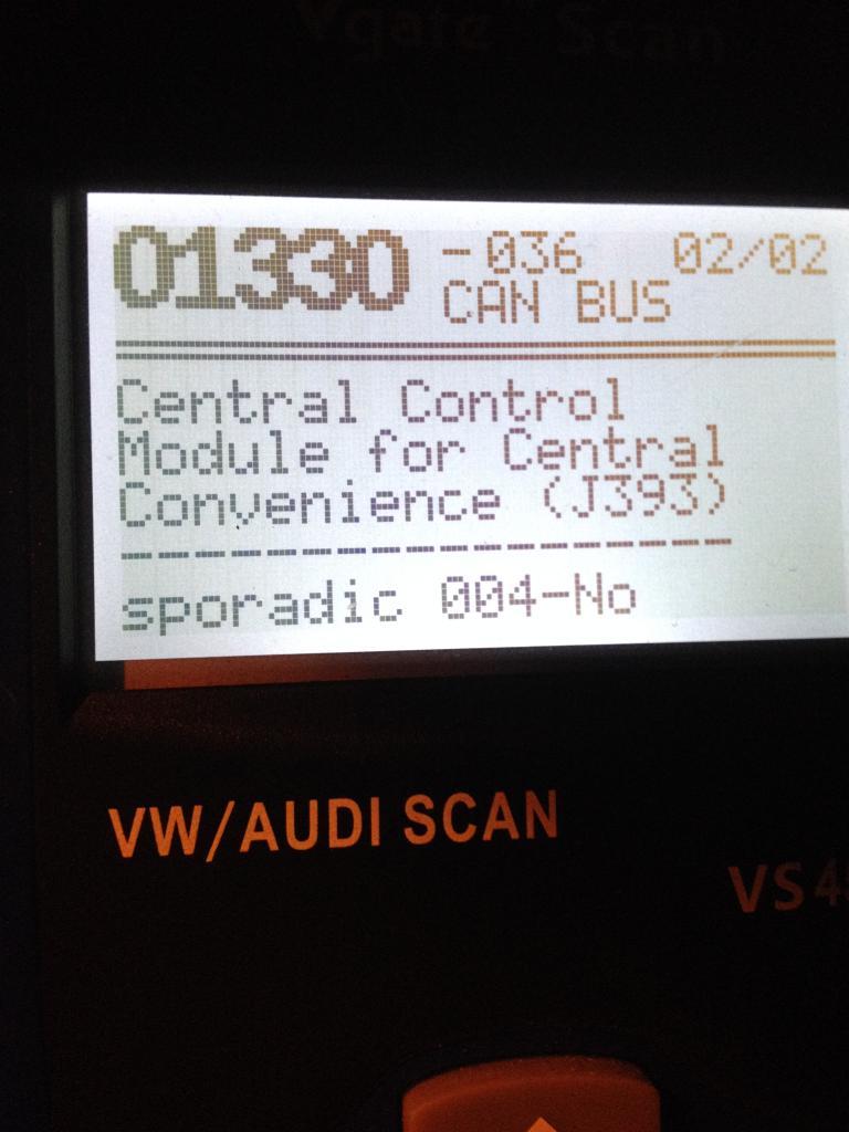

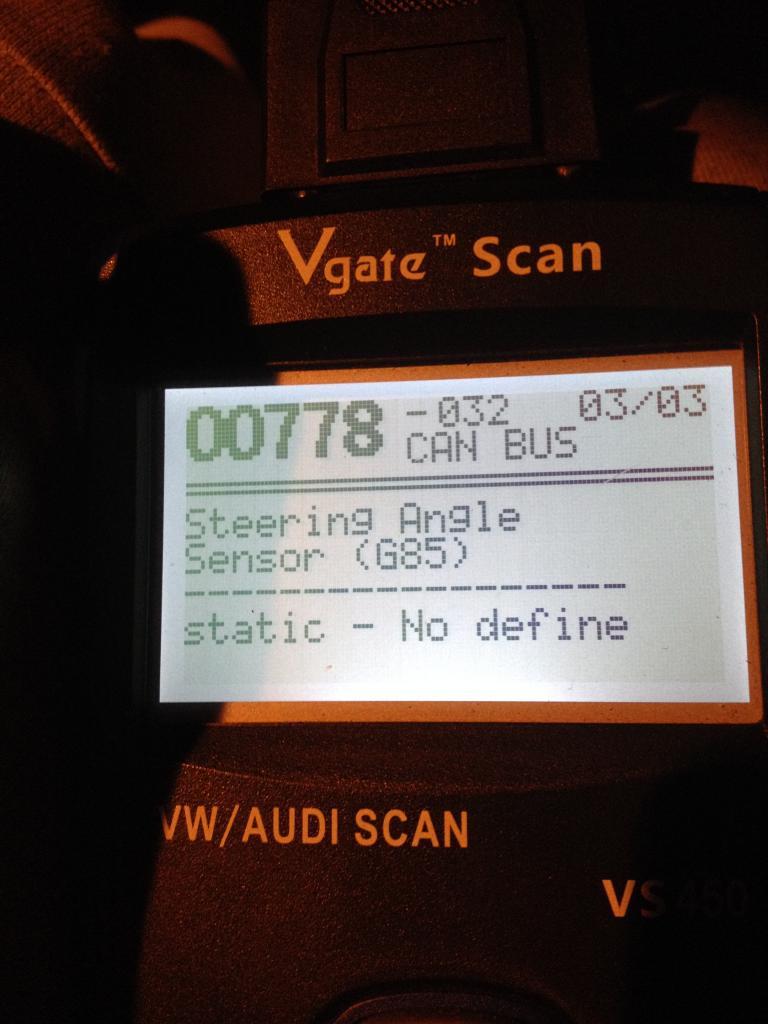

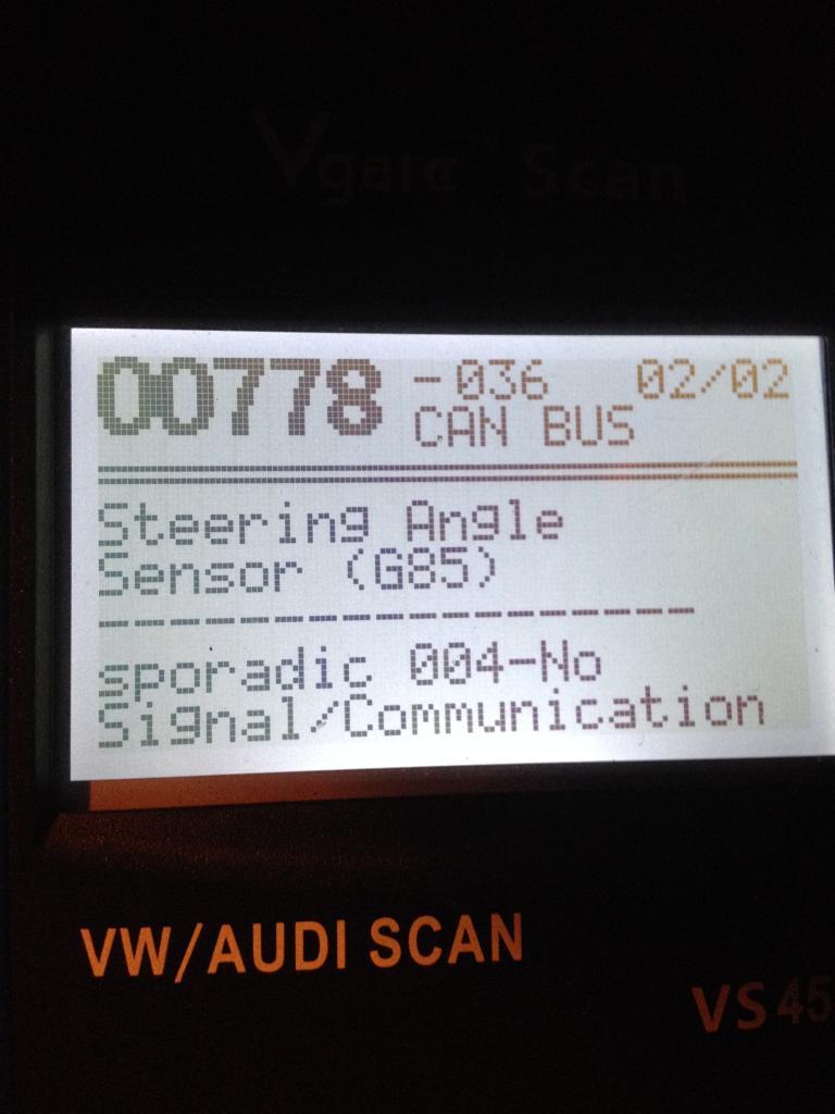

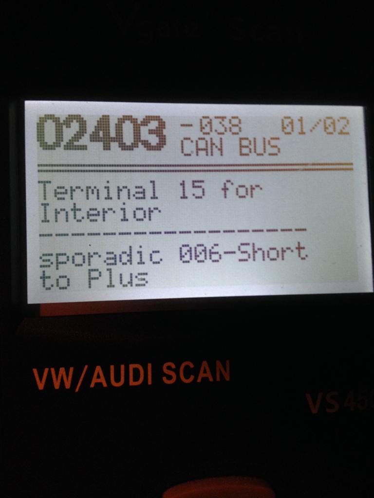

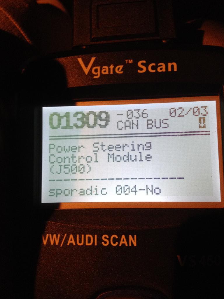

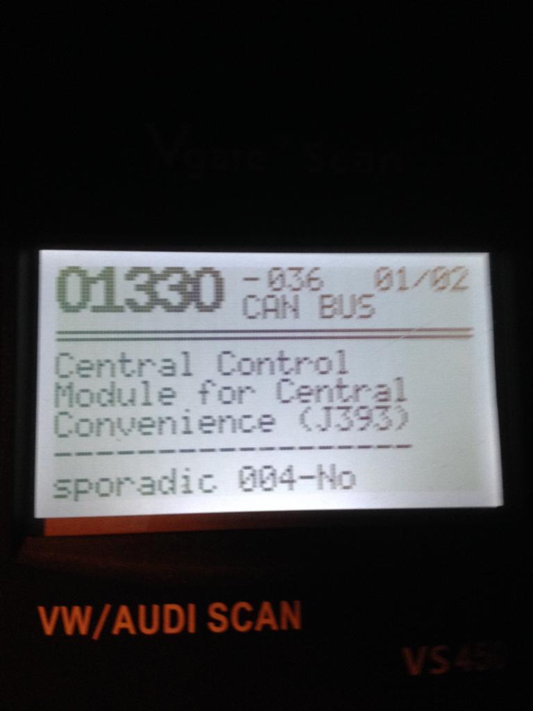

been having a hard drive about with some mates and my sub is lose in the back still..been fine starting the car and stopping then came home went to switch ignition off and the engine stayed on and i could still drive the car!!! what the hell right!! only way to stop it was to stall it ..
my earth wire had come out but with the keys out off the ignition and the engine stalled and a locked car, if i touched the earth wire to the sub it got power..:/

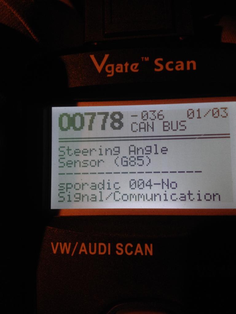

so screwed that back in...got my mates fault code reader and its pulled up a few codes :/
car is running fine now and starts and stops but still with these codes..well untill i drive it tomorrow and get the code reader back

must be leaving an open circuit somewhere. perhaps the head unit is feeding into the switched live somehow feeding back 12 v into the ignition circuit. depends on how you wired it up.
