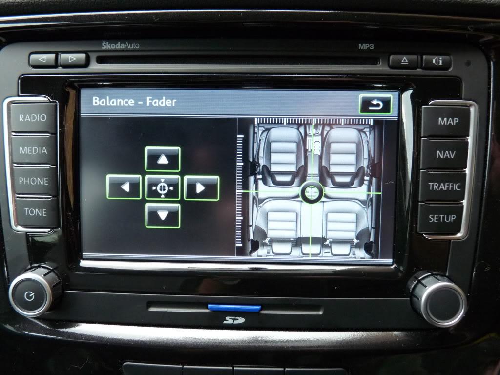

how do I adjust the speaker fader on the RNS510 rev C.
I can get to the screen where it shows the bass, treble, and fader but cant seem to adjust it  :stupid:

Press the "Tone" button on the left hand side, and it brings up the menu for bass, treble, etc.
Second setting down on the list (touchscreen) is for balance and fader. Select this, and it brings up a picture of four car seats with a target cursor centred over it, and 4 cursor keys to the left. Either use the cursor keys to move to target on the seat pictorial, or use the target itself. Touch screen control.
Edit: Pinched a pic from google....

Thanks mate  :happy2: still can't get my aux to work through both left and right speakers, only plays through one side not both :sad1:

I can access it, I moved the curser around to bang in the centre of the car (pictured on the RNS) didn't make any difference  :sad1:
