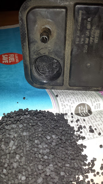

Thanks to this thread I've just replaced my evap cannister and hose and it seems to have fixed my long running P0441 fault code.
Mine would come up virtually every day and I'd reset it with my code reader only for it to come up again.  Even if it didn't set the engine check light it would show as a pending fault with the code reader.  I tested the valve with Vag Com and this always passed so after reading loads of threads including this one decided to splash out.
The new can was P/N 1KO 201 801 E (old one ended in D) and the new hose they recommended was 1KO 201 160 BG (old one looked the same).  Takes about 10 minutes to swap over both, nice and easy.
In case you ever wondered what they look like inside its just a load of charcoal balls with a membrane of some sort across the top.  On my old one if I tapped the membrane loads of charcoal dust came through but with the new one nothing.  Fingers crossed its done for good now.
In the photo I just nudged the membrane out of the way, it isn't attached to anything.
P.s. I paid £67.70 for the cannister and £9.90 for the hose - both prices not inc vat.
