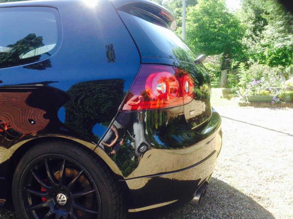

While i have seen excellent results from machine polishing, particularly in jays detailing guide, i often ask the question is it really miles apart from doing everything by hand? Albeit by hand is a lot more time consuming and hard work. In terms of removing swirl marks i presume the machine will do a much better job than the hand?
Heres a pic of my passenger side which i done the other day. It was de tared, washed, clayed, washed followed by autoglym super resin polish and sealed with two coats of meguiars carnauba wax. I was quite happy with the shine i got and i did manage to remove a few swirl marks that were on the quarter panel. It was tough work though.
Can people post a few pics of the results they got from machine polishing? And do many on here do it all by hand? Reason im asking is im considering getting a machine polisher myself but im so used to doing cars by hand im kind of stuck in my ways  :signLOL:

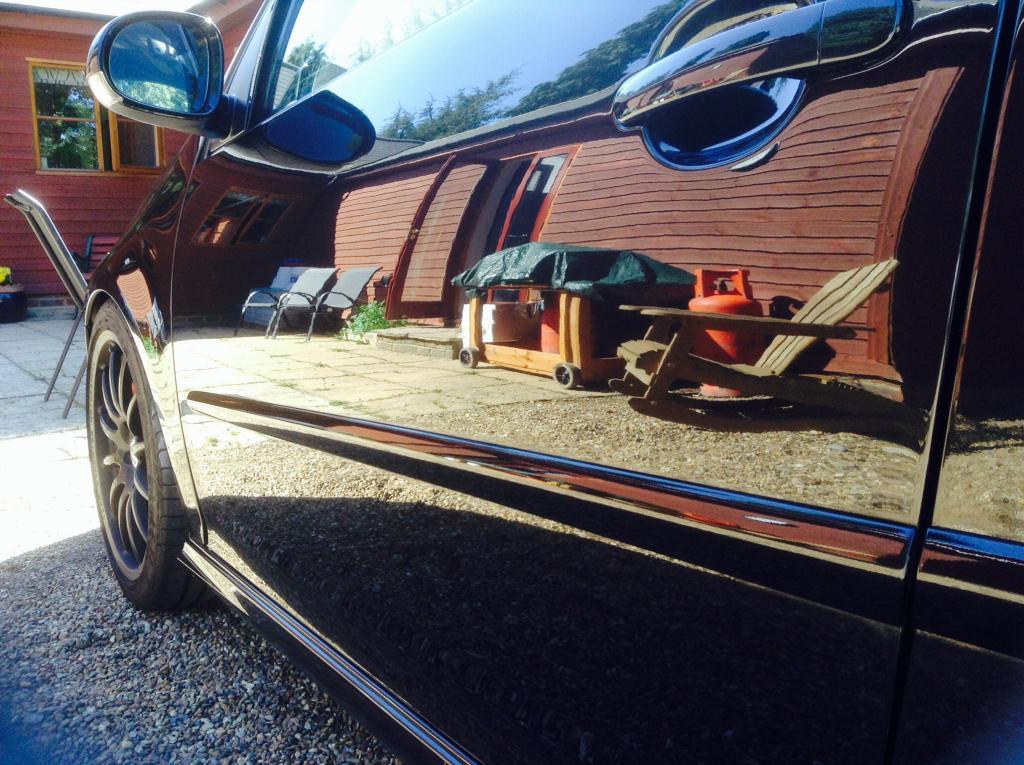

What you've got to think though mate is using SRP only fills the swirl marks in.  In a month or two time you'll need to do it again as it would of washed out and the exact same swirls would be visible again.  If you tried using a cutting compound such as Menzerna FG400 (which I'm currently using on my machine polisher) it would take you hours and hours just to do a tiny little bit, especially with German paint as it's really tough.  Whereas SRP fills the swirl marks, a cutting compound removes a very fine layer of the top coat thus getting rid of the swirl marks all together.  The only way they would reappear is if the car isn't washed correctly and more swirl marks are caused.
As you can see using SRP does get you some amazing results by hand and I actually used it before I started machine polishing.  I'd highly recommend getting a DA and giving it a go.  Once you've done it once you shouldn't really need to do it again as long as you give it a safe wash everytime and be careful of contaminates.
As Rich said photos don't mean too much but I thought I'd post these anyway.  All in all it's taken me 5 hours to do that side of the car and the bootlid.  This is doing 4 passes with the cutting compound, 3 passes with a finishing polish and 1 layer of Collinite.

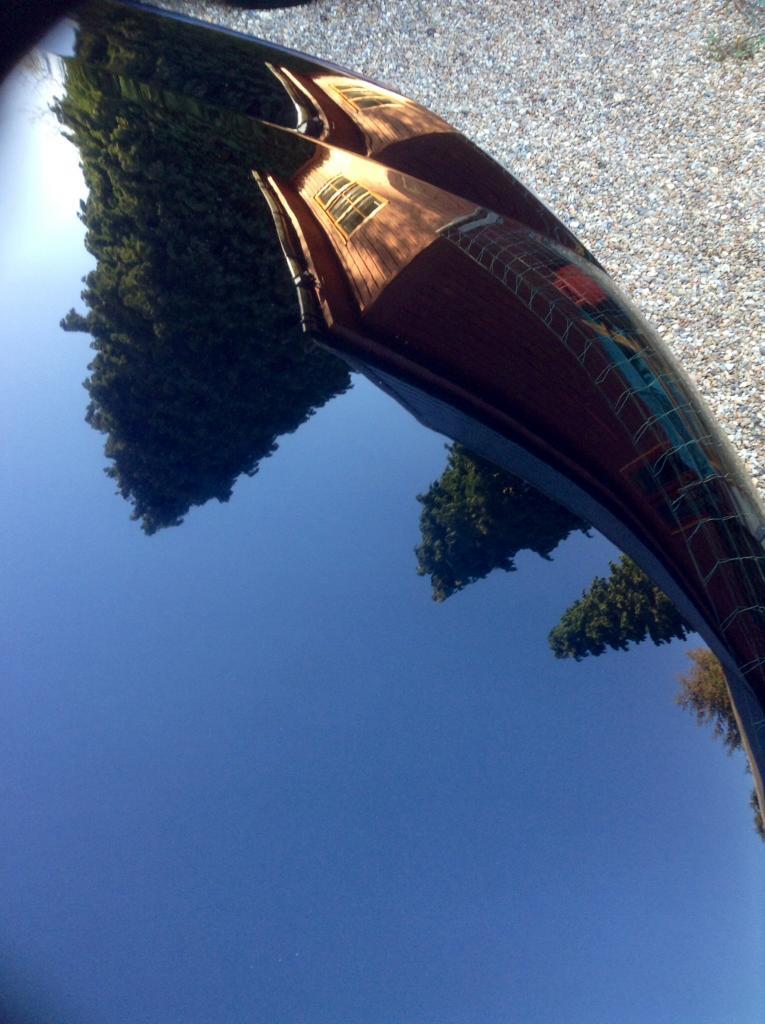

im no expert either but this is the results on my black Eddy
havent took any recent shots, these are about 6-8 weeks old  :P

That bonnet shot  :surprised: Black really is the colour to drool at with a shine lol those are some excellent results! How long did you find the shine to last for after a few washes?
Lasts a good few 3-4 washes mate  to be fair though I really keep on top of it lately, washing her at least once a week and claying every 2 weeks. Washing correctly and not putting swirls in the paint is key

I wouldn't bother hand polishing, glazing by hand is fine but hand polishing, you simply cannot get an even coverage of pressure, effort and product. Machines work far faster and they are consistent so you can get a consistent result. I have seen horrible hazes from hand polishing especially if you're using polishes which have a long work time and take a long time to break down into their finer "finishing" particulate sizes.
A light source shows a million things... this is not a dig at anyone in particular, I'm just purely trying to educate people. you need a fixed light source on a panel in a position to highlight swirls, scratches etc. A side on shot shows nothing especially on a black car... LITERALLY none the wiser - amazing what a light source shows...
