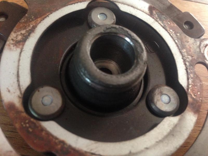

What happened was the splines on the shearplate became rounded off, so it stopped engaging with the compressor shaft. The compressor itself was fine.
From underneath the car, remove four T27 torx screws from the shear plate (no need to slacken the aux. belt, remove tension or anything like that, it is all done in situ in 10 minutes), then pry the old plate off.
Once off you will see if the centre has rounded. If the stub has sheared off then your compressor will have seized.
It is worth doing this just to check before purchasing anyway.
I put the replacement plate on and immediately I had cold air.
I can only imagine how many compressors and other bits have been swapped out over this.
Here is a pic of the old plate

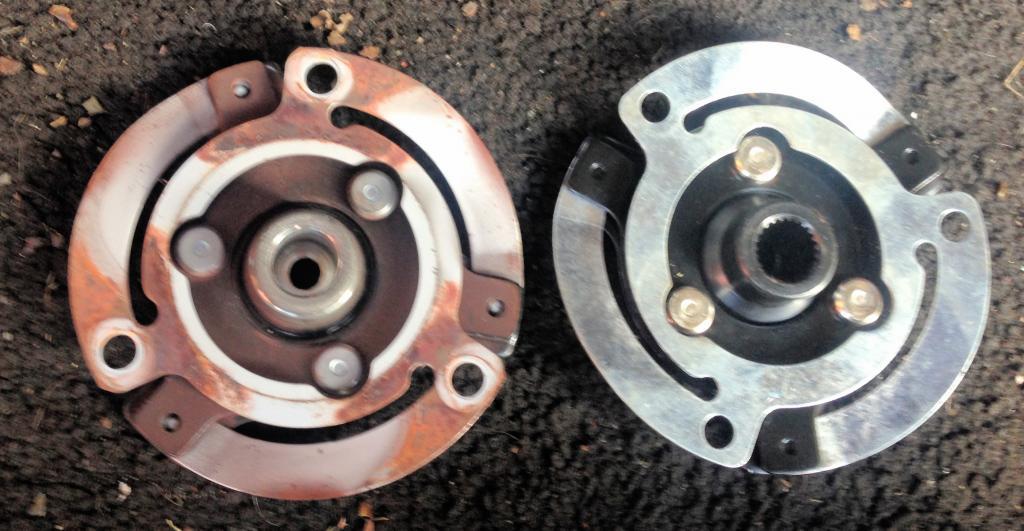

And here is a side by side with the new one
I got the new plate from ebay.de as it is an aftermarket part.

« Reply #5 on: August 10, 2014, 12:42:42 pm »
How can the splines just wear away like they're made of chocolate or something?
Offline skard
  • -Receive: 245
  • Posts: 2674
Re: Broken Delphi aircon compressor? Possible fix.
« Reply #6 on: August 10, 2014, 01:00:42 pm »
The original must be a softer metal than the compressor shaft, as that had no rounding of the splines.
