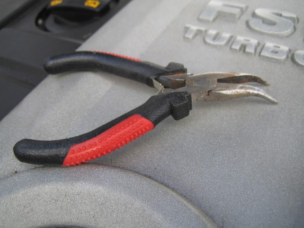

Had another go this mrning and managed to get them both out in a few minutes with a mini long nose pliers. (Needs to have a snipe or angle though to reach inside)

The Pliers I used:

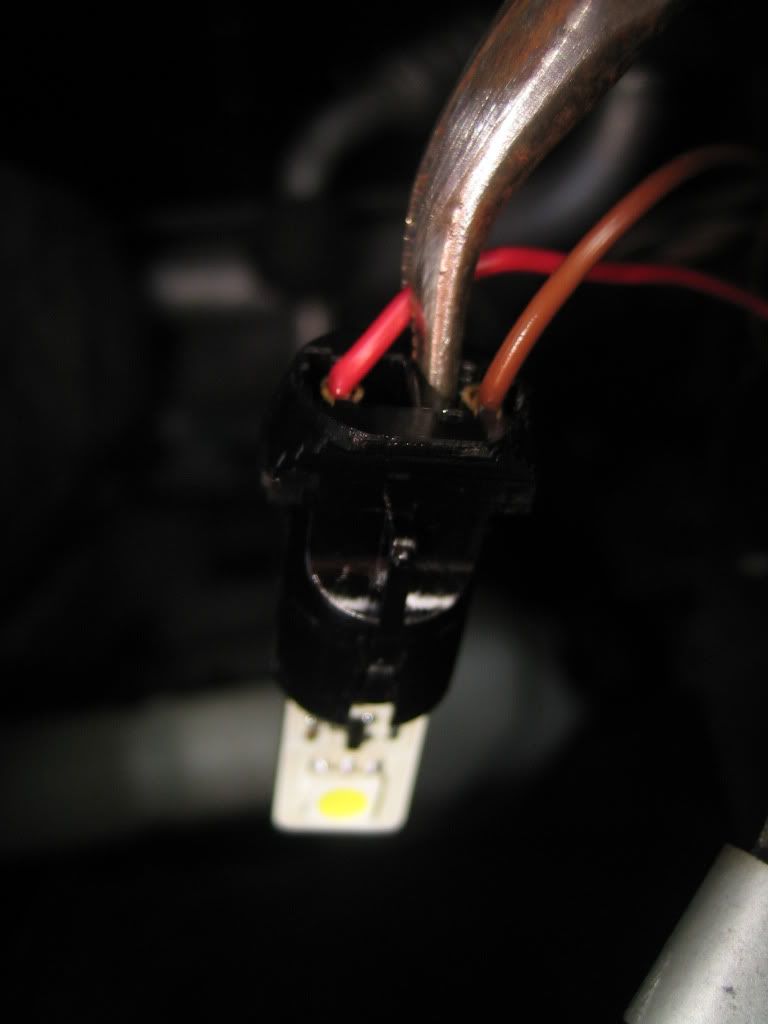

Where to grip the bulbholder, and pull straight back (do not pull the the wires)
