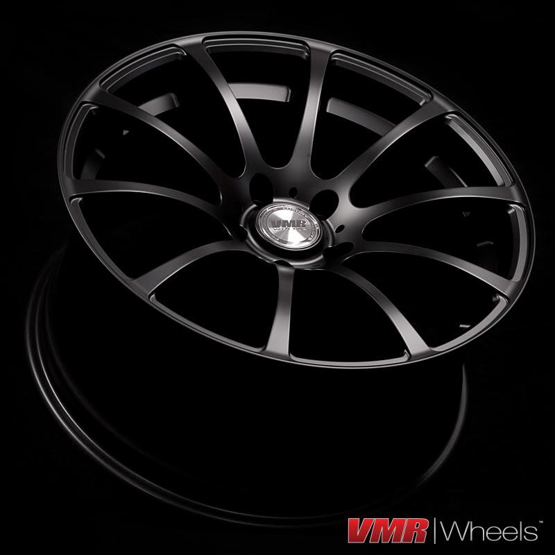

I really love these  VMR V701 Straight spokes in matt black  :drool: :drool: :drool:
Would I be correct in thinkin the offset would have a low ETnumber on these beemer wheels? I love the look of the spokes sinking in quite deep into the centre. :wink:

^^^ Yes they will be a much lower ET on the BMW, so the same wheel in a Golf friendly fitment won't have the same depth into the centre  :sad1:
