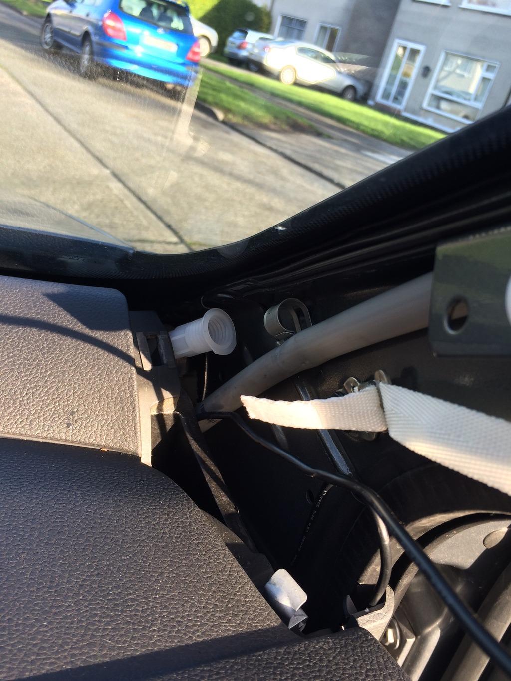

Happened to mine too. I wrote a how to somewhere on here.
Used the end off a Tec-7 tube to funnel the water from the sunroof

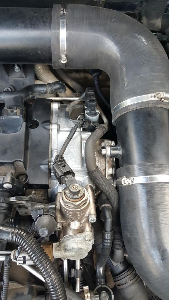

So I've just got back from my trusted mechanic! I've had the Timing chain & Tensioner replaced as previously mentioned on this thread.
Apparently it was well on its way out and I was lucky to have it changed when I did.
He also had to replace the Timing Chain cover with the Sprocket as it was knackered! So thats the shiny new bit (Behind the hpfp) in my engine bay at the moment (Pictured below)
Those of you who have a rough / diesel sounding idle when warm I'd advise you get yours checked / changed as well. It's made my car sound how a petrol engine should sound! I completely forgot how it sounds like as its gradually been creeping in. It feels like a new car!
