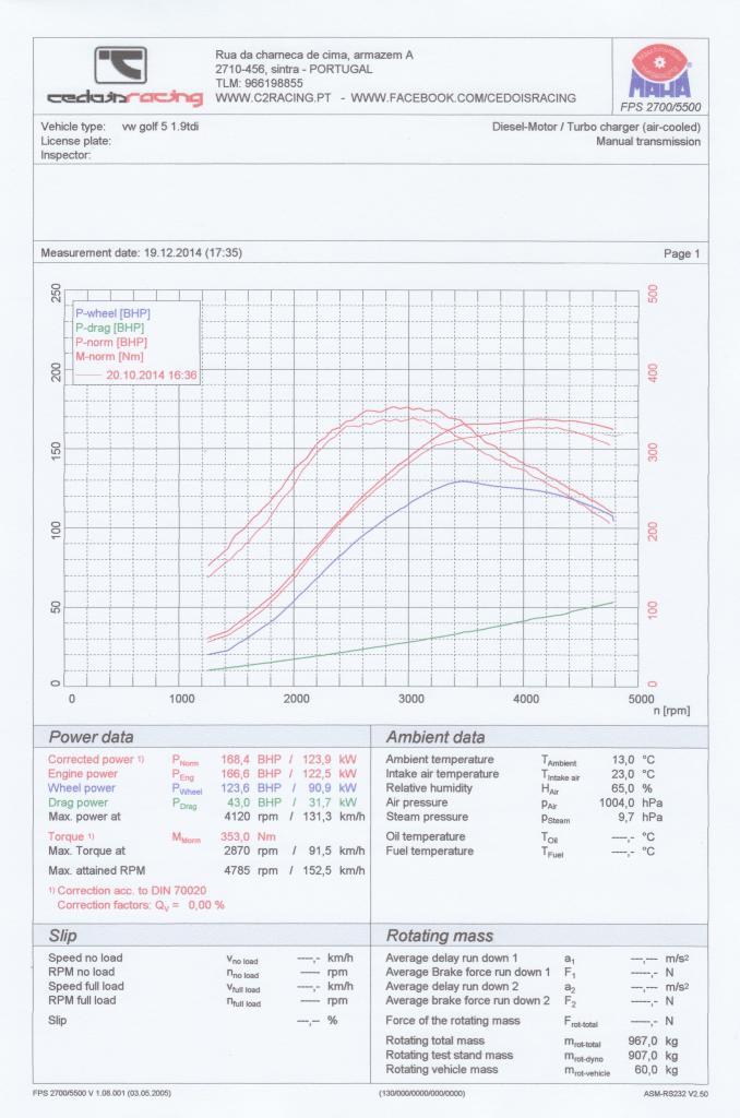

After getting a remap adjustment here's the outcome. :smiley:
Old map vs adjusted map:
The bum dyno already suspected these results. :grin:
