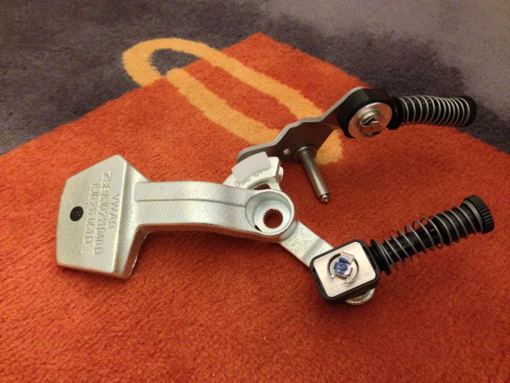

Got the rest of the parts needed for the short shifter from VW today.
So here's my future OEM short shifter for PR-0EJ gearboxes with metal side bracket to replace the factory fitted plastic one assembled:
I'll have to wait for the next oil change service to get the shifter fitted. Currently with 11.000 km/6.835 miles.
Ordered the new wheels and Continental SC5 last week and they should be available by the end of the month. :pomppomp:
Here's the parts list that I got for the short shifter if anyone is interested:
-Short shifter: 8J0711046D
-Metal side bracket: 1J0711203L
-Small bits needed for the side bracket: 1J0711761C, N90815903, 1J0711550
-Lubricant: G00045002

Got my Golf serviced yesterday. While it was there got the Audi TT short shifter fitted with the Golf MY2006 5 speed metal side-to-side shifter bracket, that had to be modified by a lathe because the fixing pin had 10 mm of diameter. The original plastic part has 12 mm. The lathe made and fitted a new 12 mm metal pin to the bracket.
So these parts were fitted:
And these are the parts that were removed:
Already made around 100 miles/160 km and shifting now is easier, more precise and faster thanks to the short shifter and the 42 Draft Designs shifter bushing set. :smiley:
