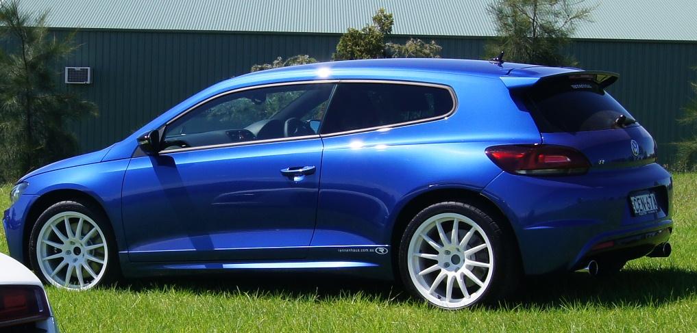

Got some white TD's on order from the group buy.
This is what sold me on the white ones.. bearing in mind he has not lowered and I have more acceptable arch gap, with my 12mm spacers I should still get almost identicle poke (stock rocco wheels are 18x8 et41) which is perfect for a square stance on the road.
