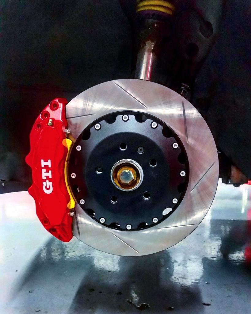

Any pics of the Forge kit installed?
There is a place near me that supply's and fits them  :innocent: - thanks for the awesome review
dansmith180
Re: Dans grey MK5 GTI hybrid k03, many brake reviews.
« Reply #472 on: February 27, 2016, 06:40:12 pm »
No worries guys, plenty of great reviews on here have helped me get the right parts before so glad to be able to return the favour  :drinking:

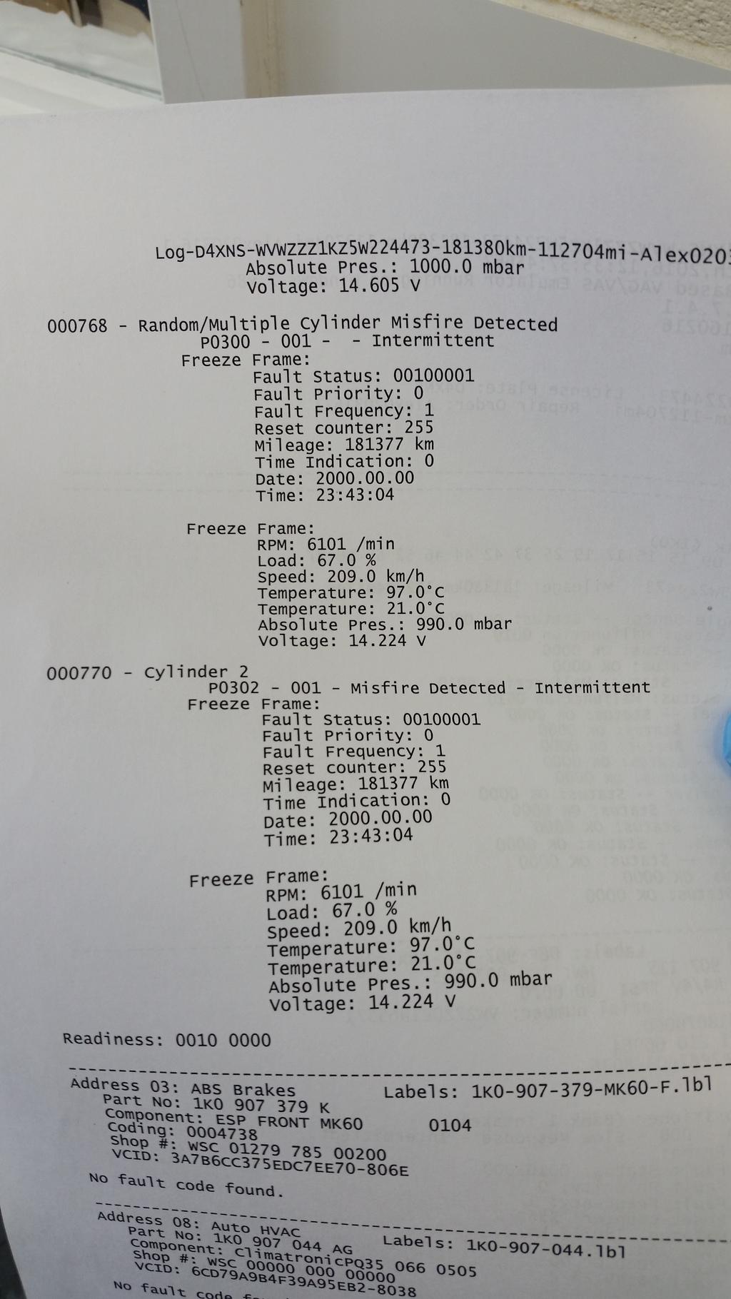

So on Tuesday night I made a whoopsie, engine management light flashed at big speed and car held back on me. Started misfiring like a bitch so drove carefully and plugged her in the next morning
Cleared codes, switched coilpacks 1&2 around, drove it and still the same. Went and found my correct socket to pull out the spark plugs.
Plug number 1 looked a bit white maybe?
Plug number 2 was slightly different
 :scared:  :scared:
Replaced plugs and runs fine although I am now going to find the fueling issue and get that sorted. Have driven the car 20 miles or so and seems fine so hopefully whatever bits came off the plug turned to dust and were shot out of the exhaust without damaging anything.
