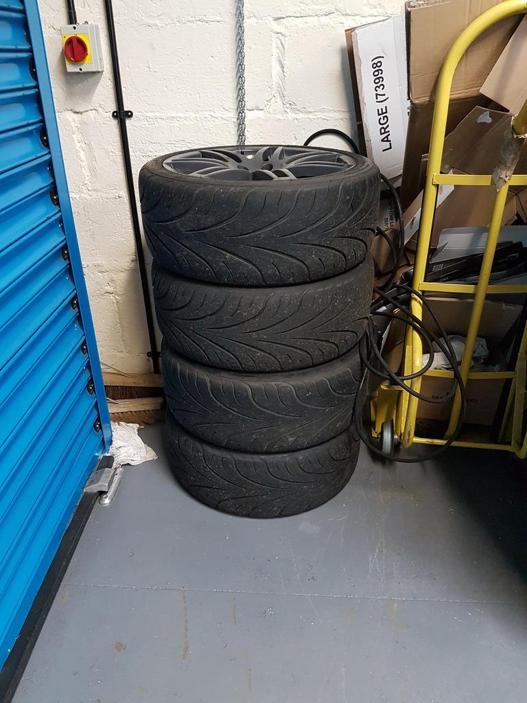

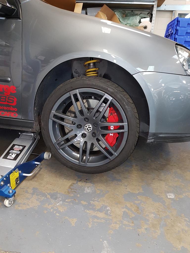

I bought some track/ slag wheels off a mate last weekend.
Nothing too special but they were cheap, strong and wrapped in Federal RSR's
But as usual there's an issue

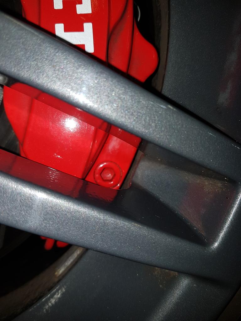

Loads of room behind the spokes

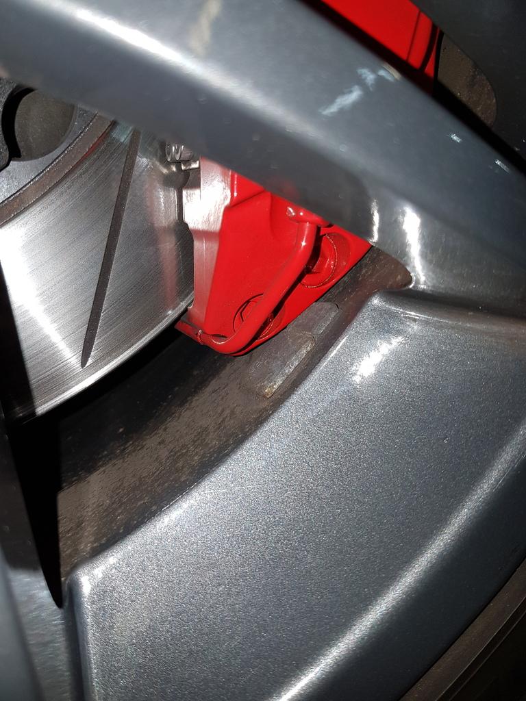

Just clears the barrel (a bit tight for my liking tbh with the heat they will be under)
Along comes Mr wheel weight to ruin the party. Due to the shape I might be able to have them re-balanced much further back but tbh it's a bit close anyways and was as usual an impulse purchase. So looking to sell and maybe just do a track day at Bedford on 19th September using my PS4's as it'll just be a bedding in session anyways

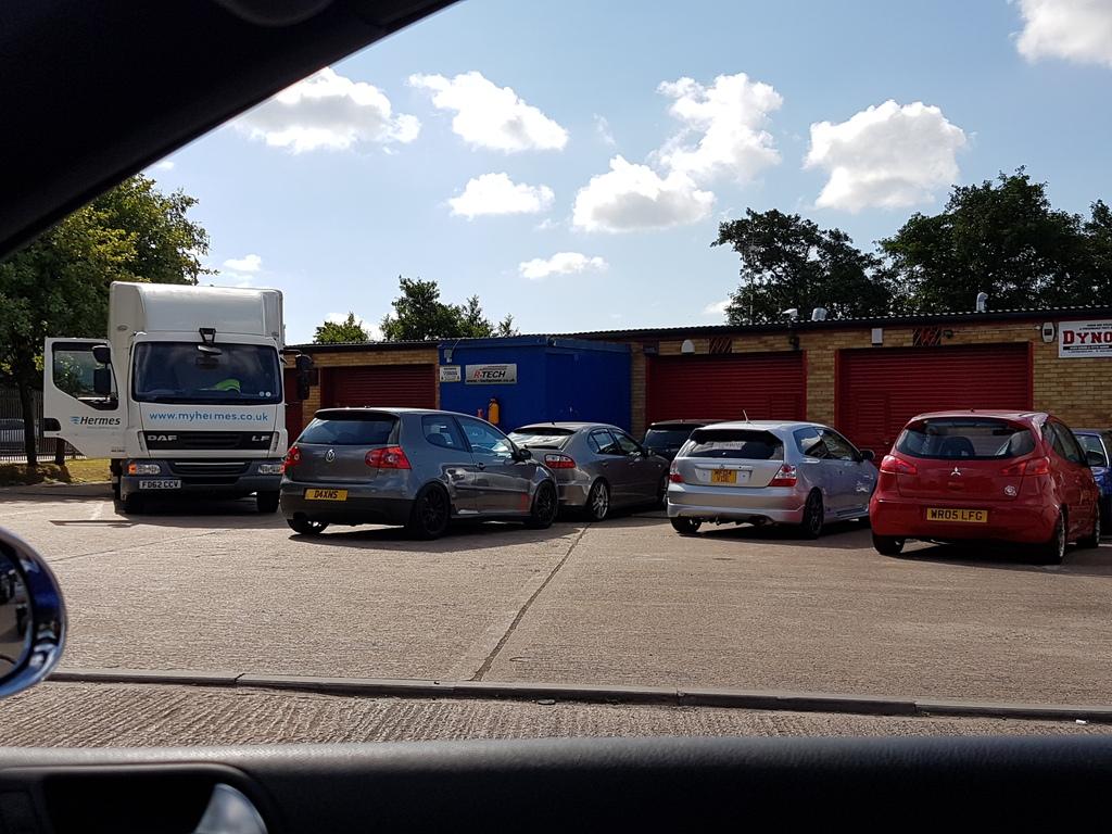

Dropped the car off at R-tech yesterday who unfortunately were closed so I'll be speaking to Niki on Monday I believe.
POV shot of where the magic happens  :rolleye:
So now she's just waiting to have all the horses packed in and hopefully doesn't bloody break anything.

If your wheel fitter/balancer knows what he is doing then you can have the weights placed in the centre of the barrels. I had to have this done.
Yeah I could get it sorted but it's so close even without the weights so I don't really want to. The problem is half way through the wheel the barrel steps up and gets thicker so the back half would clear fine and the front half it tight as balls.
