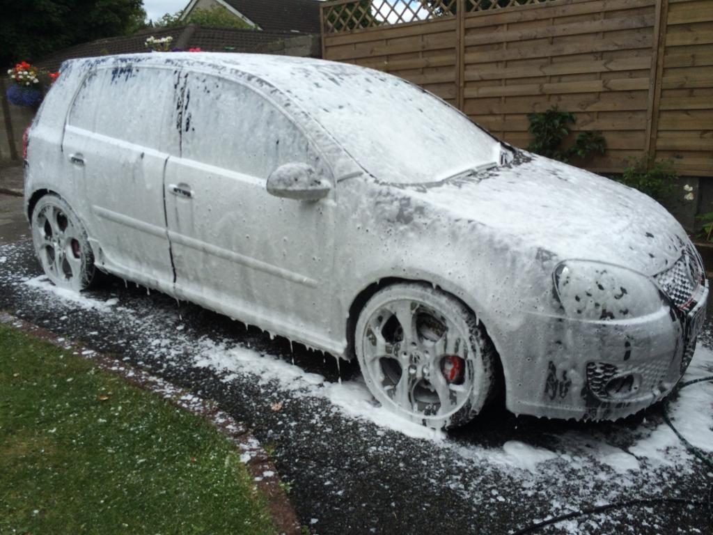

Step 2: Snowfoam 1
I use CNP demon foam and a homemade lance adapted for my pressure washer. Just spray it on and leave to remove the more stubborn dirt then rinse off after 5 or 10mins.
Step 3: Pre Clean
I use orchard citrus pre clean diluted down to how about my car is. This removes all traces of old waxes and sealants for a fresh base.
Step 4: Snowfoam 2
Apply some more snow because you’re guaranteed to have missed something and rinse.

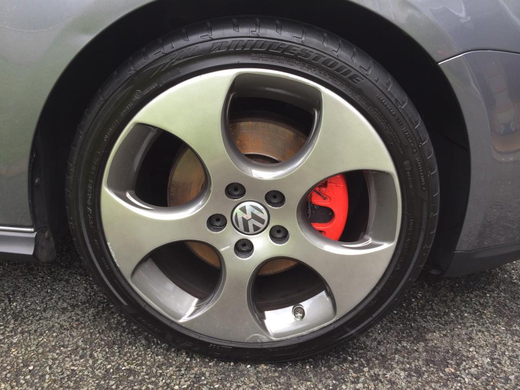

Step 6: Iron X
Get it all over the car, wheels would be the main culprit. Don’t do it in direct sunlight and leave for no longer than 5 mins or it WILL stain and rinse again.

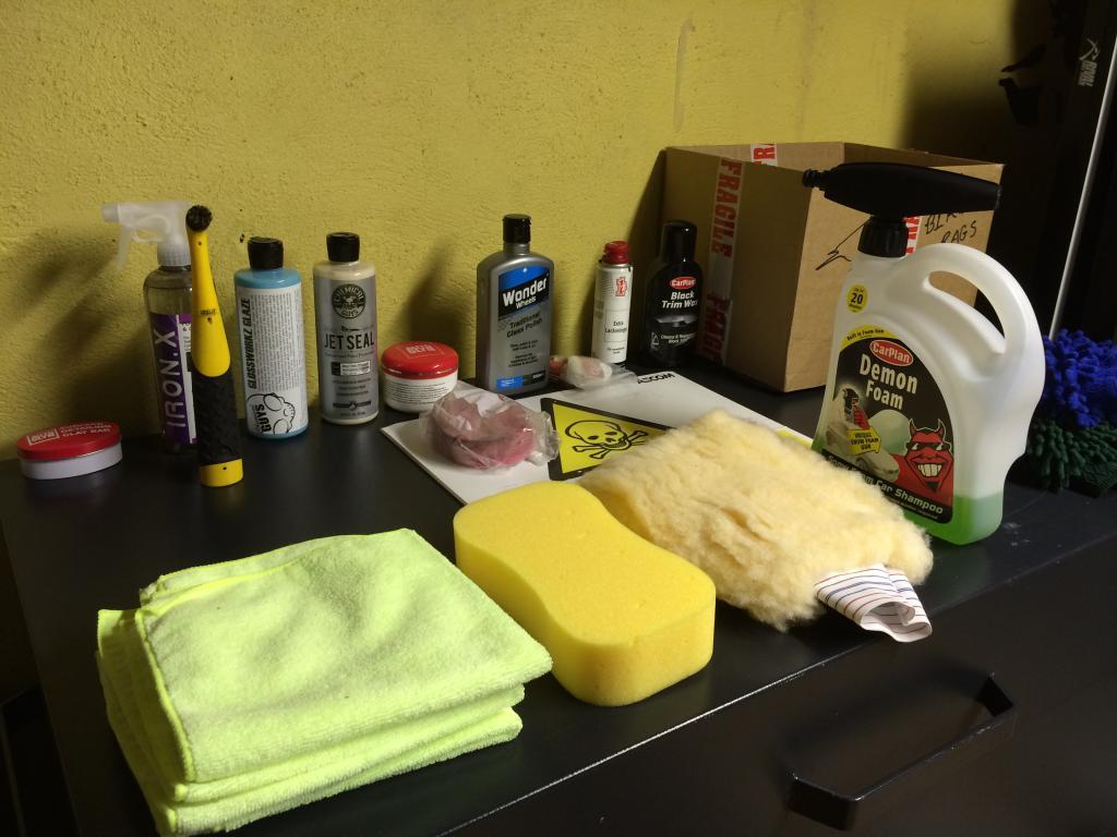

Just some of the items I used below

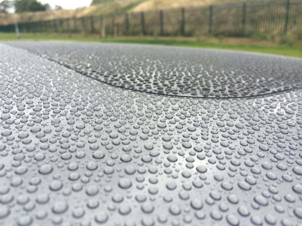

Step 13: Sealant
I applied 3 coats of jetseal 109. Wait 20 mins after each application before applying the next. Don’t forget to do your wheels too but I wouldn’t bother with the plastic trims.
Step 14: Wax
I applied 3 coats of autoglym super HD wax. Don’t let it sit for too long or it’s tough to buff off. Again out of direct sunlight.

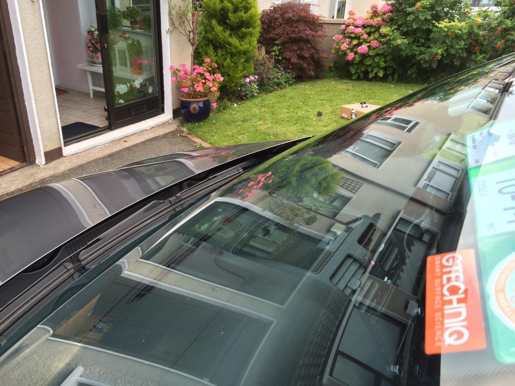

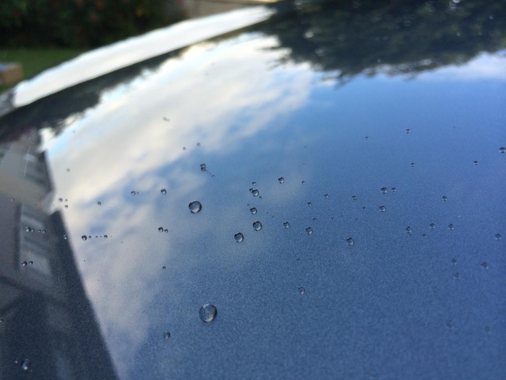

Step 15: Windscreen Protection
Now that it’s polished from earlier on I applied some G1. It’s a hydrophobic coating that you paint on and it’s amazing!! Just dab it on with the cotton pads provided. Wait a while and apply 2 more coats to the front. Remove residue with the residue remover supplied. Buff the hell out of it with a microfiber cloth after. It may seem like you’re removing the coating but you’re not. This stuff seems to get into the glass on a microscopic level. With the left over amount in the bottle give all other windows a single coat as they don’t need the full 3.

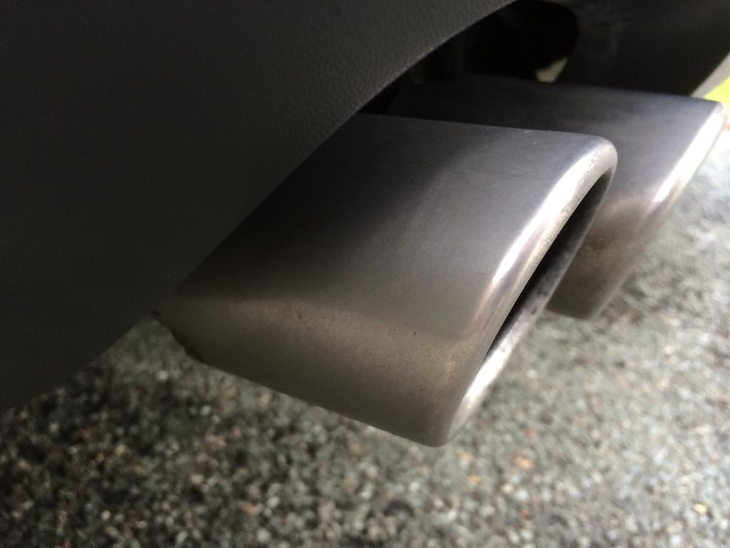

Step 16: Polish Exhausts
Refer to my build thread for a full breakdown of this.

Step 19: Tyre Gel
Apply tyre gel but keep it far from the newly cleaned alloys.

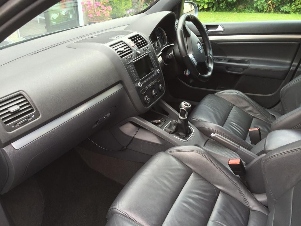

Interior

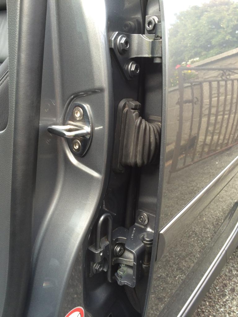

Step 2: Door Trims
This is a good 2 hour job. I use chemical guys all purpose cleaner diluted down 10:1 with water and spray it on. Remove all of the old grease and gunk and seal it up with jetseal 109 and or wax. Don’t forget to regrease the doors.

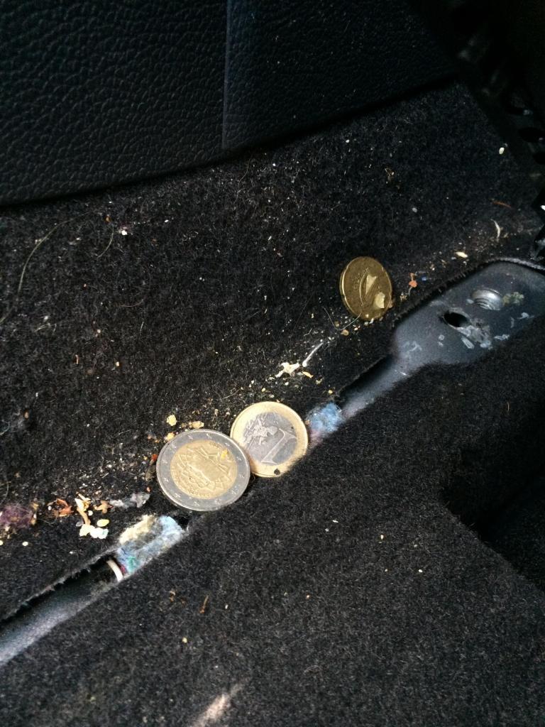

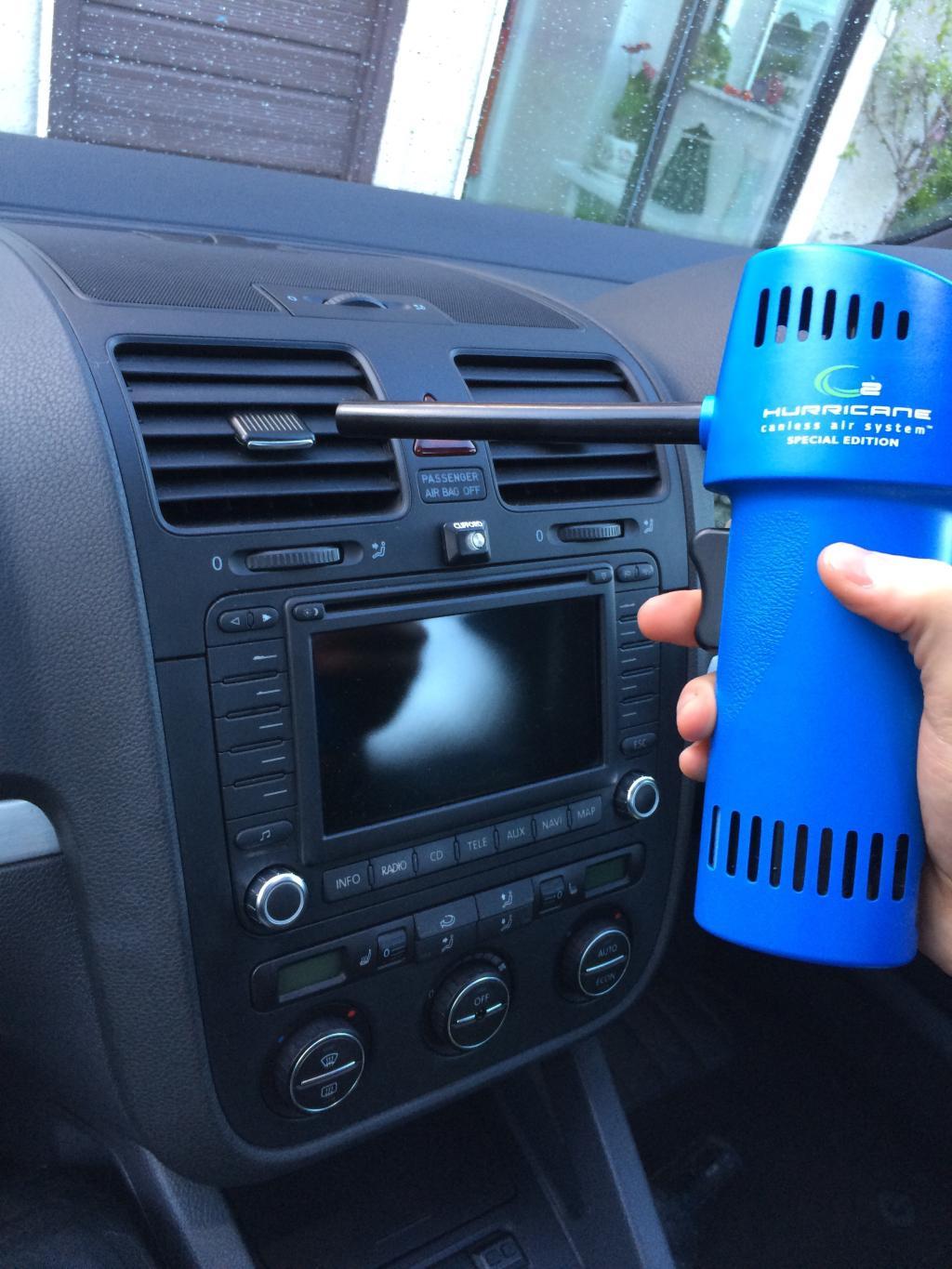

Step 5: Hoover & Canned Air
Before hovering, sweep down all the crap from high level working your war down. I use a Hurricane O2 canless air system which blasts air at 220mph. The vents in particular annoy me so a blast with this and the dust that kicks out is unbelievable. Also handy for the crevices around the window and fuel switches.
Hoover everything. Take the seats out and get down the sides. I guarantee you even find money. They’re held in place with 4 spline bolts. See build thread if you need.
Step 6: Pre Clean
Dilute chemical guys APC to 20:1 for interior use and get spraying. Wipe up with microfiber cloth.
Step 7: Leather Clean & Condition
After a quick warm water clean off the seats I applied some leather conditioner. The conditioner gets sucked up by the leather depending on the condition so do a few coats with special attention to bolster and seatbelt area.
