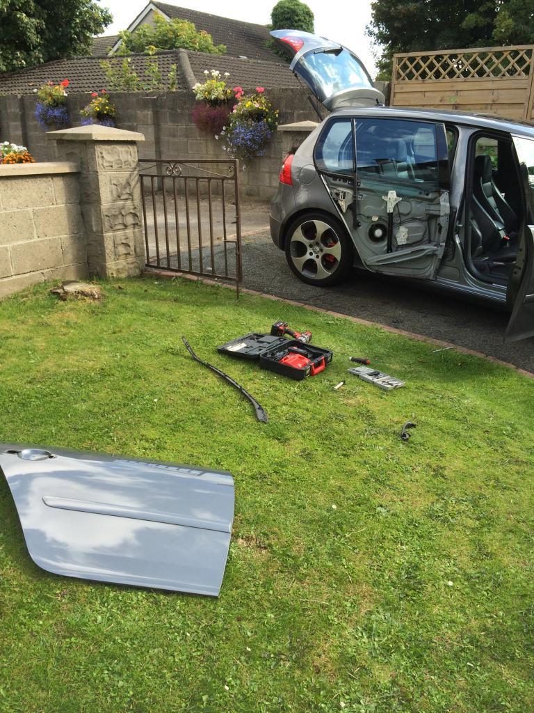

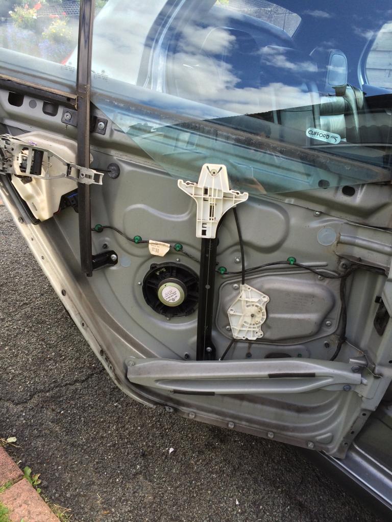

Door Lock Module Replacement
Had an issue with the rear passenger door not locking so I picked up a new module
Door off
Door on

« Reply #63 on: September 07, 2016, 02:09:24 pm »
Excellent work Luke :happy2:
It's amazing how often the poxy door modules fail :confused:
Looks like you made quick work of the door panel on/off. Like Mr Miagy :smiley: :happy2:

It's not the first time, I recently did the same job on another golf that was in a collision which bent the support frame jamming the window in the open position!
Hours work now on and off with plenty of cursing of course  :signLOL:

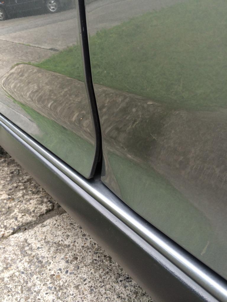

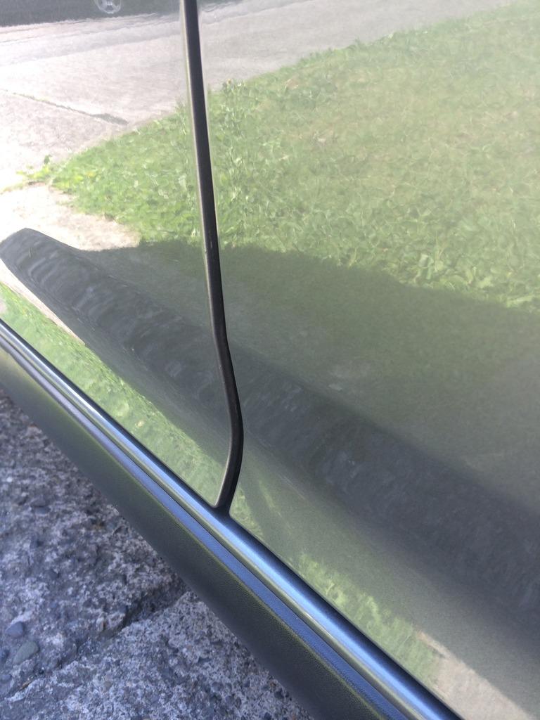

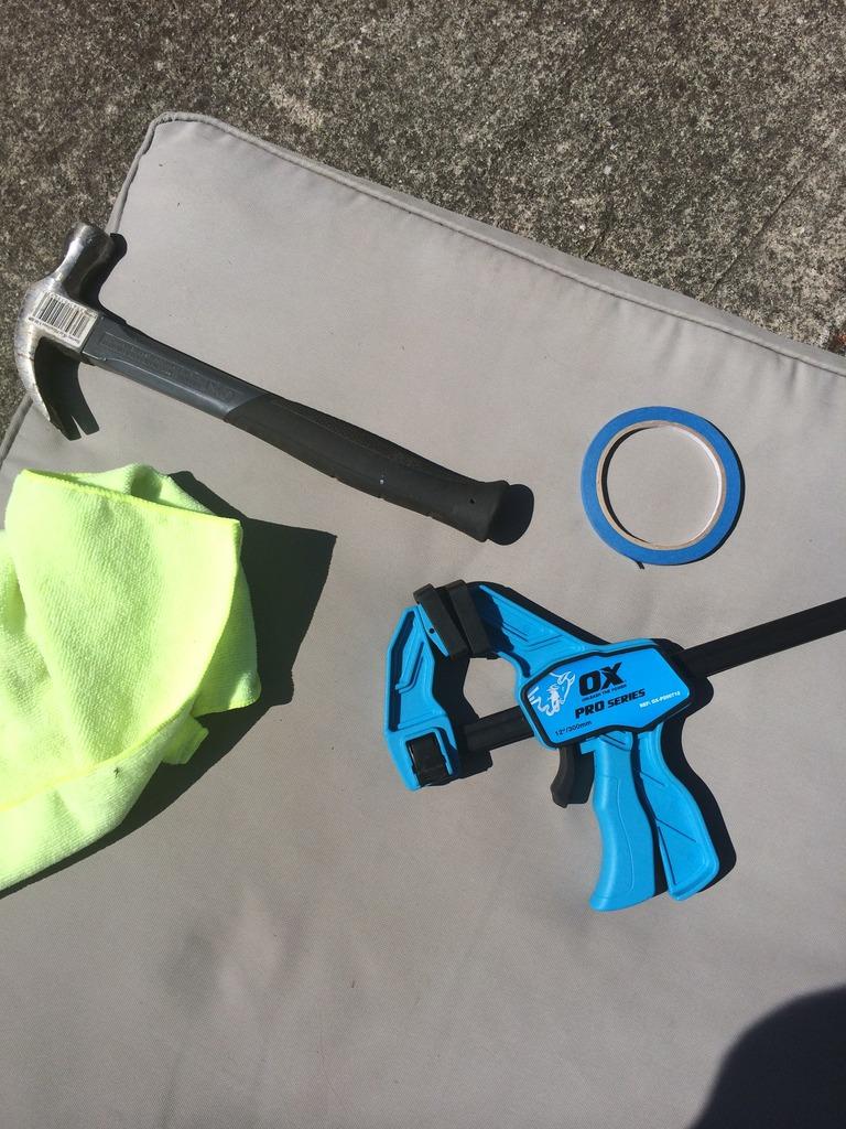

So I parked up for a stroll on the beach and when I came back to the car I see a nice bend in the door.
As you can see the bend is a bit of an eye sore.
Out with some masking tape to line up the repair area, a rubber ended G-clamp so I don't do any damage, a hammer (cushioned with a rubber bung) and finally some microfibre cloths and polish when everything is done!
I removed the plastic trim on the inside of the door so I had just bare meal to squeeze. I taped off the area in question and gently forced the G-Clamp closed until it lined up. Pretty much got it after the first attempt but went back two more times to make 100% sure. Fortunately there was no paintwork damage, cracking or bending so I removed the tape and voila!
