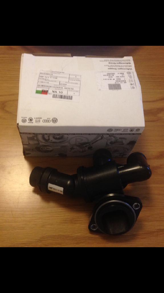

I should say that before swapping the stat, my temps were getting to 65c max on Fiscon.
This is what it looks like, though a GTI has a different part number to an ED30 (F not H on the end?)

I think overall I get a couple of MPG more but more importantly, the engine is running at the correct temperature.
If there is any doubt your stat is faulty, I recommend swapping it out.
