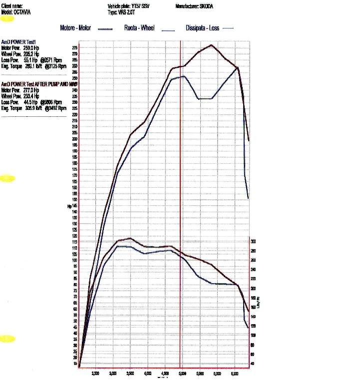

Ive used it from stage 1, stage 2 and then stage 2+, I loved stage 1, but ever since installing stage 2 onwards i have not been 100% on its efficiency. Ive always had my doubts that it was performing at its best. Plus at the time there had been quite a few instances of people having issues with bluefin stage 2.
This led to a paranoia(sort of) about it running crap, which was confirmed when i did a bit of testing against an eqivalent spec REVO'd car. which absolutley annihalated me. This led me to install stage 2+ and the HPFP. now if you read up on that for any remap, you here about these enormous increases in the midrange and massive performance enhancment.
what increases did i feel. Well it was a definate improvment over stage 2, and it sorted out the huge drop in power i had in stage 2 guise, but i wasnt bowled over about it, and in a way i felt a bit let down after all the promising stuff i'd read about stage 2+ maps.
Also bluefin is not setup for your car as other maps are, its just a generic map, so if you have any additional mods such as a TBE instead of just DP, or different types of air intake etc, then it wont make the maximum benefit of the mods.

from the passenger seat i seemed to notice more and even more so when ben pointed it out, was that the bluefin was very strong in first and second, but then seemed to become erratic and stutter when pressing on. usually around the 4.5k and 5.5k rpm range. he descibed as very strange. and not a very smooth delivery. We then did all the logs on the car, and heading back home.
we then took bens car out whilst we were waiting, and it undoubtably was better setup, extremely easy and progressive to drive.
To put it into  perspective if AMDs dyno figures can be trusted the bluefin stage 2+ was putting out 277bhp 305IBft, and bens only 260bhp 295Ibft. yet bens was much much better(especially when it is one stage below and has no uprated HPFP:eek:)

bens car was alot better than mine in bluefin mode, but my car now feels alot more powerful than bens in the midrange and holds on to it very well.
The delivery of it is absolutely fantastic. It feels so smooth and linear in comparsion to before. It also pulls like an absolute train. Its feels non stop.
This is the feeling i was expecting to get when i went from bluefin stage 2 to stage 2+.
So to get this feeling when going from a bluefin stage 2+ map to bens stage 2+(stage 3) was a shock. It goes to show how rubbish the previous map was and how well shark perfomances map is.
