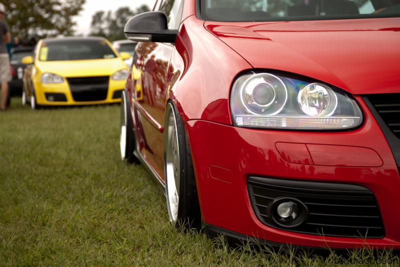

« Reply #4 on: December 12, 2014, 01:54:28 pm »
If you are running quite low you will be able to get away with it with rolled front arches and 205/40 tyres.
But it's not an easy fitment to run
That's 8inch et27 front and 9 inch et25 at the back.
