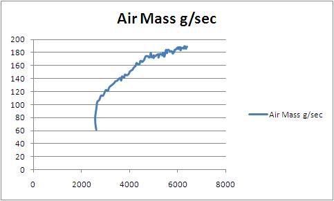

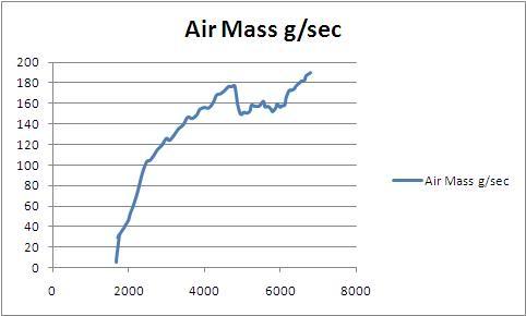

as i said in the beginning of this thread when on bluefin I had a flat spot at about the same spot. but when i changed maps it disappeared.
looking at the before(bluefin) after (Shark performance) air mass readings you can see the big drop in the graph @ about 5200rpm, but not in the second one. Maybe do some logs on yours and see if it does the same
-Air Mass readings before
Air mass readings after
