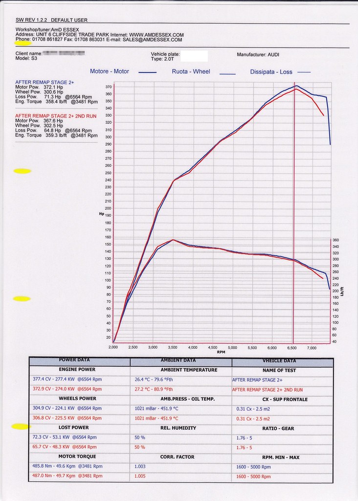

just to through caution to the wind here, i was told a fuel pump would cure this flat spot..
however, i have come across an audi s3 WITH a pump but the issue still no fixxy....
it seems to smooth out a bit but im sure it will still be noticable when driving..
see graph between 3.5k > 4k
