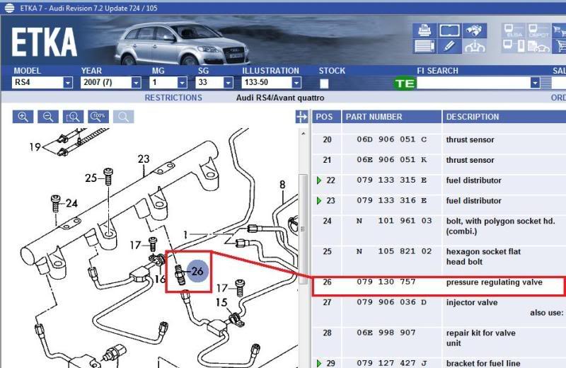

i have ordered up the RS4 fuel pressure regulating valve to see if i can get rid of the flat spot on B9 setting. The OEM valve limits the pressure to 130bar vs the RS4 valve that limits the pressure to 136bar. Near redline i have seen requested fuel rail pressure at 132bar but the actual rail pressure never goes much above 130bar then drops to about 127bar and builds back up to 130bar..therefore the OEM valve must be doing its job and opening and closing to stop the pressure exceeding 130bar. With the RS4 valve im expecting the requested fuel rail pressure to be met as the valve will stay closed up to 136bar. if there is a pressure surge it will still protect the fuel rail and open to release any pressure above 136bar. Ill keep you guys updated.
The valve in ETKA:

That valve looks like a b*tch to install if you don't remove the intake manifold...

I have fitted the RS4 valve to my car. It was a bit of pig to fit without removing the inlet manifold. I found sleeving a piece of 5/8 hose over the valve to spin it undone and removing it made light work of it though. I've not yet had chance to drive it hard enough to see if it has cured the dreaded flat spot but the car deffinately feels smoother and more responsive.
