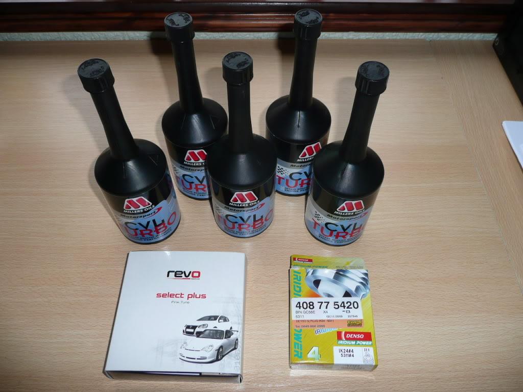

Messing around with this little lot :evilgrin:
New Denso Iridium power sparkplugs. Cooler rating than stock plugs and should help stop any misfires. :happy2:
http://www.densoiridium.com/ir_power.php
Millers CVL Turbo Octane booster :evilgrin: :evilgrin: :evilgrin:
http://www.millersoils.net/M3_cgi/millers2.cgi?product_id=157&exact_match=on&type=motorsport&cart_id=
Tested this on my original REVO stage 2+ settings of B9 T6 F9 and found it to perk up the top end nicely. I've since phoned REVO HQ who said to try B9 T7 F6 to get the most from it without pushing the car too far. The results are very good as seat of the pants difference feels very good throughout the rev range. I've booked back in to Nobles Dyno to see if it is just me or if it really is the settings and octane booster. :jumping:

I heard this was the best stuf so bought some, havent used it yet. Do some logs to see if the timing is advancing more and its not pulling back.

Any actual VAGCOM logs to compare? Looks you've a more intersting day that I have.

I suspect that it's just down to the settings...

Hurdy, would have thought with your mods you would be running Boost 9 Timing 6 and fuel 6 on v power.
Then for higher octane than v-power you just advance timing

That's what I'll be doing from now. I've gone from b9t6f6 to b9t7f6 to try out the octane booster.
As Bacillus says, the timing difference will make the extra power, but it should be the octane booster that allows me to run t7 :smiley:

Increasing your fueling to F6 has the "side effect" of extra cooling the cylinder temperature thereby allowing higher timing to be used with less CF pull.   :smiley:
You don't want to increase the fueling too much or you'll end up with petrol dilution of the oil on your cylinder wall leading to increased rate of cylinder bore wear.

Yeah, they did mention that running F6 would help with keeping things cool. If the logs look okay I might push it back up to 7. :happy2:
