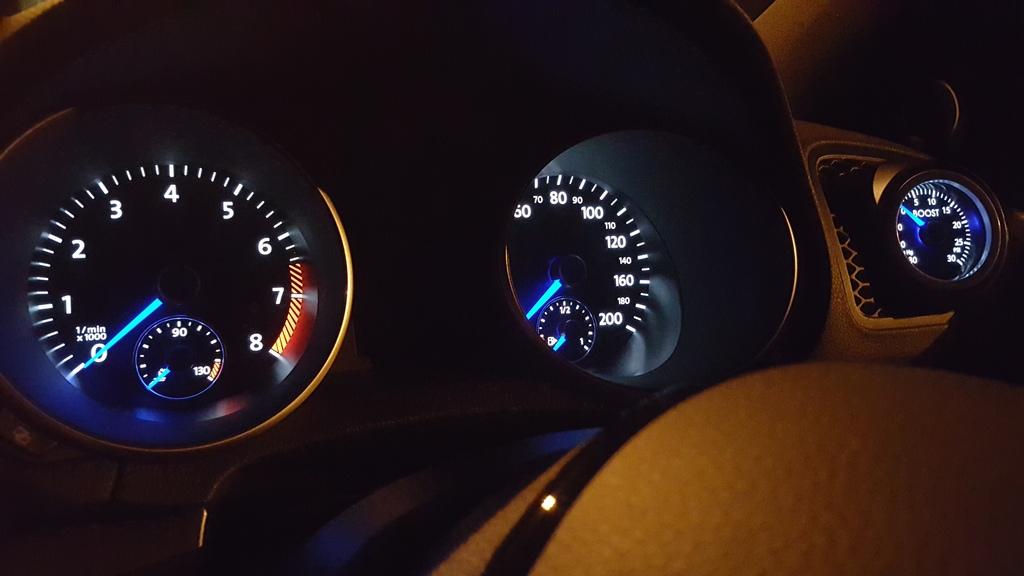

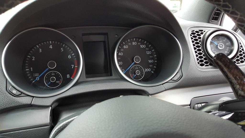

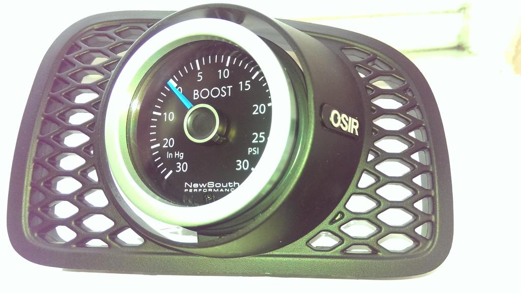

Newsouth boost gauge that matches the 'R' clocks and an Osir gauge holder vent

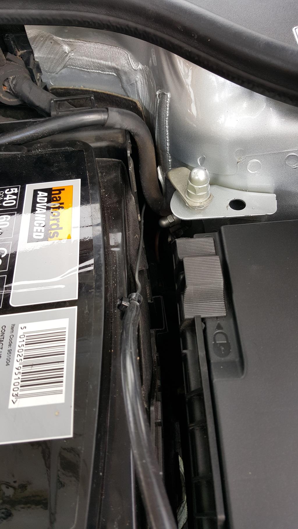

didnt fancy taking all the revo kit and battery tray etc to out get through the firewall so a mate pushed a metal coat hanger through from the inside and see where it came out
now hows that for jammy lol,took a couple of attempts and a few zip ties to hold it on but manged to do it eventually so over the moon,new nipple onto the forge boost tap then fed under the dash and up the side panel near the drivers side fuse box into vent ;)

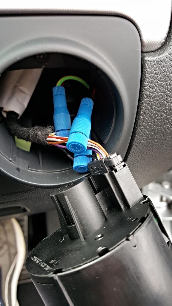

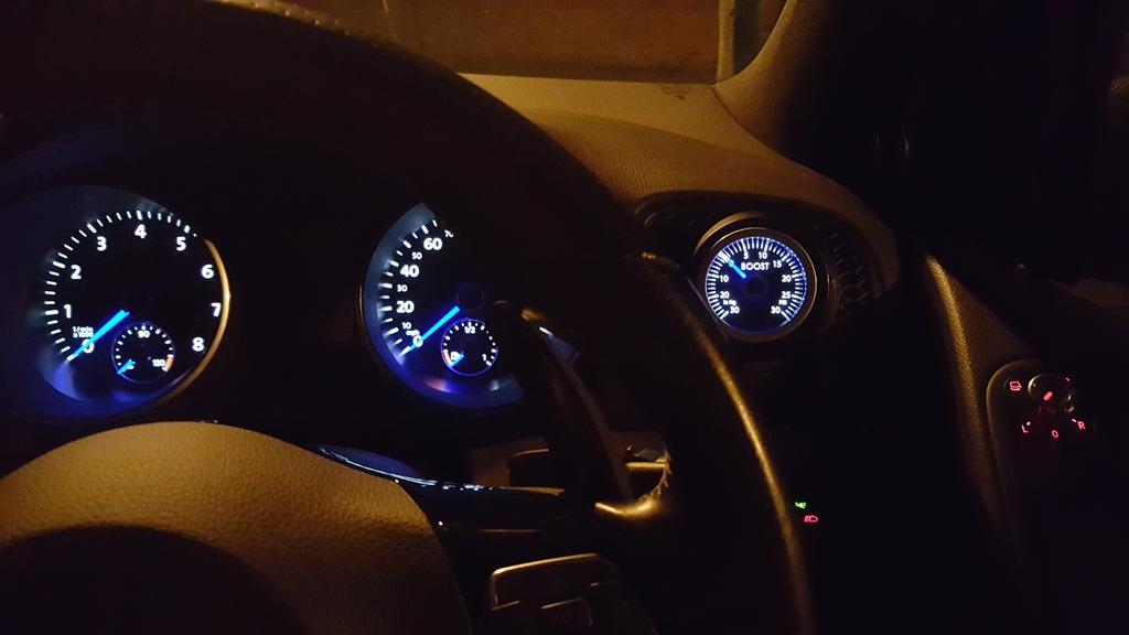

now im not really into the electric side but after reading the newsouth guide for wiring it into the headlight switch with posi-taps(never seen these before) i thought id give it ago,10 mins later all up and running :jumpmove:
so easy to use
finished

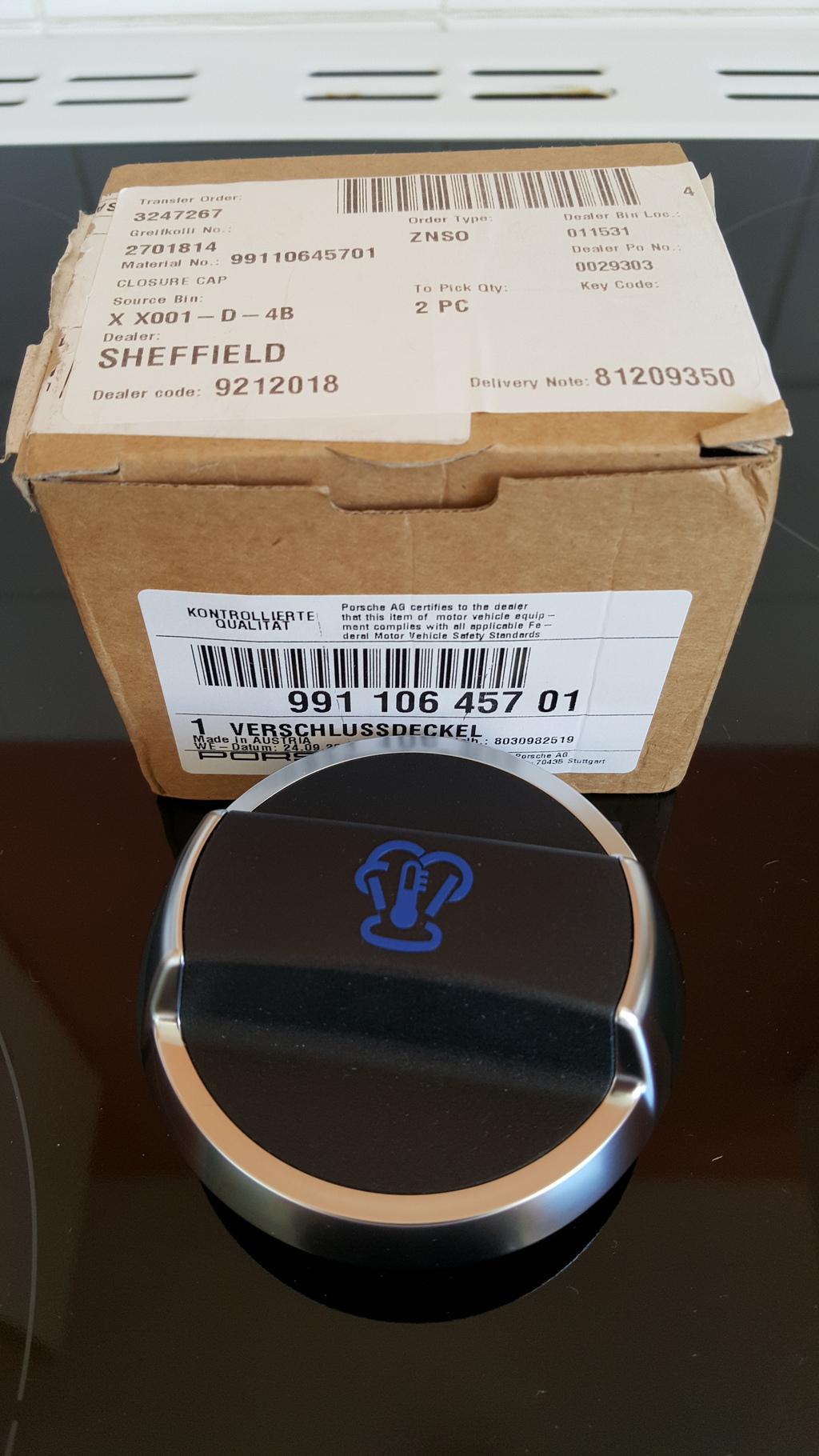

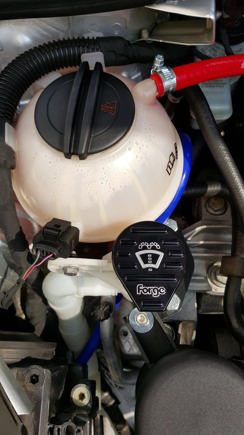

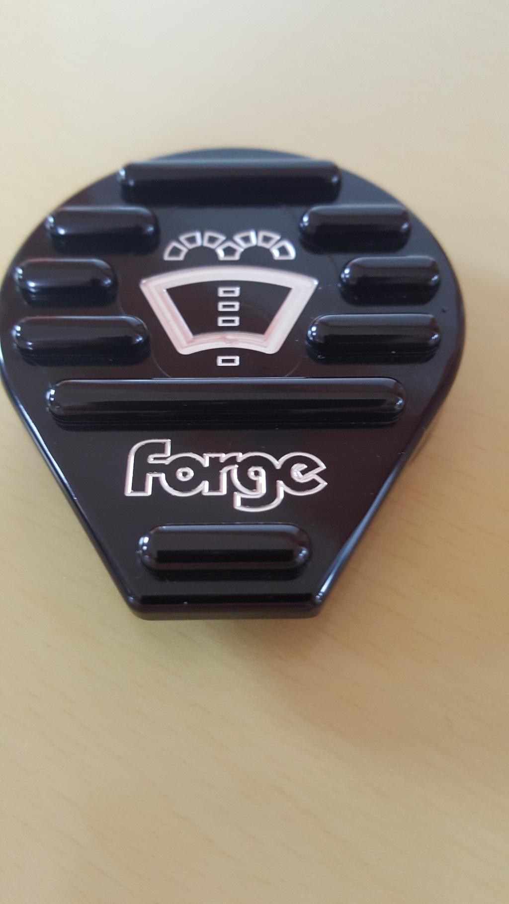

well chuffed,only a few dress up parts for the engine went on aswell,forge washer cap and porsche coolant cap(no pic)

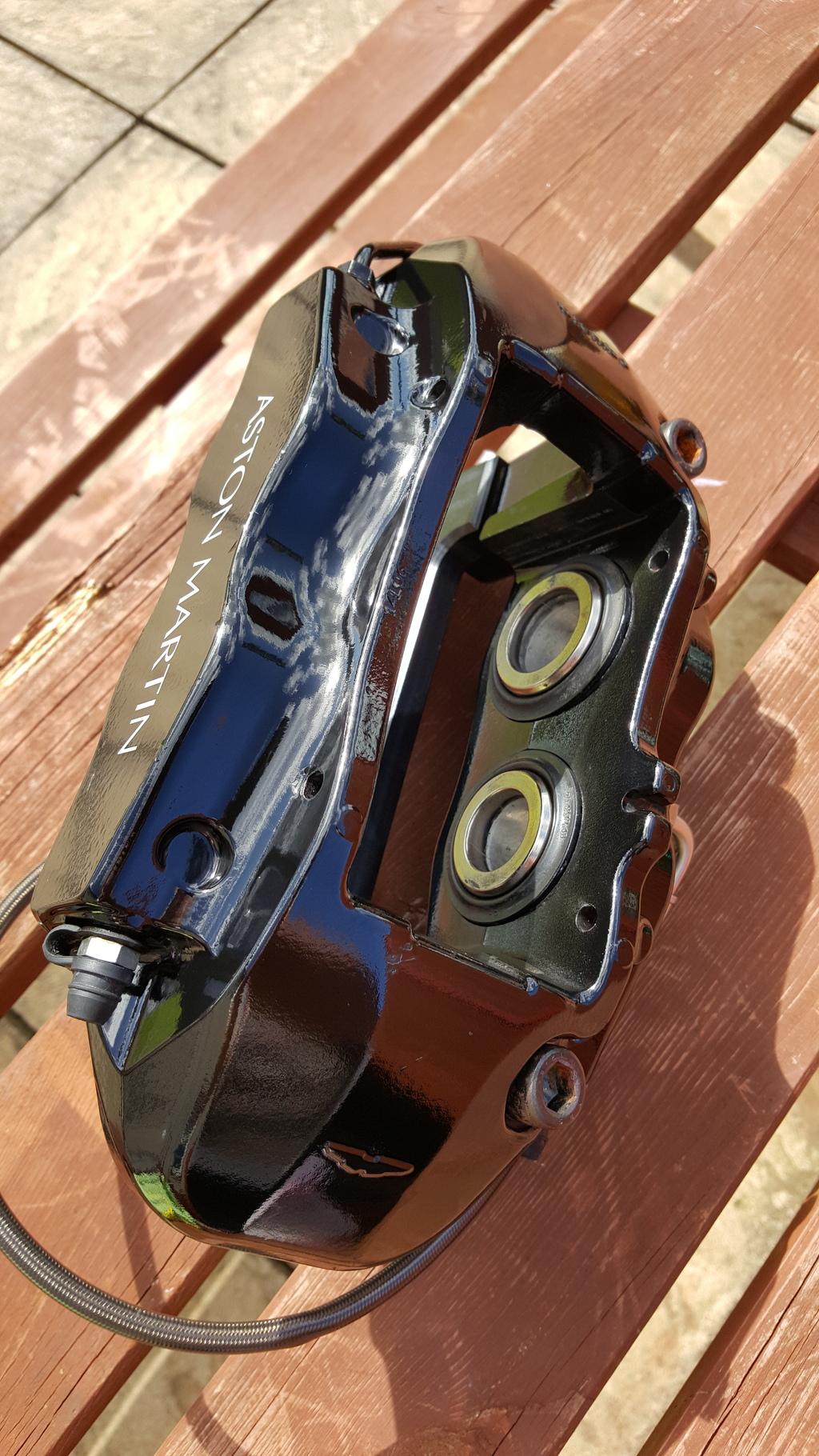

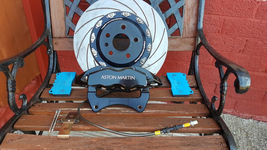

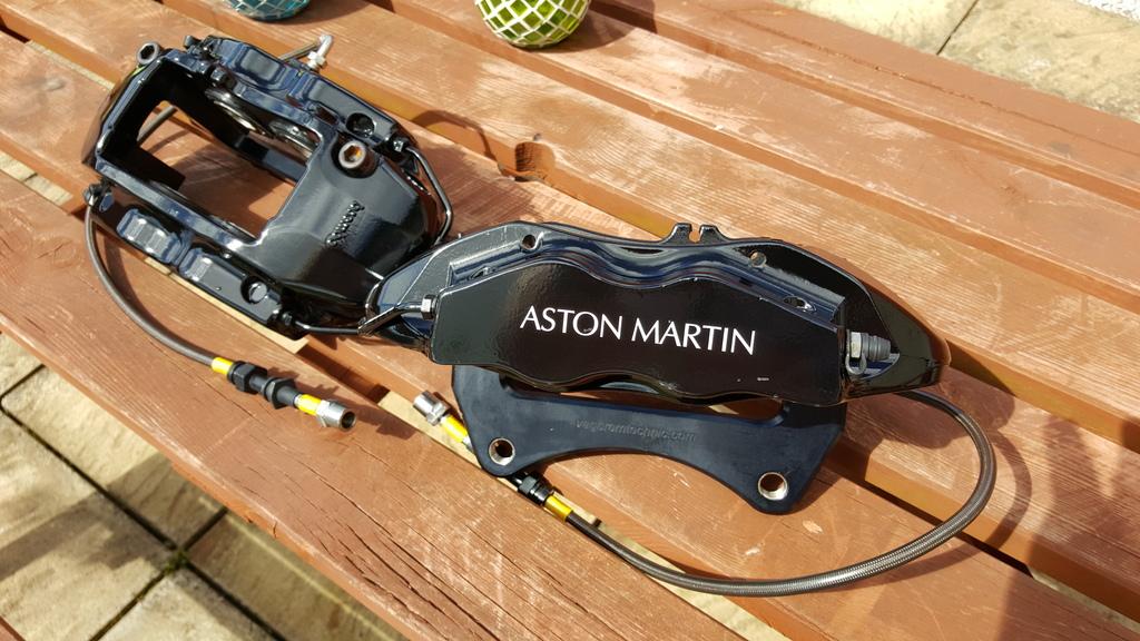

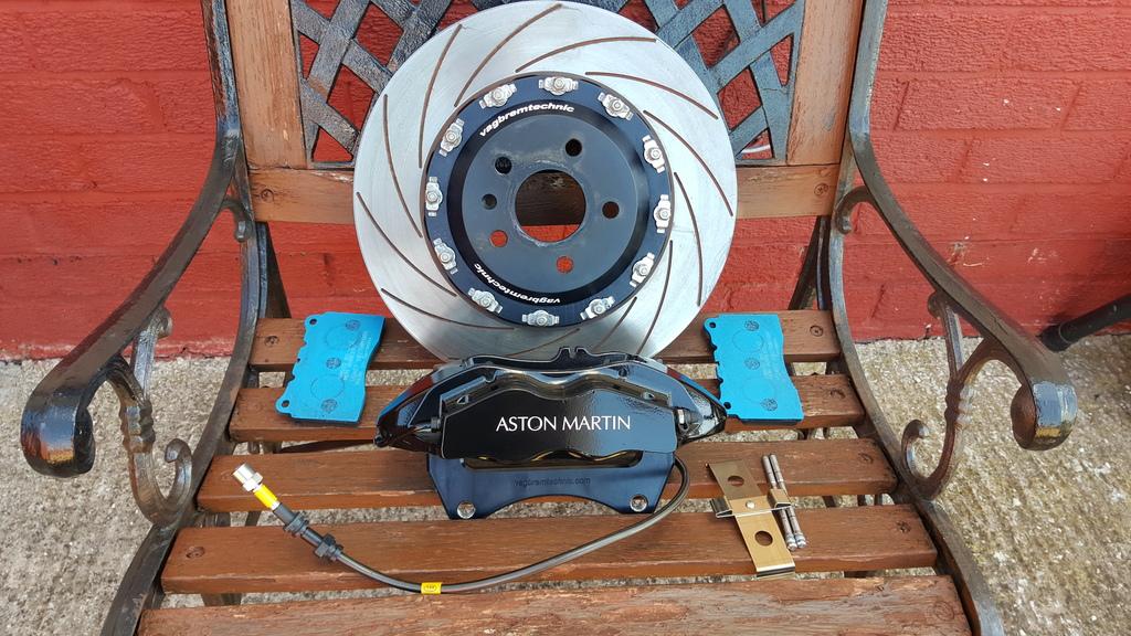

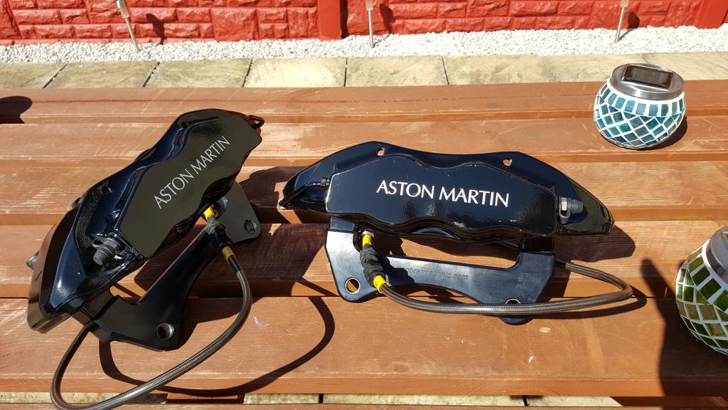

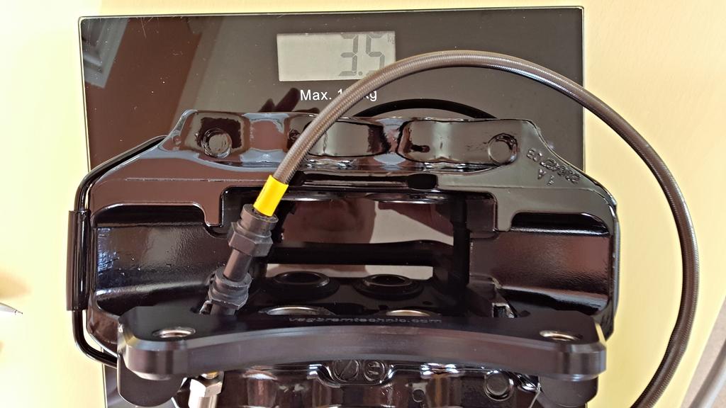

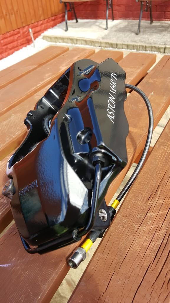

Brake Porn :drool:
Aston martin 4 pot calipers with vibratechnic mounts,362mm Ap 2 piece discs,Pagid RS4-2 pads,Hel braided lines
cant wait to get them fitted,there suprisingly light also which is a big benefit  :happy2:
calipers with lines-3.5 kg per side
discs-9.2 kg per side
pads/pins/brackets-1.kg per side
Golf R mk6 R-tech tuned GTX3071r
Re: My Cupra K1 replacement-Golf R mk6
« Reply #138 on: August 30, 2015, 01:12:25 pm »
Good choice on the brakes there.  :happy2:
They really do make a difference, especially considering the OEM discs are roughly the same weight ( iirc the AP discs and bells are a kilo lighter) and the OEM calipers are 10kg each!

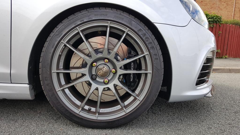

« Reply #142 on: September 17, 2015, 06:08:55 pm »

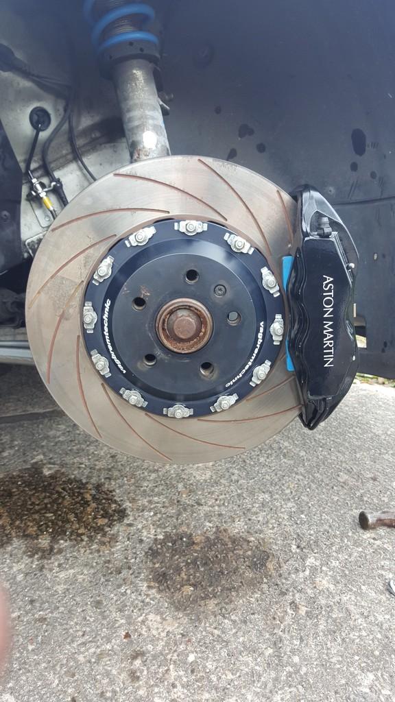

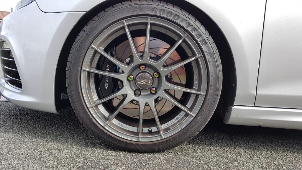

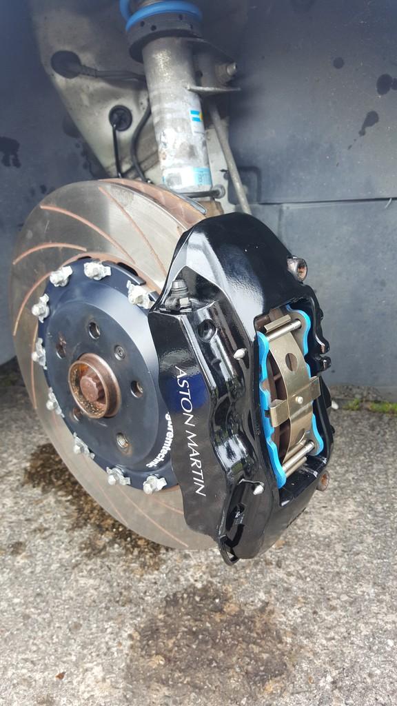

well the front BBK is finally on,ill update with pics tomorrow sometime but thought ill just compare weights etc
Aston calipers 3.5kg Oem calipers 7.5kg saving 3.9kg
AP 362mm discs 9.2kg Oem 330mm discs 11.8kg saving 2.6kg
pads were the same,so a total of 6.5kg per side,not bad :jumpmove:
« Reply #144 on: September 18, 2015, 12:43:54 pm »
Huge unsprung weight saving there mate, hope they perform well for you! :happy2:
yeh deffo m8
compared to the oem where as they bite at the top of the pedal these bite lower down but stop you very suddenly with my m8 saying he's claiming whiplash damage off me as tested them on the way home lol

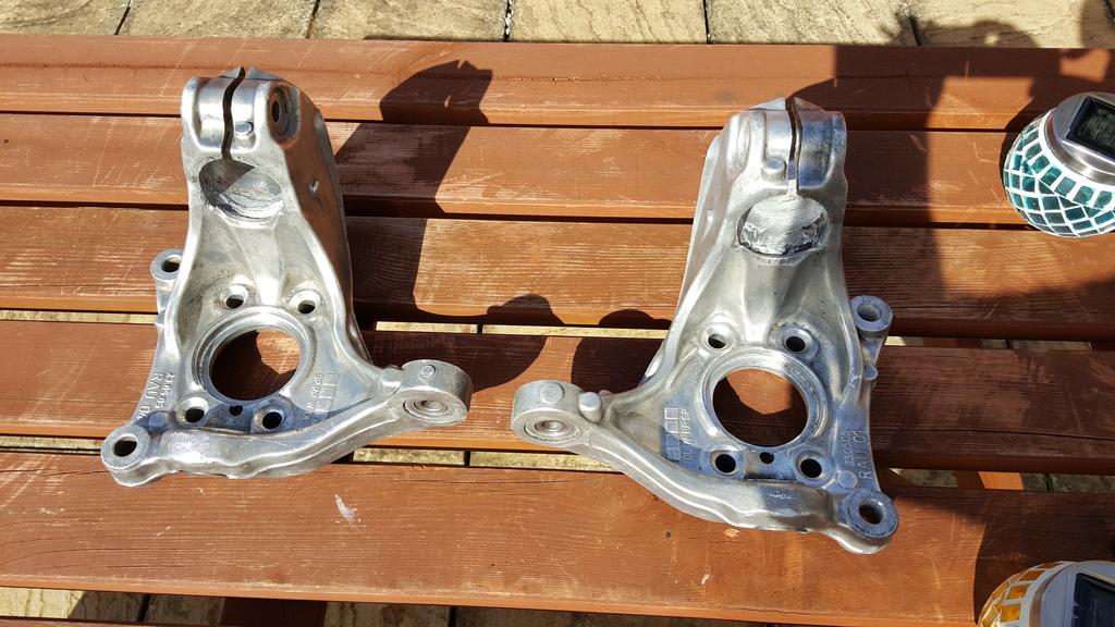

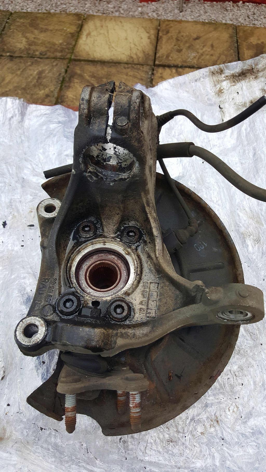

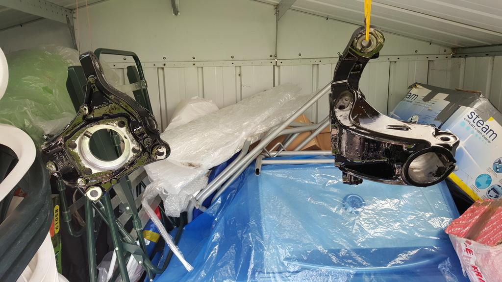

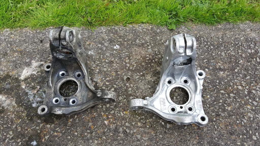

Alloy hubs sorted now,second hand but off a newish car so ill give them a clean and hammerite them while the weathers crap,ill order brand new bearings and ball joints to complement them,the superpro adjustable ball joints wont fit with this bbk so eventually ill get some ground control top mounts,itll be nice to see the outcome weight wise between the hubs
Offline toosmiles
  • -Given: 22
  • Posts: 635
  • My Ride: http://www.mk5golfgti.co.uk/forum/index.php/topic,92286.0.html

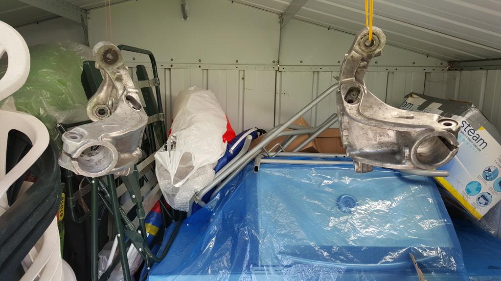

« Reply #146 on: September 25, 2015, 04:42:25 pm »
well guys,

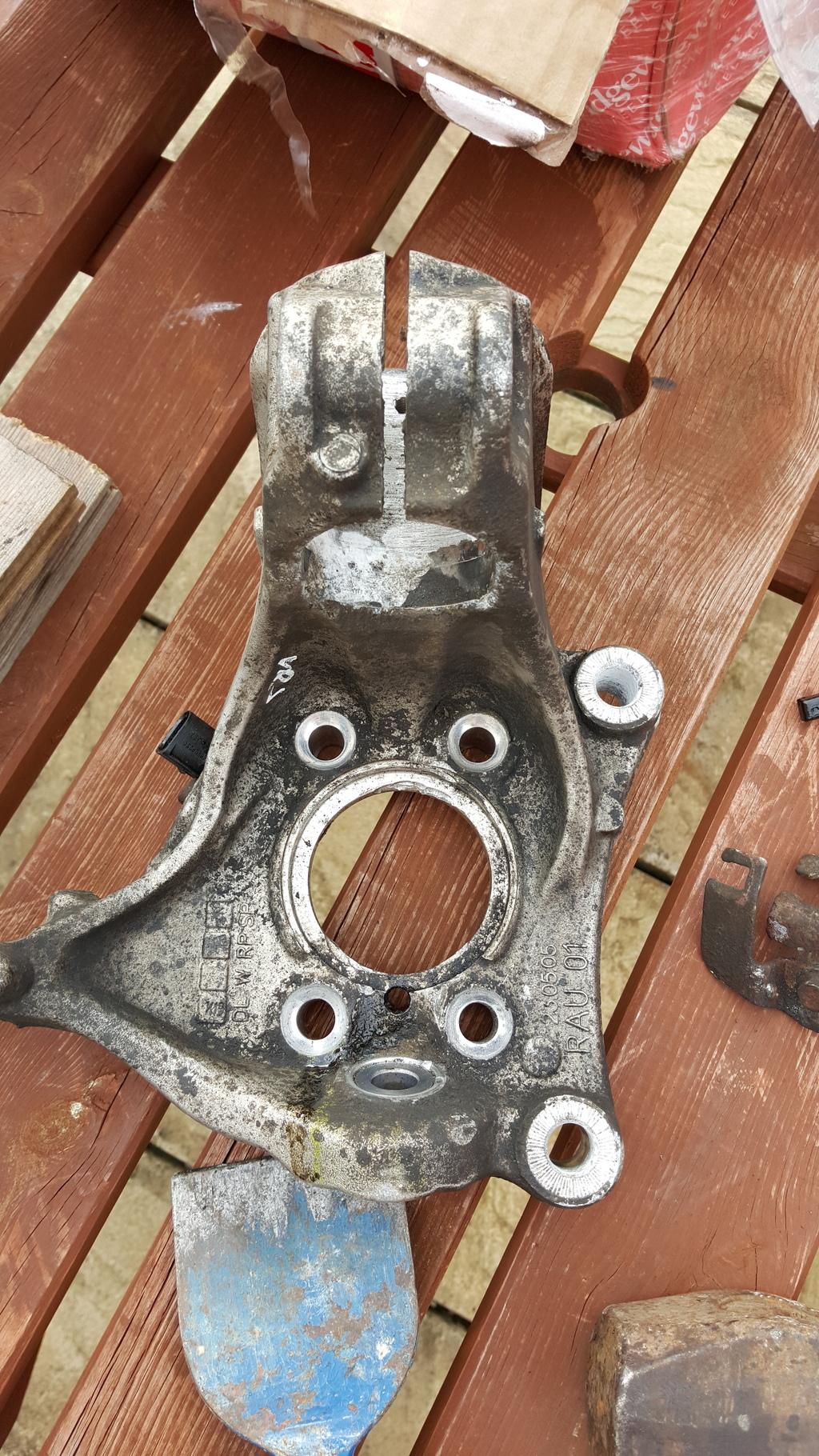

received both alloy hubs today so weighed them as if on car with sensors,ball joints,bearings etc
7.1 kgs
2.9 kgs stripped bare
giving them a clean took about an hour each with degreaser and wire brush on a drill  :surprised:  quite a big difference
hanging ready for some hammerite,thin coat for now,ill need to scratch off the runs etc near the bolt holes after theyve dried

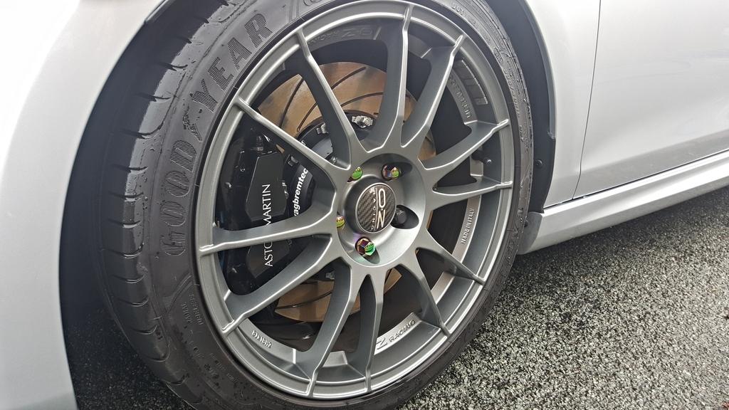

Brake pics

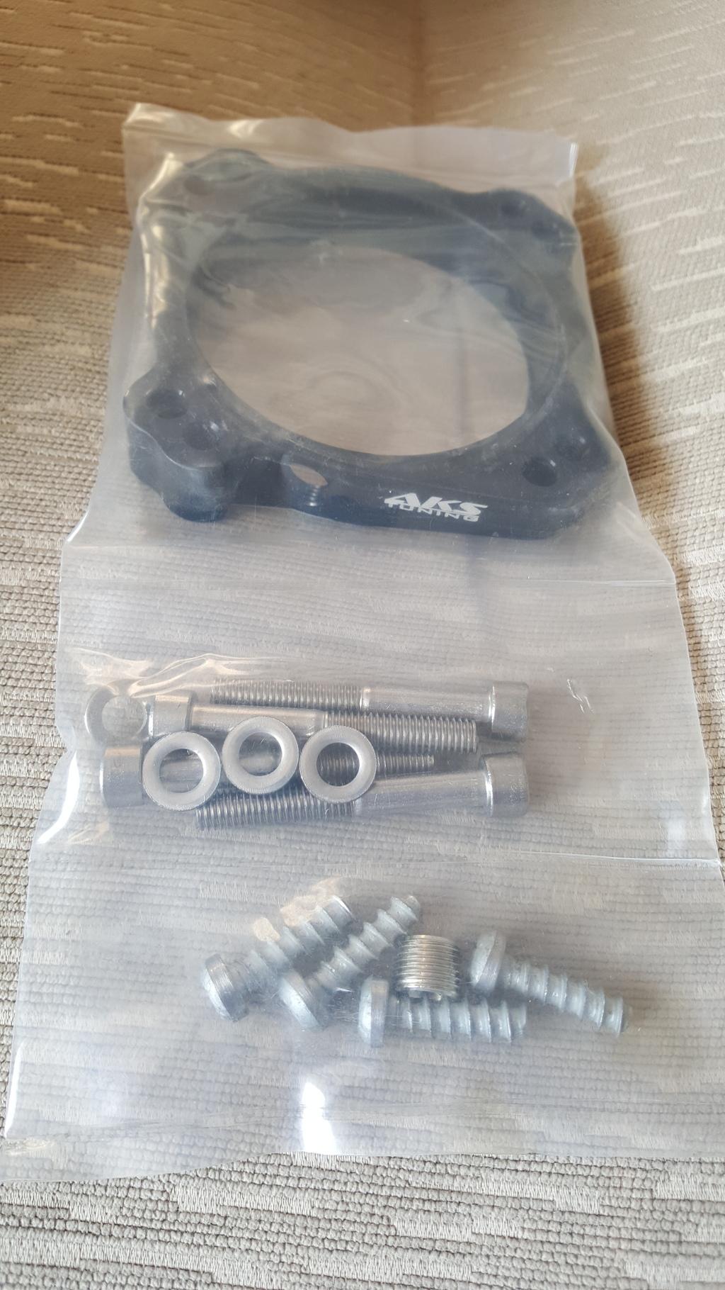

also picked up an Aks methanol plate cheap to fit while the intake manifold is off to save on labour costs
« Reply #149 on: September 27, 2015, 12:41:10 pm »
Ultras and BBK  :drool:
