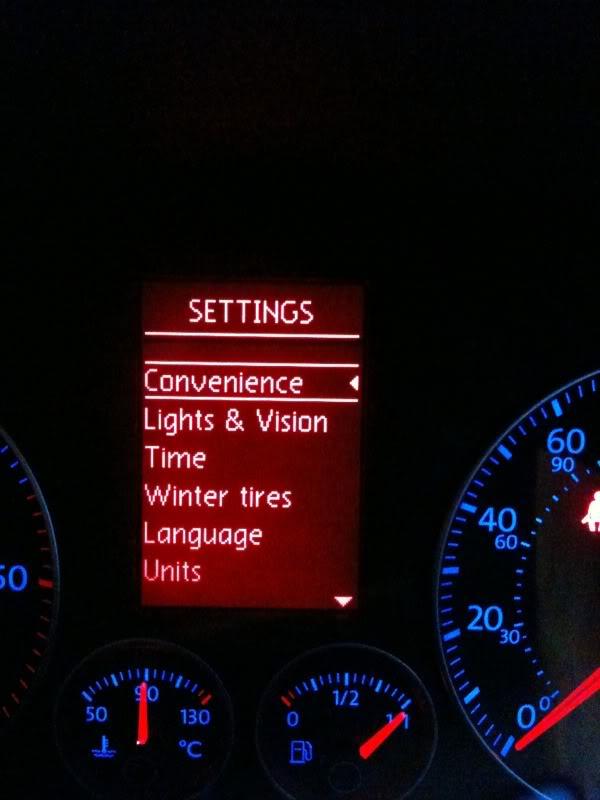

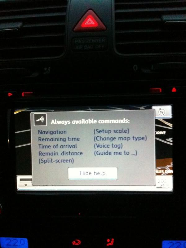

Had a new module coded by darren(mortigttdi) which now gives me a convenience menu :happy2:
and RNS510 voice control fitted by darren
Want to just say darren is an absolute genius and a real great guy to have on the forum
HUGE thanks for all your time and effort into making this work for me mate :notworthy: :notworthy:

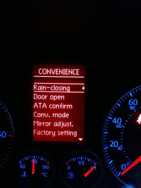

What's 'rain closing'?
Offline mortygttdi
  • -Given: 44
  • -Receive: 146
  • Posts: 2370
Re: New Highline comfort module fitted!!!
« Reply #9 on: November 24, 2009, 12:06:52 am »
if you've got a window open and it starts raining it closes
iirc you must also have the wipers in auto mode for this to work.

To be able to get this and any other convenience settings working you need the highline controllers for the convenience and central electrics,
The rain settings and ATA if not on can be activated on the central electronics and then the sub control for the rain sensor needs coding to activate it.
Darren
