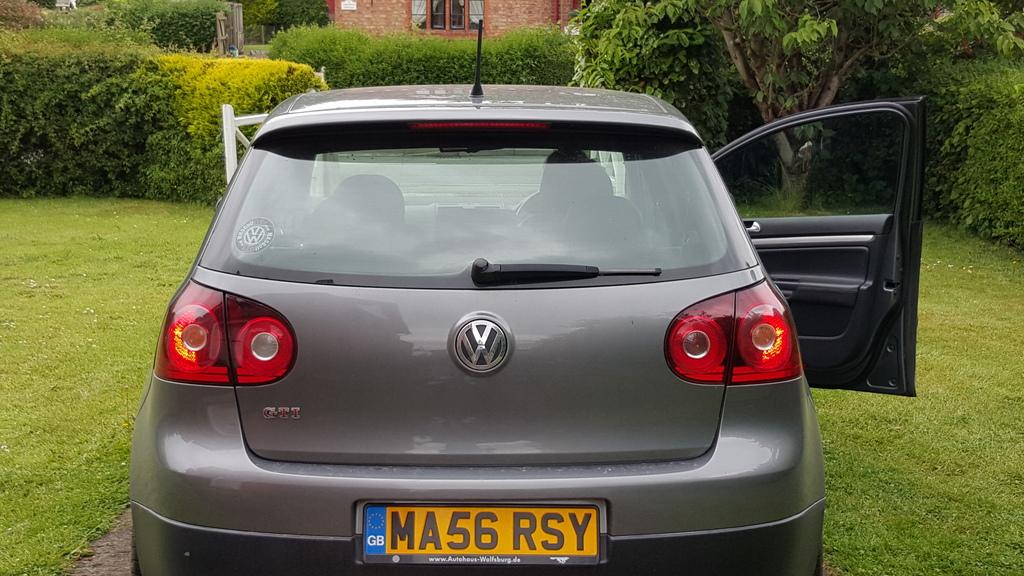

Soo the above pic shows the rear of my car and the complete lack of a third brake light, it has been like this since I bought it. I was promised by the dealer a new painted spoiler, as I  had pointed this out in the forecourt and having done my research knew that the only way to properly repair this was a new one. Well it never materialised and I got sick of waiting. Quick trip to tps in between pantomimes.
I decided I was going to go steady and quite cleaverly drill the lens and use the holes to pop it off so as not to damage the paint around the lens, yeah! that didn't work really. It turns out the plastic lens in the third break light of a mk5 golf gti is the most fragile substance known to science.
The slightest pressure from the bit caused the lens to shatter sending red plastic cascading down my window lodging in my wiper and covering the driveway, but it was a start and after a quick inspection I realised no damage to the paint had been caused out came the rubber mallet and screwdriver.
After removing the red lens I was met with a clear plastic one, enjoying the previous result from my assault with a screwdriver I proceeded in technichal terms to simply rag on it like a banshee till it broke.

Fairly straightforward after this just the reversal of the process with less emphasis on the smashing. I didn't bother glueing the new unit in it held really well on the clips. Standing back I admired my handiwork.
That's better, rushing inside I proudly displayed the remnants of my vanquished foe to my missus. like a returning hunter I announced my successful replacement of my brake light in what would turn out to be a loud and excitable manner the end result being waking the baby and a bollicking.
