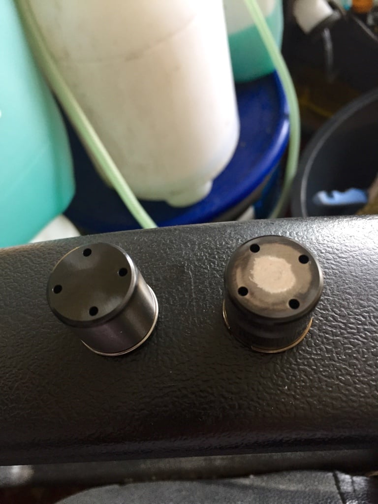

I havn't heard the derv sound can be attributed to the cam follower before

@Peskyjones a few people have said this but since I have changed mine it's a different car. The MPG is slightly better and the engine is a lot quieter too

I'm getting mine done tomorrow hopefully.....didn't realise it makes a difference to the way the car sounds

@z00bz where you getting yours done? Need mine changing as its bugging me had the part sitting for about a month now!

I'm just getting a local mechanic to do mine based in Evington area, only coz I have the banjo style fuel pump which is a PITA @shoaybmakda

@z00bz I have the banjo style one on mine. Was abit of a nightmare but just had to undo or move a few other pipes out the way and was easy enough to go to. Just time consuming

I've had abit of a nightmare with mine, banjo bolt dropped somewhere in the engine bay and we spent hours finding it and failed :-( so now my car can't move from the garage until new banjo bolt arrives tomorrow morning from TPS.........p***** off!!!
Looking at the brighter side....I'll have a new banjo bolt which my mechanic is paying for!!
Old 1 on the right at 99k
