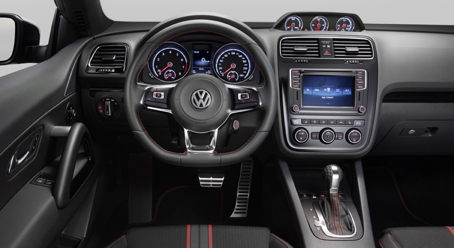

forum-auto doesn't really tell us much we don't know unfortunately. they only acknowledge their existence and suggest like i've been it *might* be possible to retrofit to a pq35 car (like the mk5/ mk6 golfs)
EDIT: Also now spotted in the Scirocco!

This looks so so interesting.
If the screen can fit, the other module is normally located on another place. So the question I guess is to know if there's problem with the connectors, and then... coding stuff.
Here you can see it: 0:47
Here you can see the connectors:
*Note: The conectors I'm guessing will be the same, but this version is not screen + module, it goes all together.
What I'm trying to say is I don't think the ones in my post have the separate module
Yes you are right in a Golf Mk7 (or new Polo) you would have a separate module, but this potentially looks to be everything all in one enclosure...

The Scirocco/Beetle version looks ideal  :drool:
