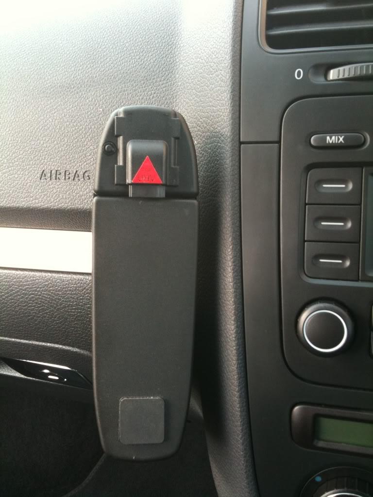

Hi,
Is it a cradle similar to this (attached to the top of the glove box)?
In that case you will probably need the universal bluetooth pairing adapter (7L0 051 435 PA) and support mounting bracket (1K0 035 707 B). I have both of these for sale if you are interested.
I don't think the cradle can be removed from the glove box without leaving a hole. Then you would need to replace the glove box with one that didn't have a factory installed cradle.

Thanks for the reply. That is exactly the cradle I have in my gti. Does the support mounting bracket replace the existing cradle? Also will the Bluetooth adapter allow me to stream music? Could you let me know the costing please.
