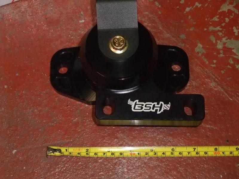

I had a look at a set of these mounts, and the manufacture that has been carried out is very impressive.  Circa £180 from Dubtek on this forum, with all required fixings supplied (not withstanding the charcoal cannister mod - Circa £1).
http://www.mk5golfgti.co.uk/forum/index.php?topic=8294.0
On the BSH Site picture they don’t look too substantial, but when in hand they are a mean piece of kit.

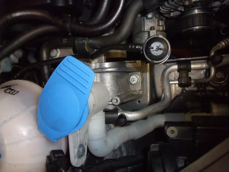

To get to it I unshipped the coolant expansion tank, and removed the charcoal canister.   The canister is mounted by 3 points, 2 bolts and 1 nut.
In the above pic, you can see the 3 mounts in the mid picture.  I have highlighted this due to further work later.
I took the weight of the engine, by placing a jack under the lip of the sump (where it is bolted to the block) and jacked it slightly.
The mount is secured to the block by 2 bolts and to the car chassis by two bolts.  There is also a strap that adds further rigidity, which is bolted to the inner wing.
I removed the mount, and fitted the BSH item.  The mount bolts are torque loaded.  I used the 3 BSH mounts and one of the removed VW bolts.  The bolt I used can be seen in the above picture, with a stud on the bolt head.  This stud is a securing point for the canister.
Above shows the mount fitted.  With the VW bolt in the fore ground, showing the stud.  Also in the left of the picture you can see the extra strap for rigidity.  I Believe that VWR also use this method.  In the picture it also looks like the Aircon pipe is close to the mount strap bolt, there is 3/4" clearance there.

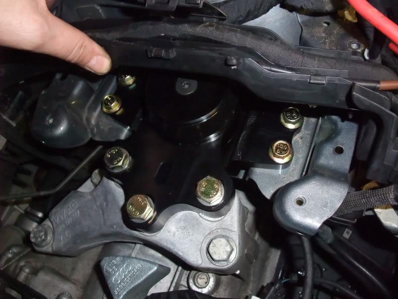

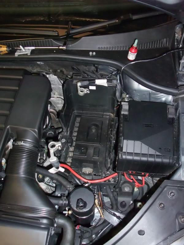

The gearbox mount is somewhat simpler.  You have to remove the battery, and the battery tray.
The tray is secured by 3 x 6mm bolts.  You have to remove it by lifting and twisting.
In the above picture you can see the 3 bolts securing the mount to the gearbox, and the 4 bolts securing the mount to the chassis.
Torque values
Mount to chassis – 30 Lbs/ft
Mount to Transmission – 44 Lbs/ft
Mount center bolt – 30 Lbs/ft
