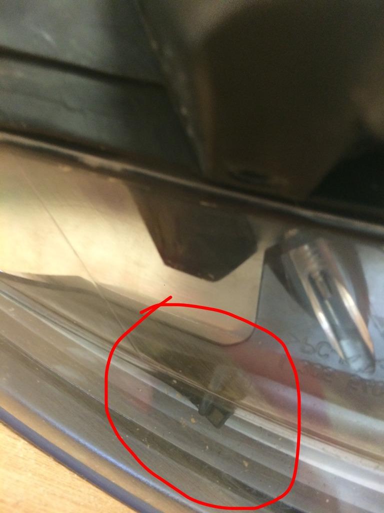

Luckily the headlights are awaiting installation, I was just putting fresh bulbs in beforehand! All I did was wiggled the headlight until the bulb was visible when looking head on...

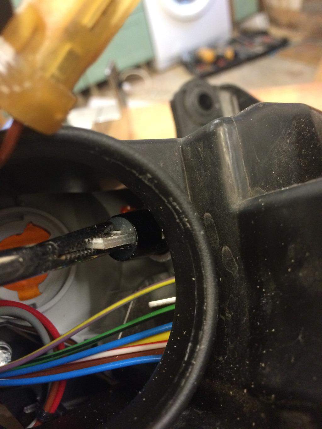

Grabbed the little bugger with some Biopsy Forceps...
And pulled it out!

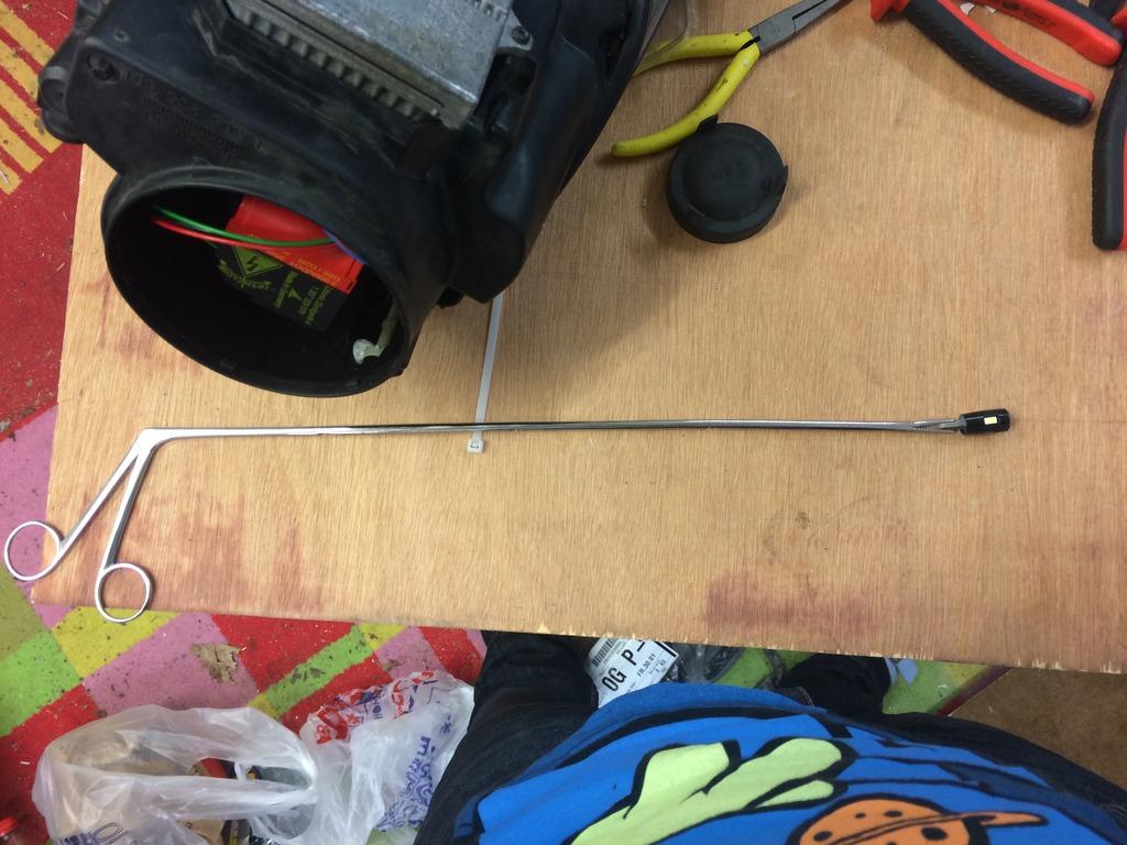

I was lucky enough to grab this one when we were having a clear out at work! It's really good when it comes to wiring! They can be priced anywhere between £10 and £500, depending on the brand and age...
