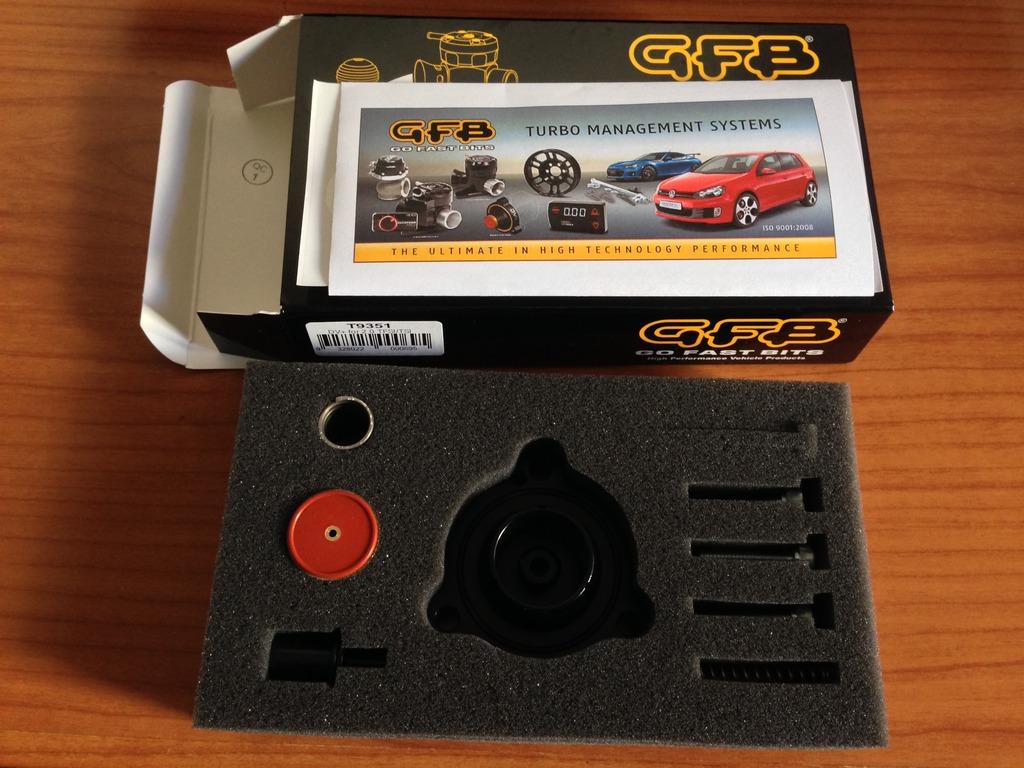

Just ordered the GFB+ DV and I have the price for the parts from VW. Just waiting to know if a friend can get them a bit cheaper.

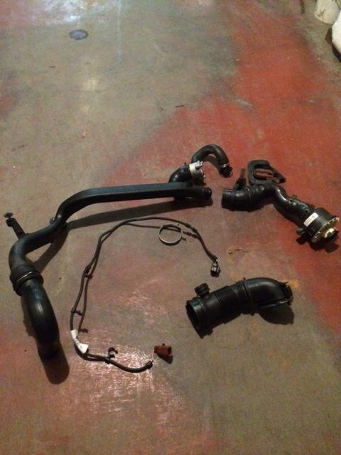

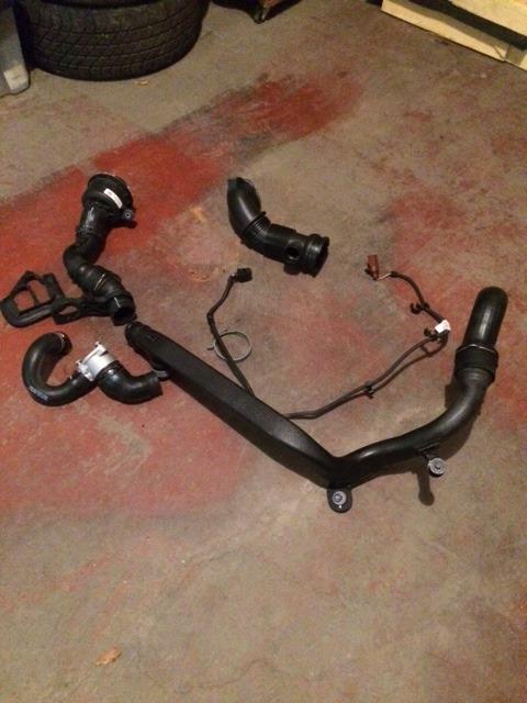

I've mounted the bracket for the DV relocation yesterday.
You are right there's only 1 bolt and 2 nuts! Now the nuts you don't need to buy them because they are already mounted for the other bracket wich holds nothing  :surprised:
Anyway  this is what you asked me :laugh:
I also took some pic's from the parts I removed wich are no more needed.
:wink:

Today I went to the Post Office to pick up the GFB DV+. Just waiting for two hoses to arrive from VW to see when I can do the relocation of the DV. :smiley:
RBS
 :thinking: Now where have I seen this lovely pieces of kit before? :drinking: :congrats: :congrats:              :happy2:
