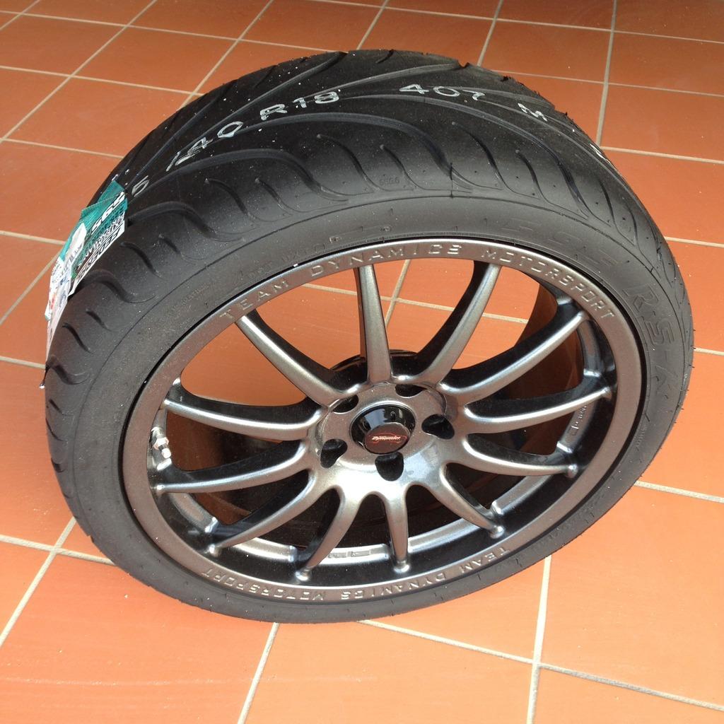

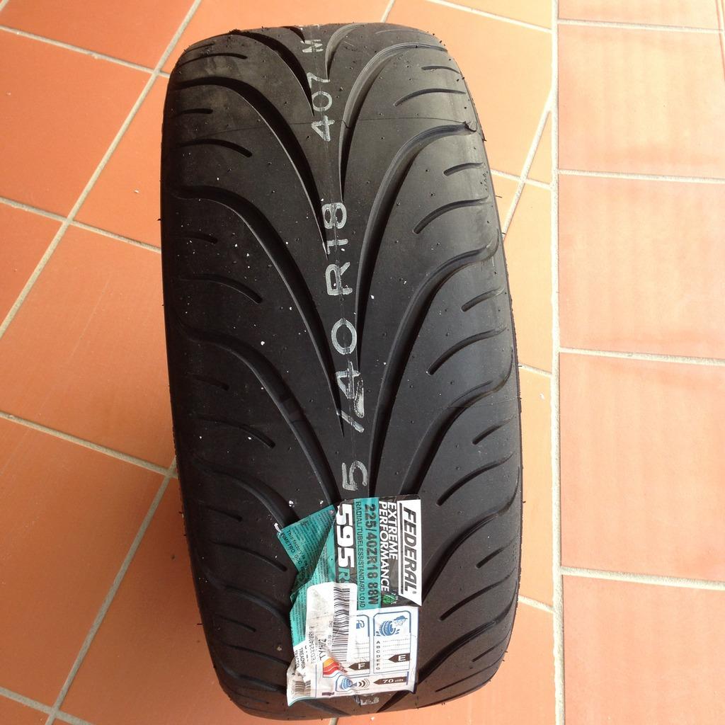

« Reply #393 on: December 09, 2016, 07:03:11 pm »

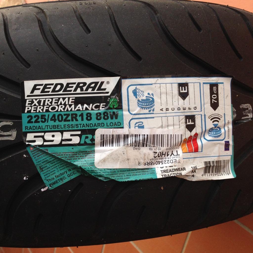

Decided to take a picture of one of the new wheels and tyres. I won't be needing them until February, when the 1st track day of next year should happen. :smiley:

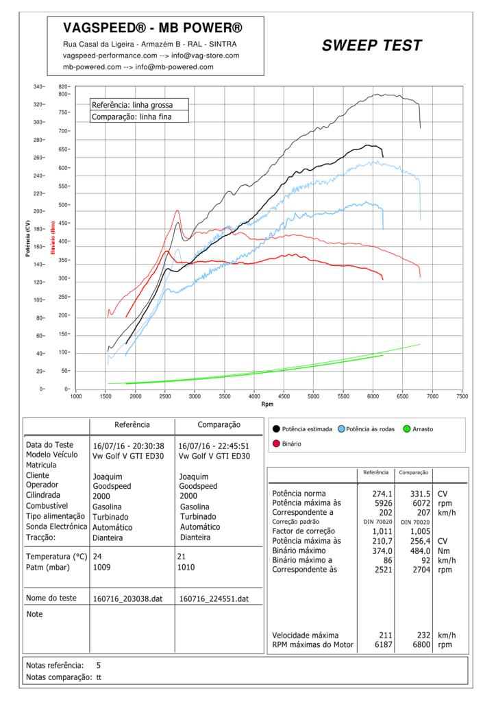

Only yesterday I got the dyno graphs from last July when I had the DSG tweaked. The tuner at the time increased the available clamping pressure, made the shifting faster, deactivated the kick down on Manual mode, deactivated the auto upshift on Manual mode after hiting the rev limiter and increased the rev limit to 7.000 rpm.
With an IAT of +35ºC, since the ambient temp was around 25ºC that night, the engine made the same top output as it did in January when was colder. :smiley:

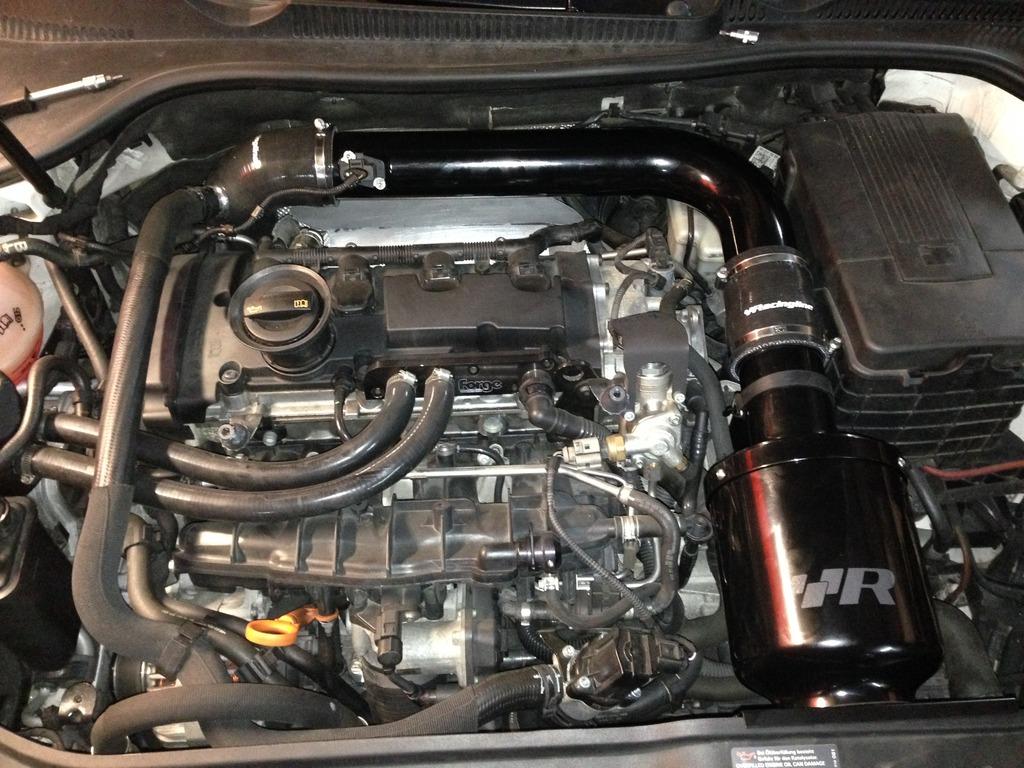

Today I got the parts that I recently bought fitted:

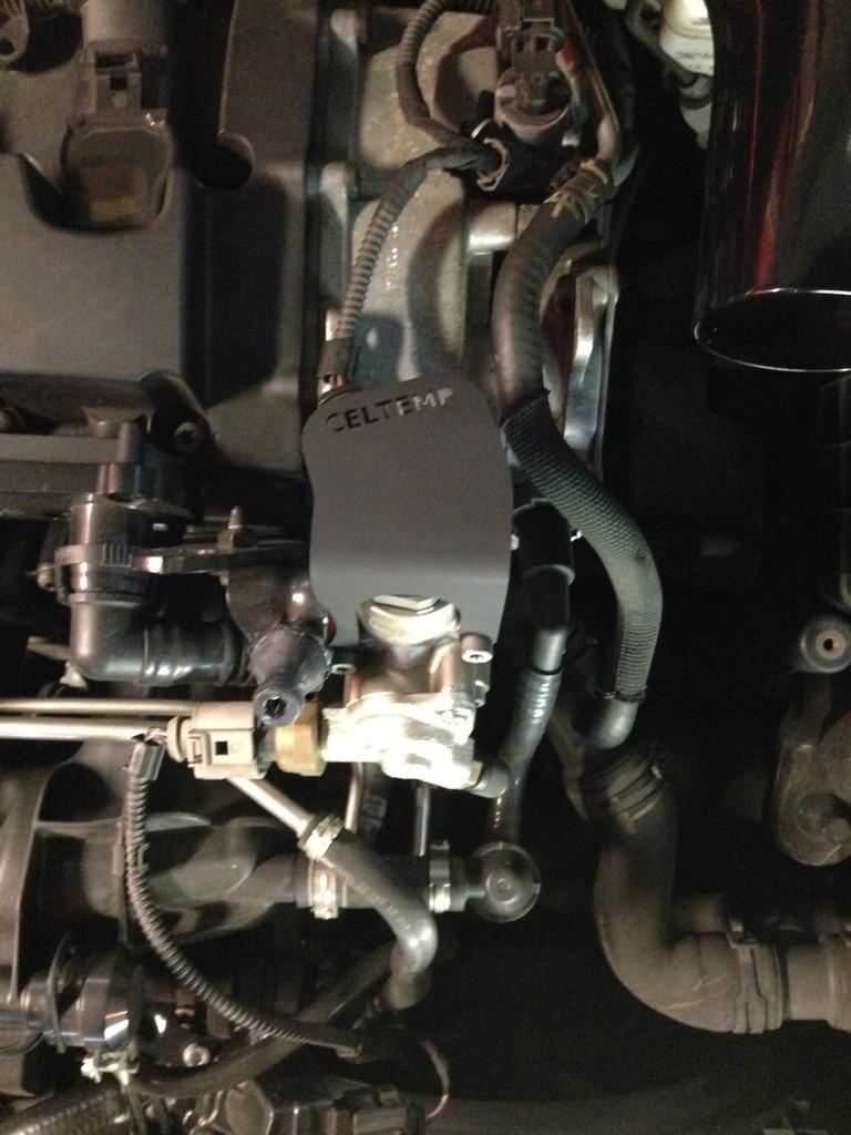

-Celtemp HPFP protection shield
-VW Racing intake for K04
-Custom painted TTS engine cover
-VW Racing adjustable front drop links
-Go Fast Bits lightweight crank pulley
I didn't take a picture of the GFB crank pulley but it's much lighter (1,4 kg) than the OEM part. It comes with 6 new bolts. :smiley:
The included bolts had different sizes. One was too long and the other was the same size as the OEM bolt. So I kept the OEM bolts and I'll make a complaint to Celtemp. :fighting:
The closed cone bracket on the grill had to be trimmed a bit due to the larger IC so that the bolts could be screwed. Other than that all fitted nicely. :smiley:

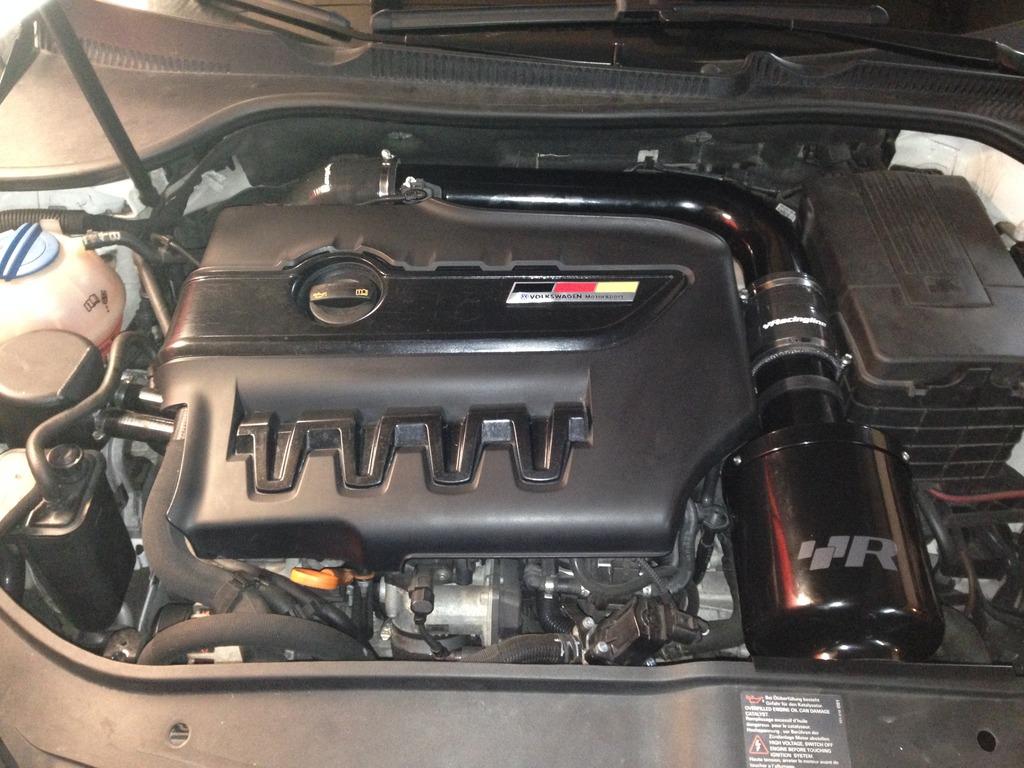

Final result! The engine bay is a bit black but it contrasts with the white car. I like it! :grin:

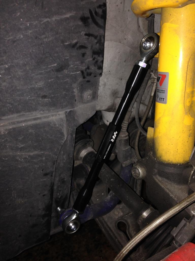

Both factory drop links were ruptured so it was a good call to get them replaced with better parts now. :smiley:
So far I'm liking the new engine sound. It has a deeper roar a bit louder than before. It makes me want to boost the engine more often so the louder sound is exciting. :driver: It's quiet on normal driving which was also something I was looking for. :smiley:
The engine seems to rev better on higher rpm and the butt dyno is happy with the new intake. I hope when I get the car dyno tested again the result is better too. :smiley:

Like the look of the VWR Intake, I can imagine it offers the best of both worlds....Less restrictive then the OEM Airbox but still pretty quiet compared to an Open Air Intake :)

Sorry to Shoduchi for cluttering up his build thread, but yes - from experience, the VWR intake is very expensive, but it is just simply just the right amount of whoosh, chatter, and quietness.

Thank bonelorry! I'm quite happy with the new increased roar on full boost and quietness during normal driving. I can hear just a bit more the DV+ chatter but nothing that I'd consider annoying. Now I need to see what difference does it make on a dyno sheet but since my K04 is only making 1.4 bar of stable boost I'm not expecting a very big increase, really. I do hope there's some difference since the car pulls well. :smiley:
The TD Pro Race 1.2 were the obvious choice since they cost me less than half of what the OZ did. They should clear the calipers even better too. :happy2:

Only question is on the dyno chart what's the odd looking flat spot at 2500rpm?
