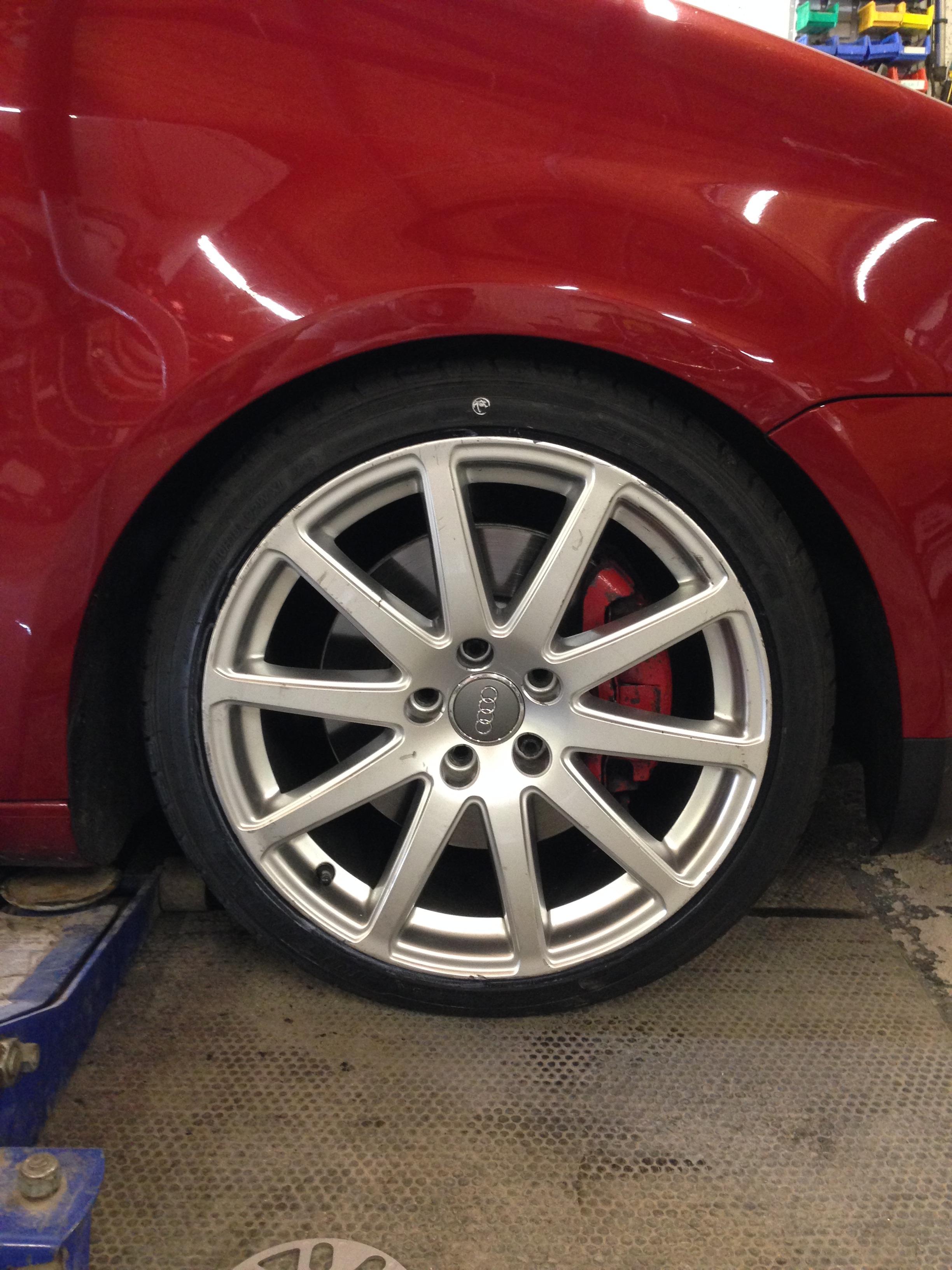

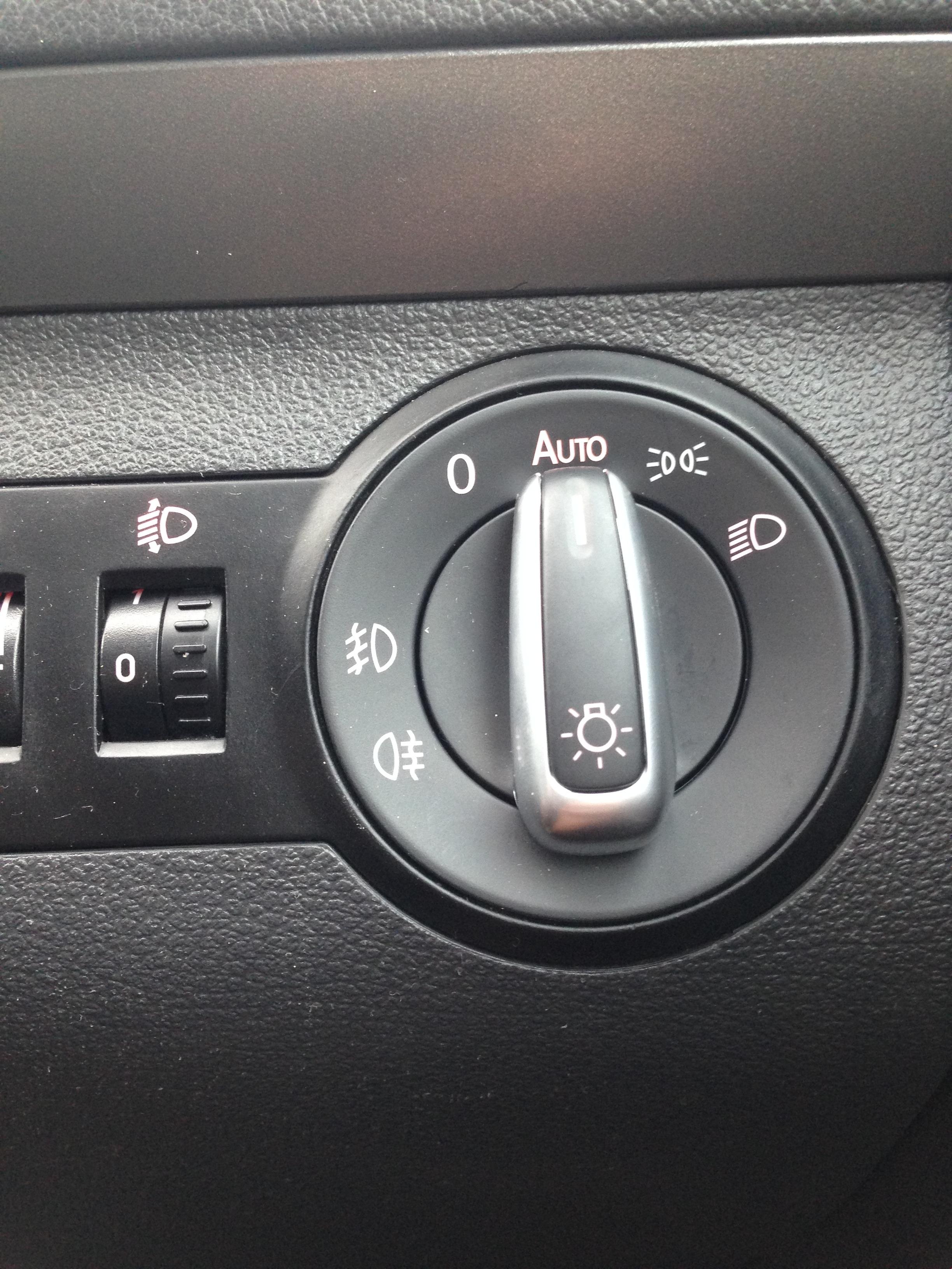

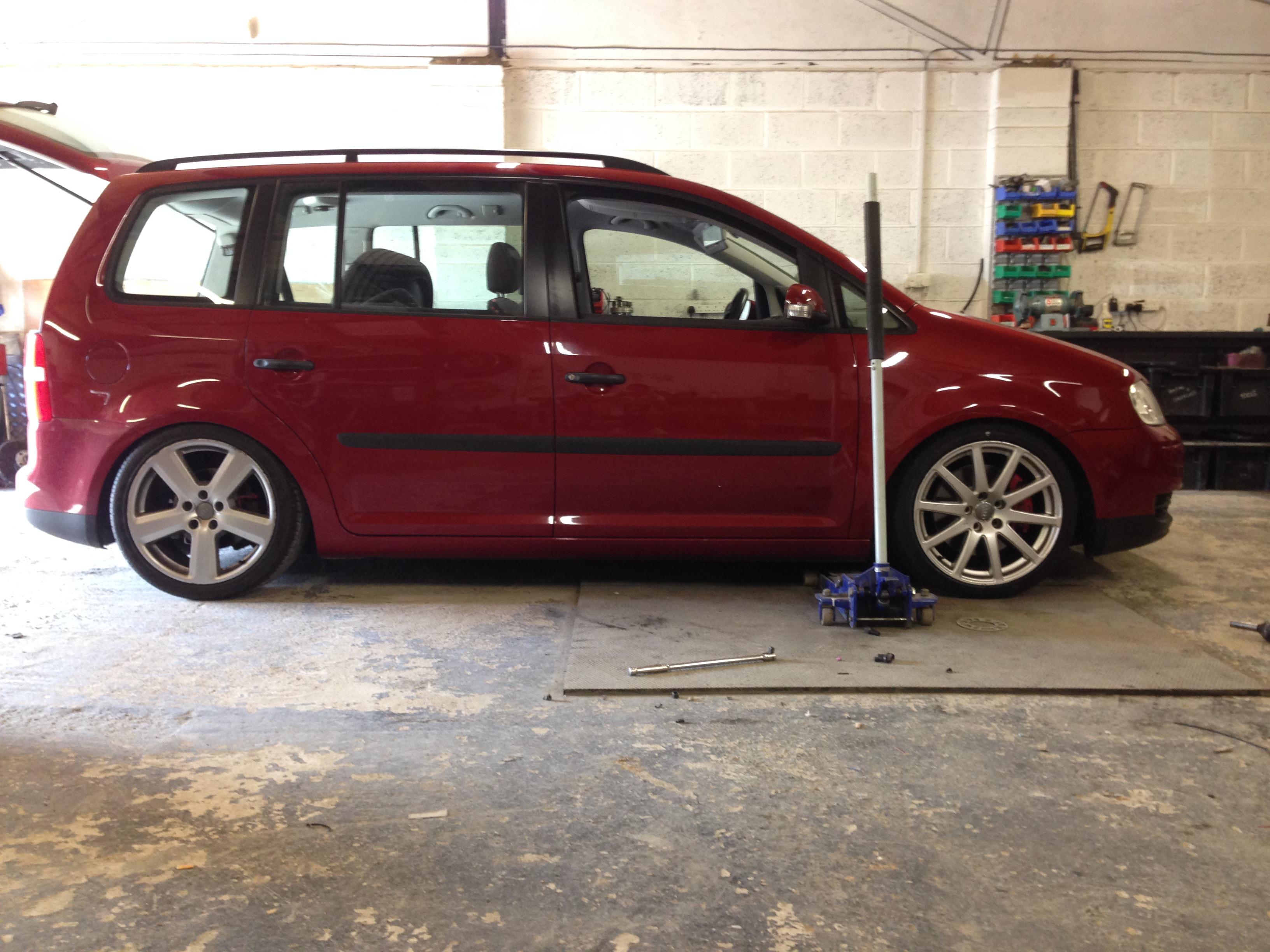

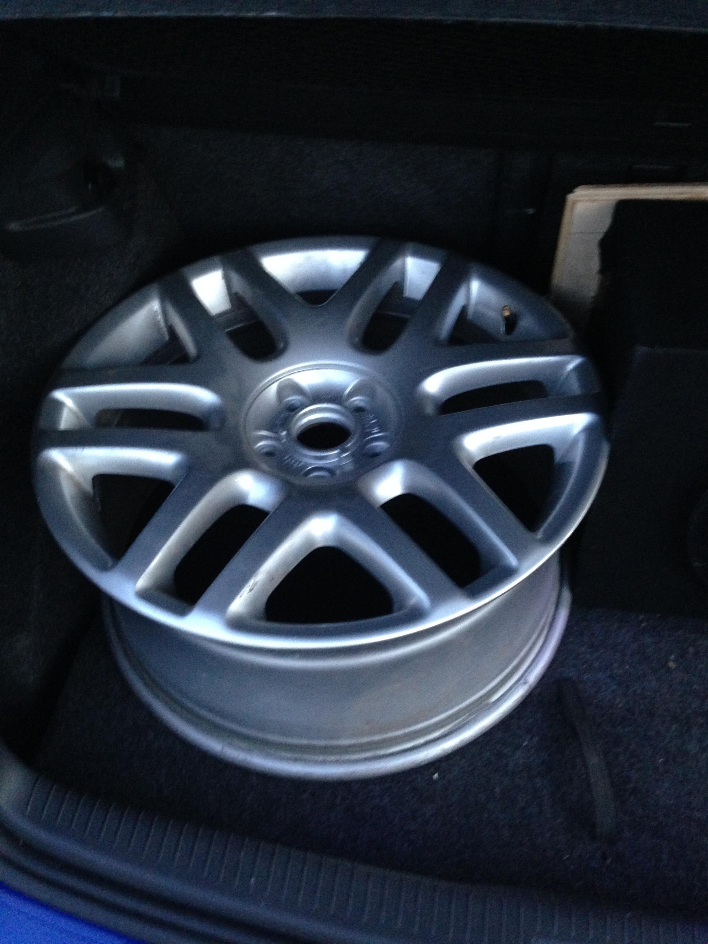

Picked up the tt speedlines
Tried one on
Didn't like them at all so put them back on ebay
Fitted my new AP that arrived thursday after ordering wednesday afternoon  :happy2:
And some 19x8.5 helios
Also an auto headlight switch

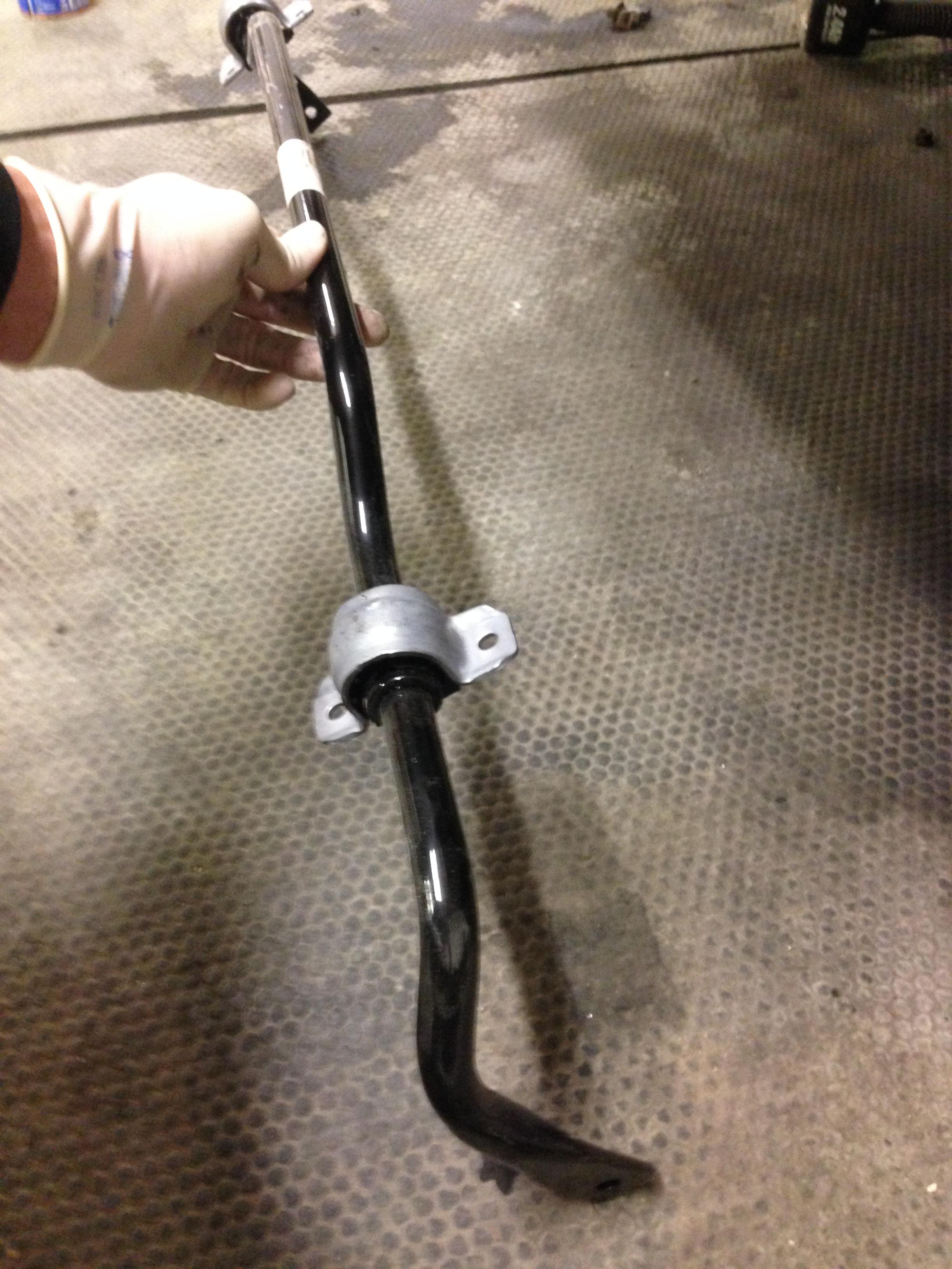

« Reply #28 on: April 27, 2015, 09:22:22 am »

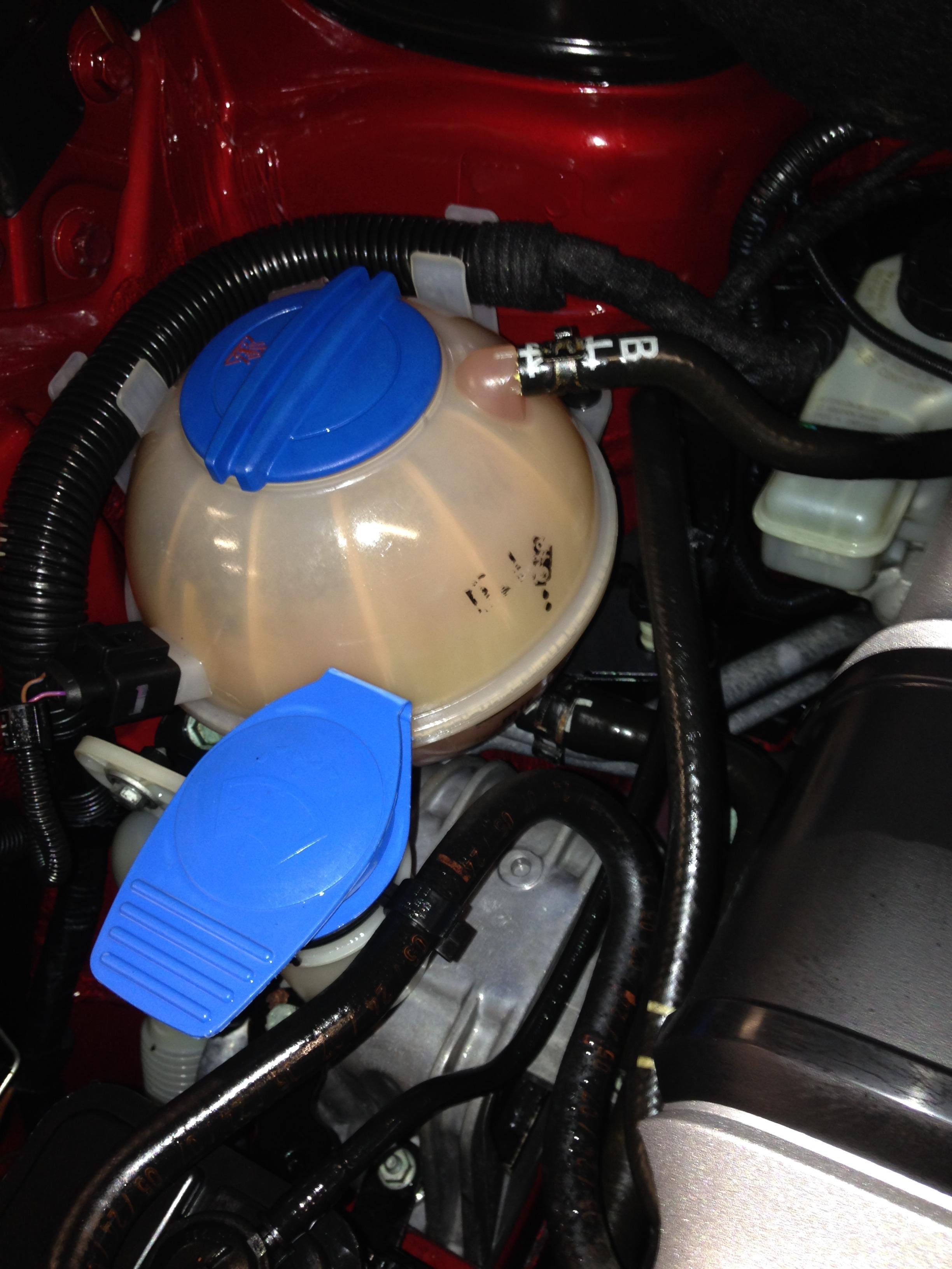

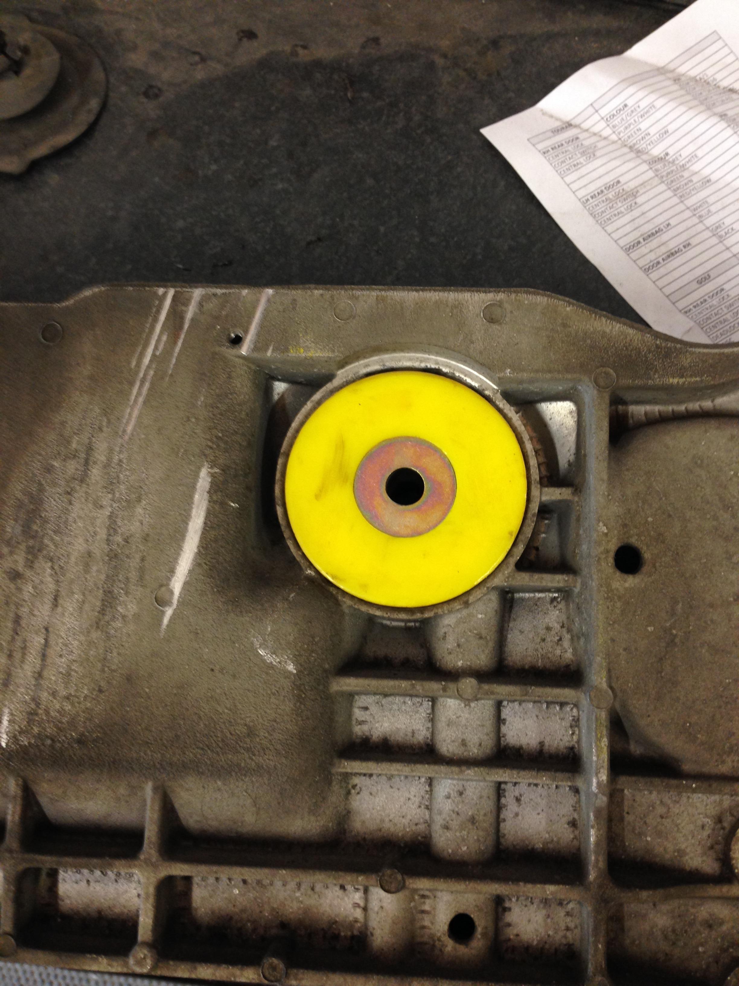

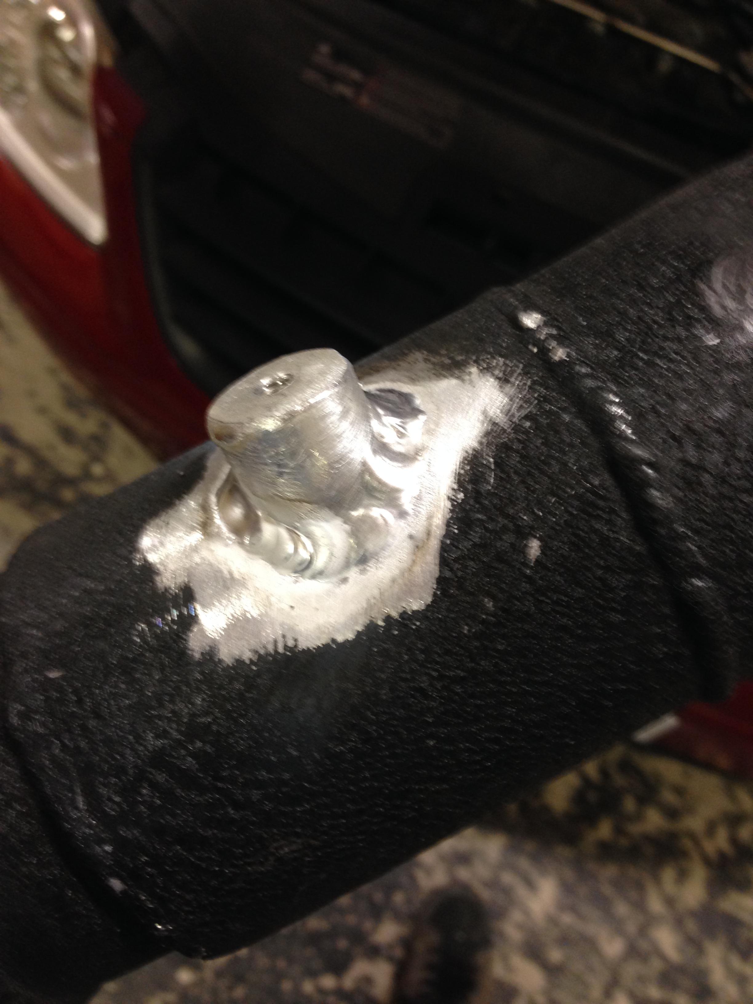

A few things happened in the last week....

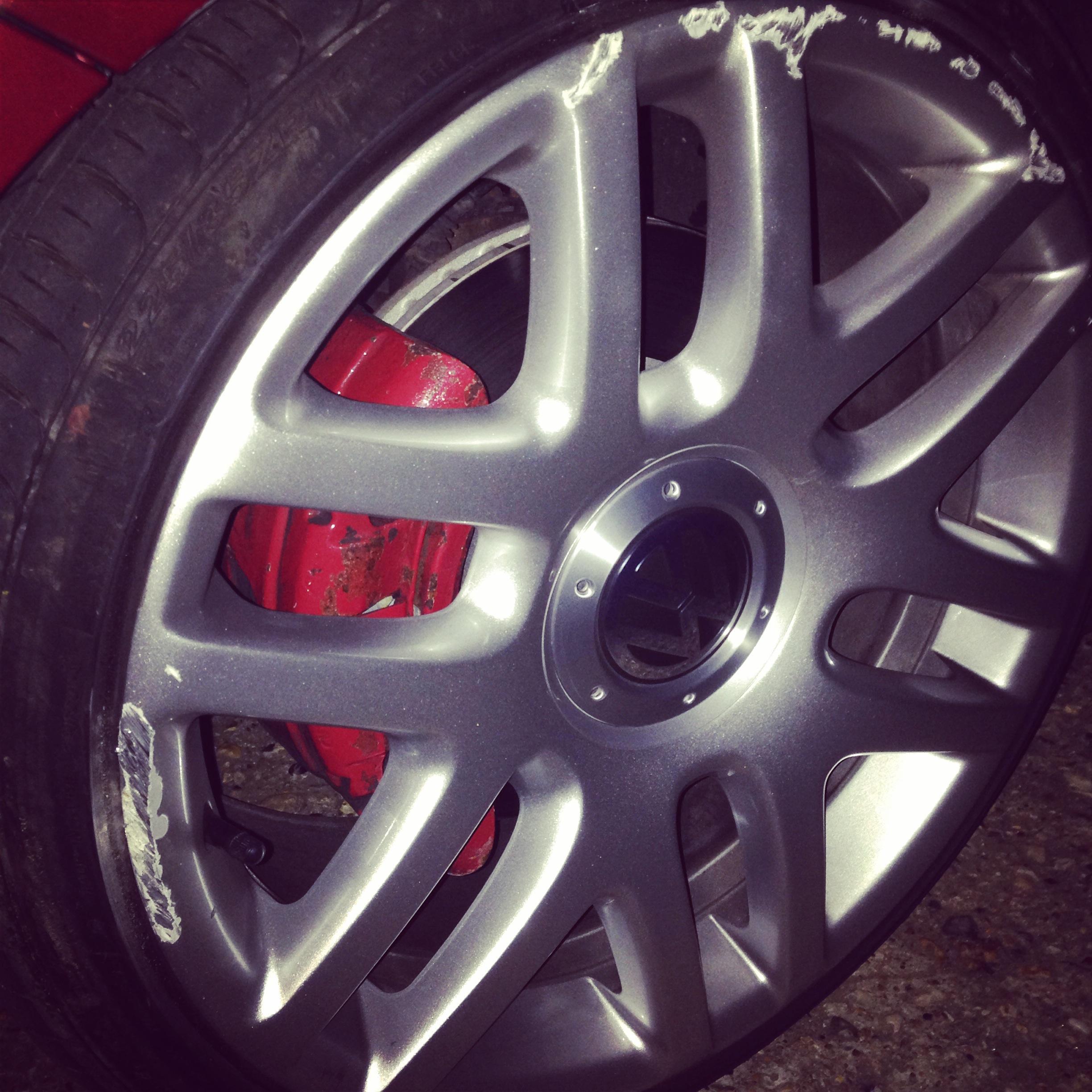

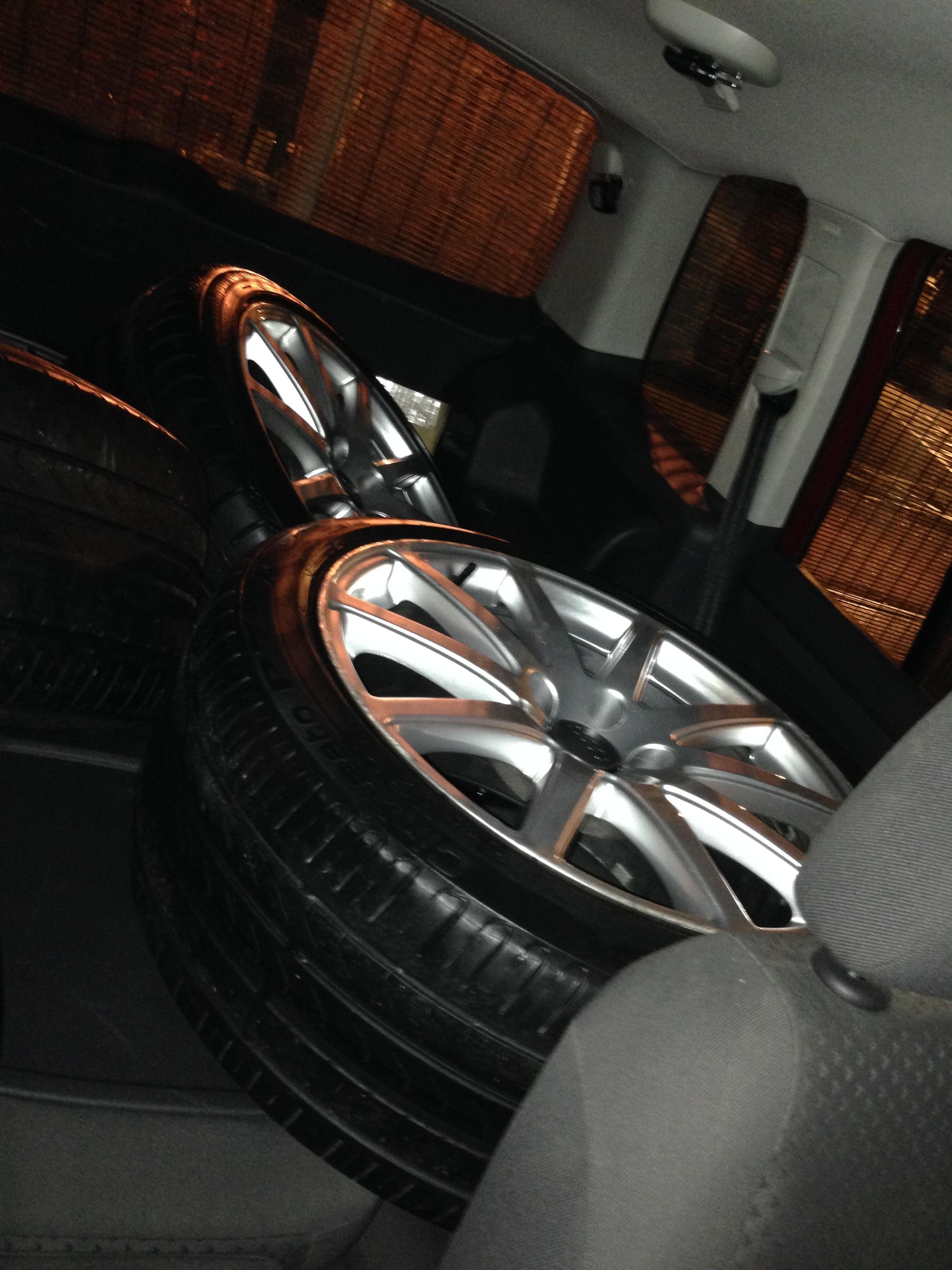

Polish woman nearly had a head on with me, she was coming around a turn at high speed on my side of the road at night, only option was to throw it up the verge / curb
Luckily the guy i bought the wheels off had a fifth and dropped it down to me

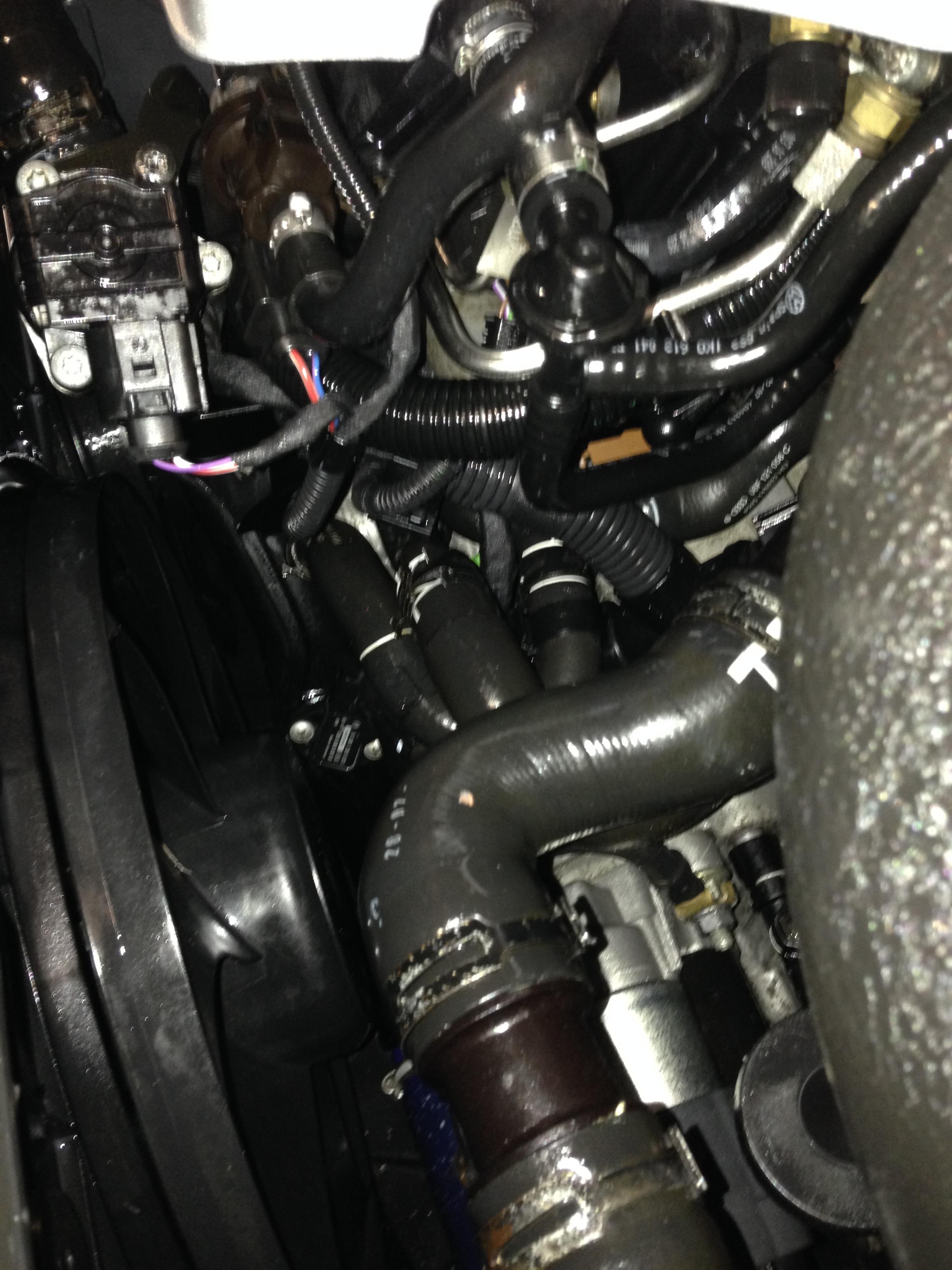

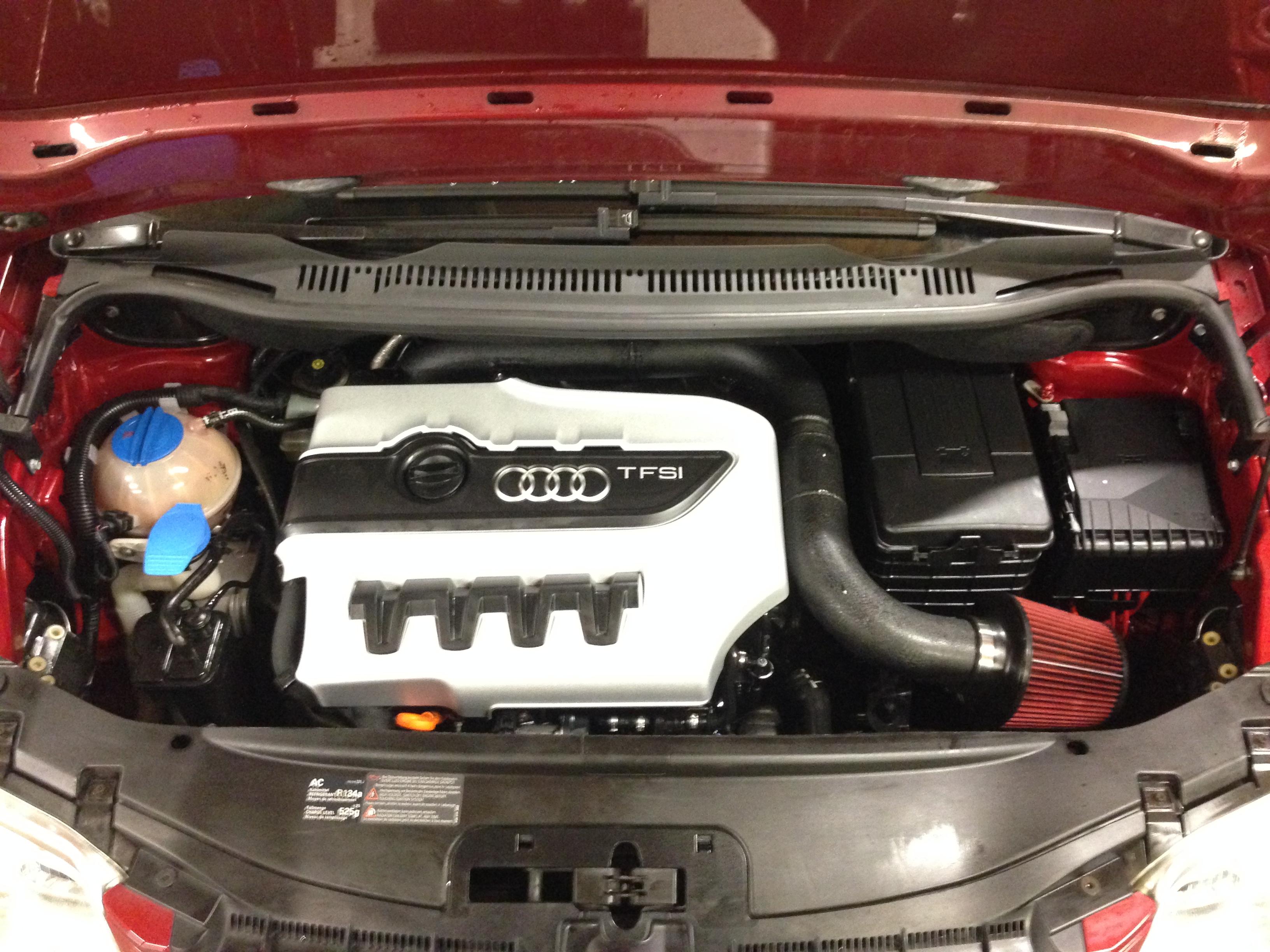

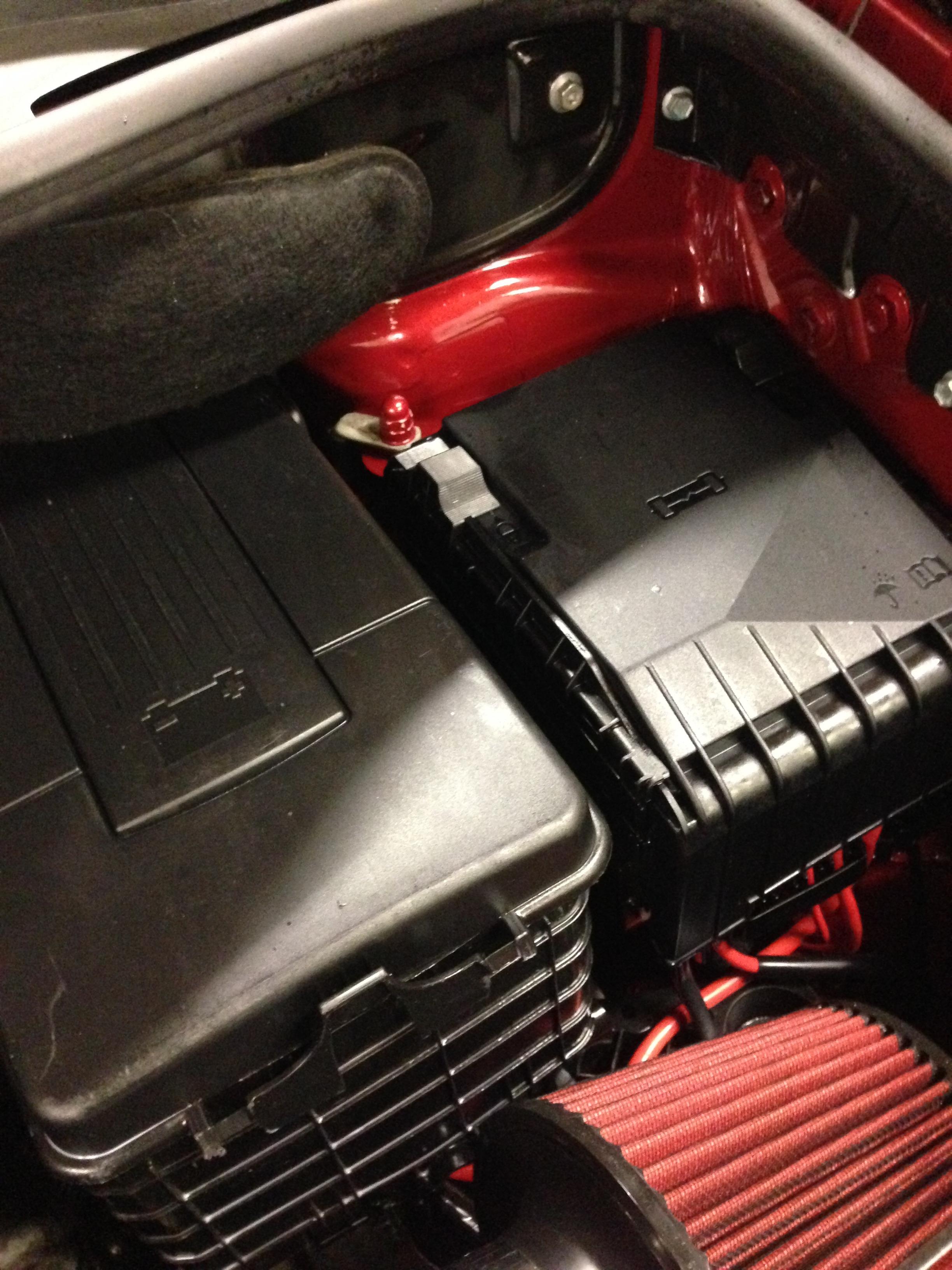

Made a mount for intake
Washed engine bay

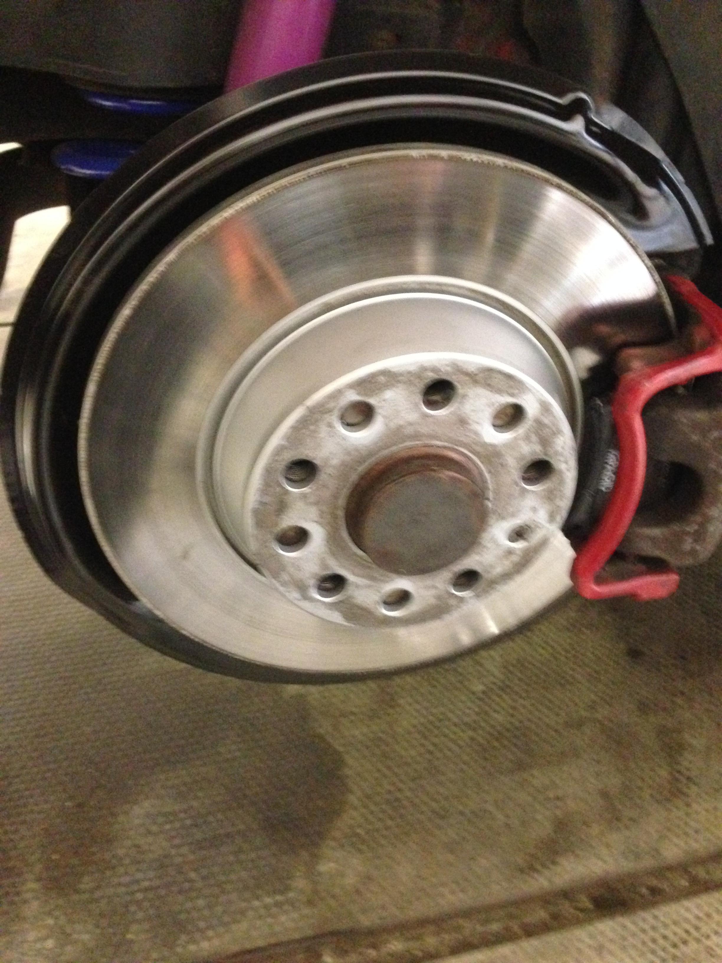

Fitted powerflex bone bush
Fitted passat r36 rear arb

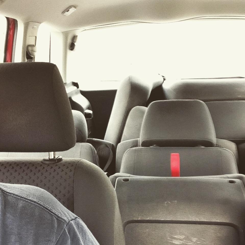

And gti rear splash guards

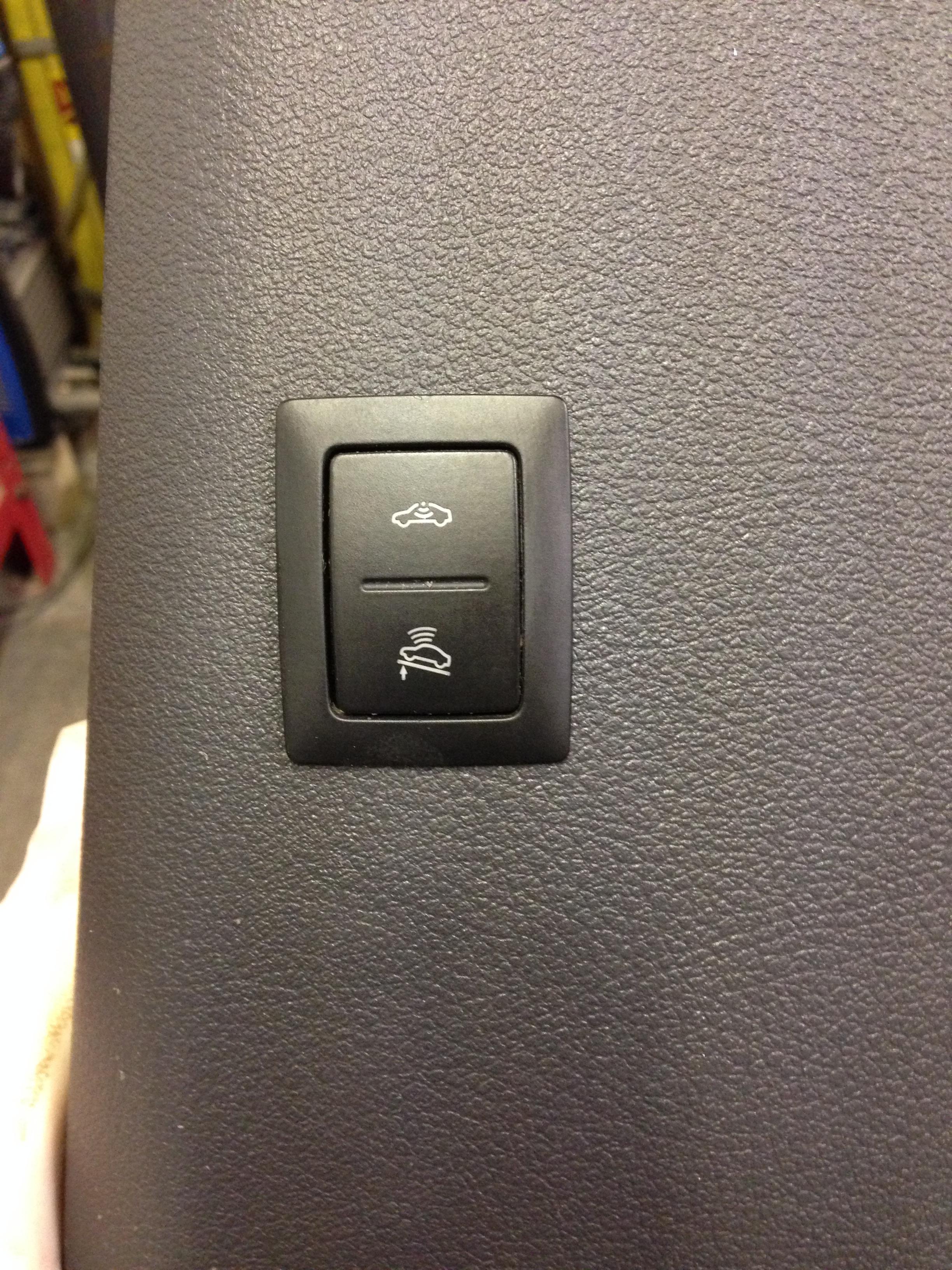

Mk5 interior monitor button arrived from ebay so dropped that in

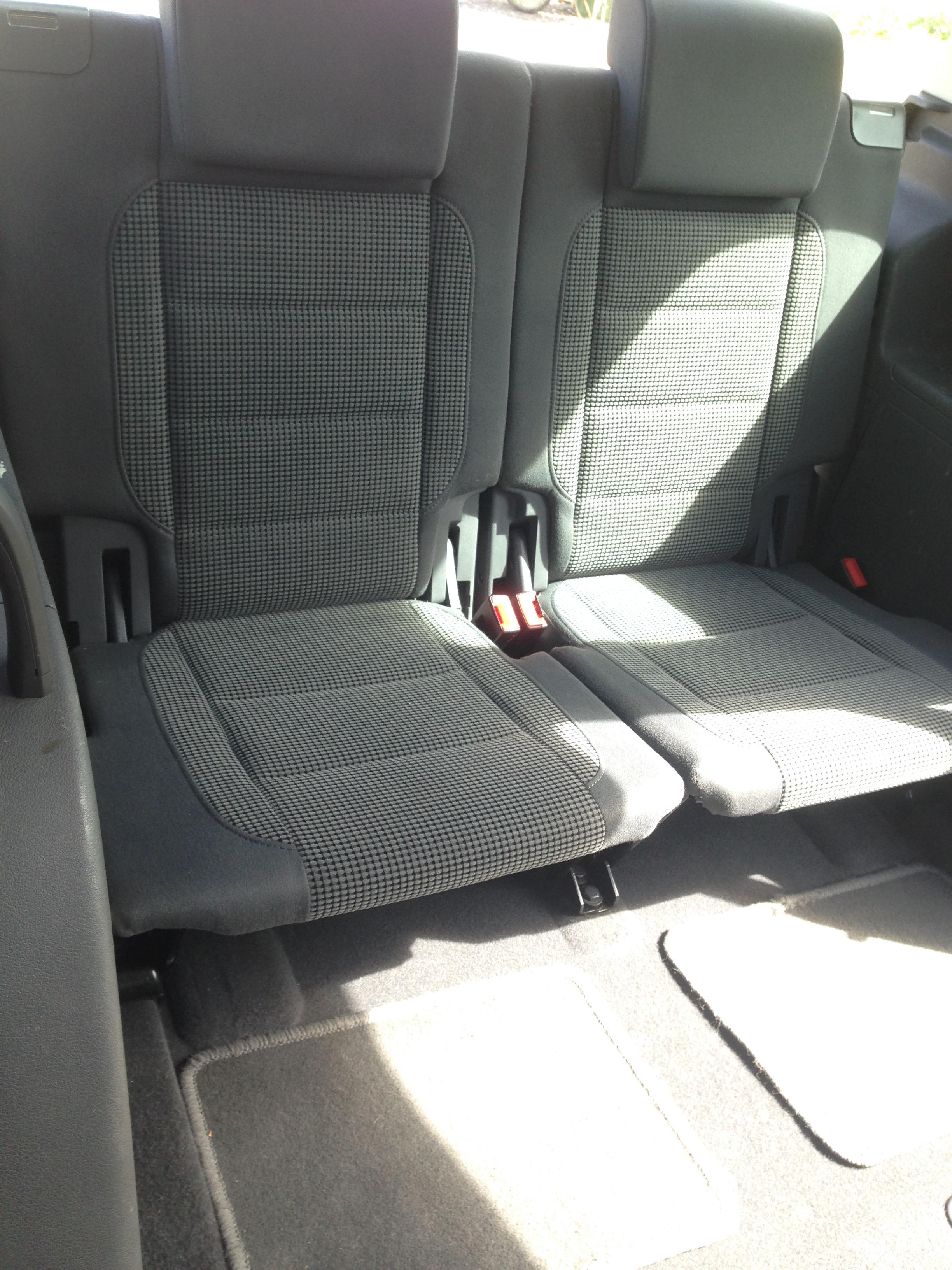

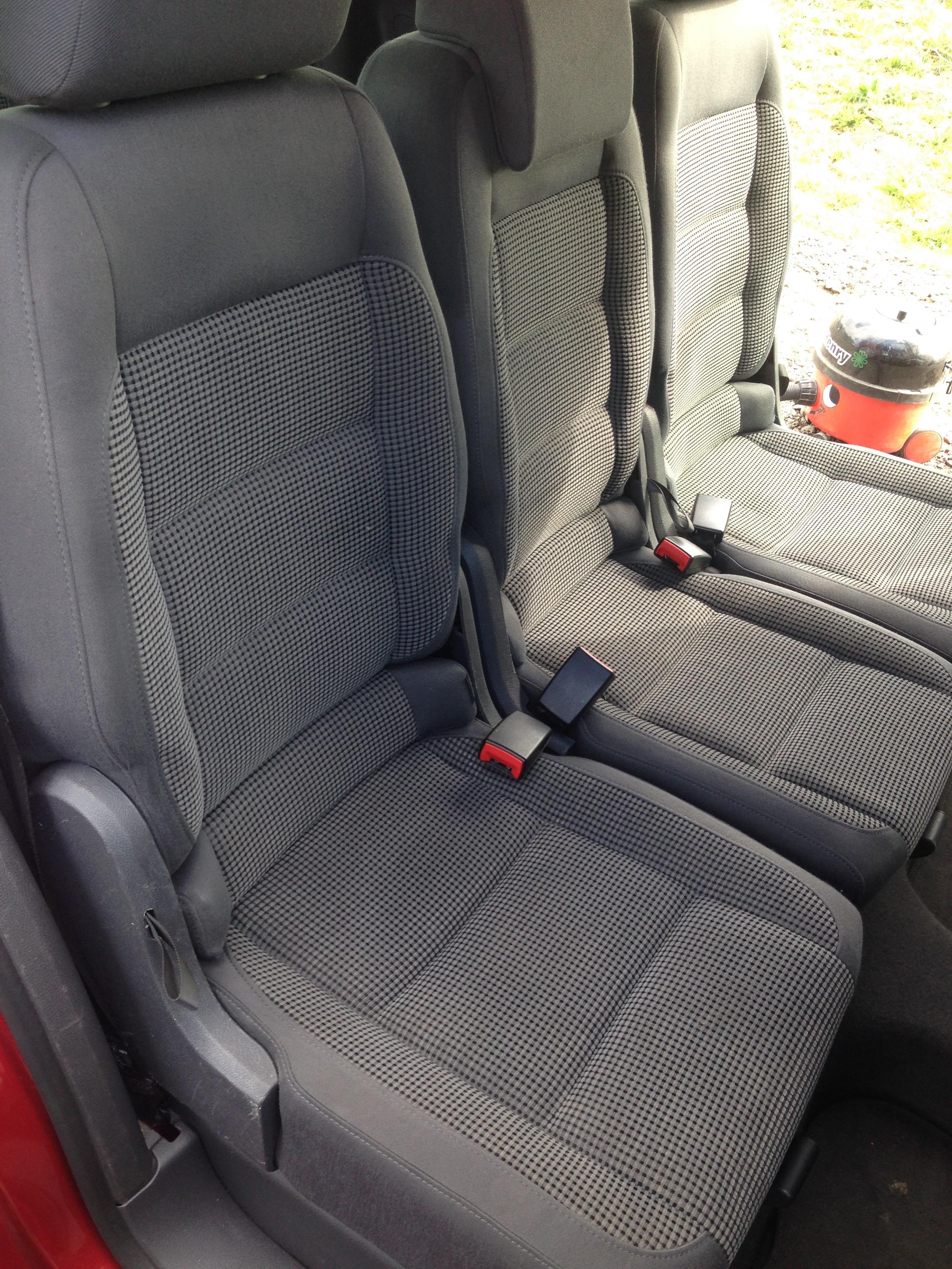

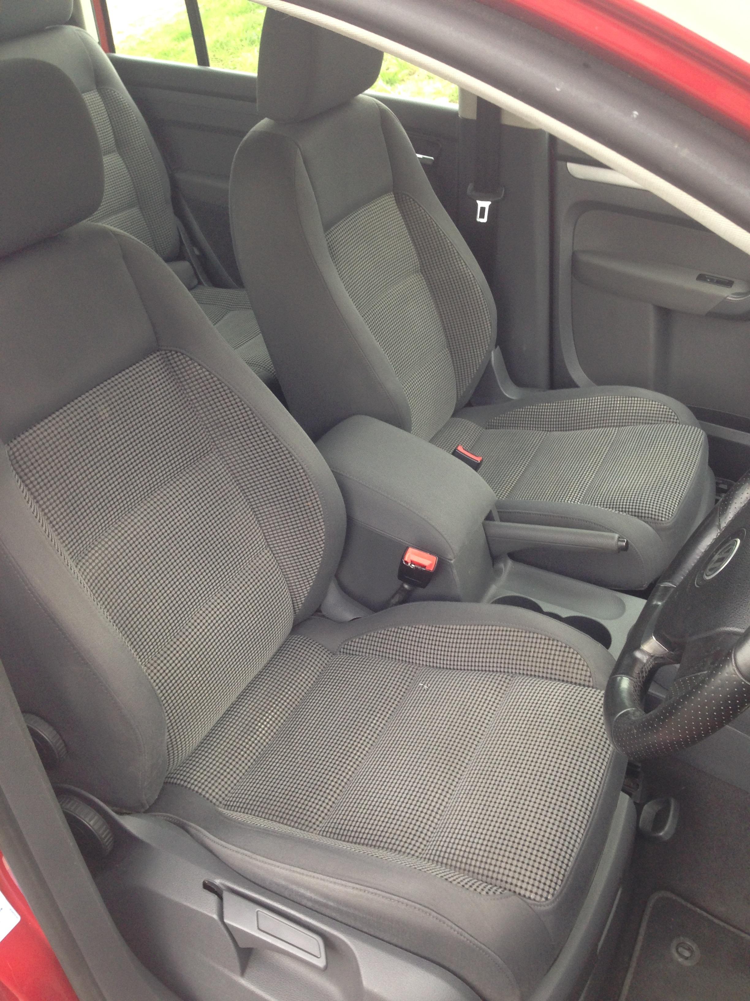

Collected some touran sport seats off ebay
New vs old
All in

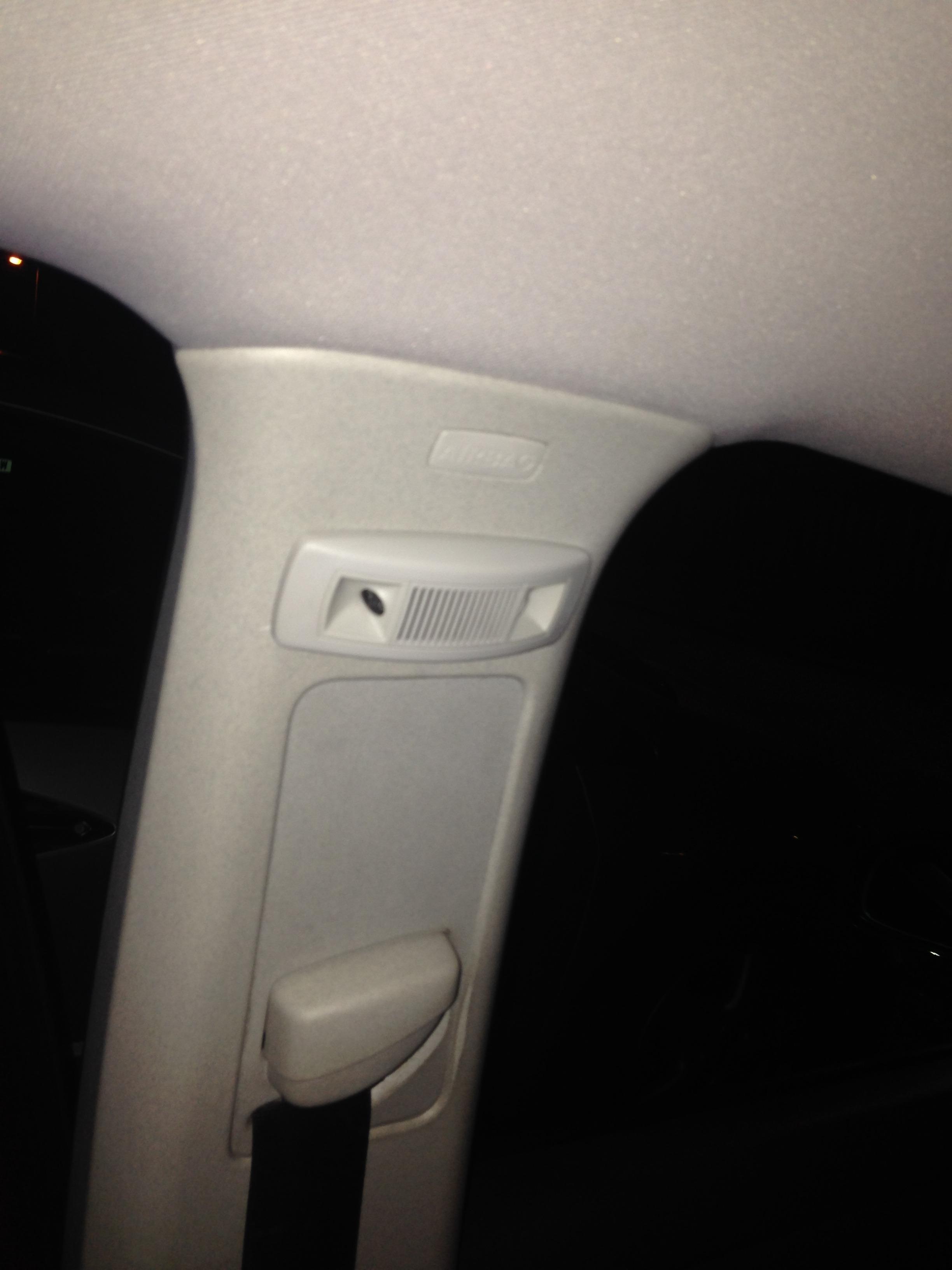

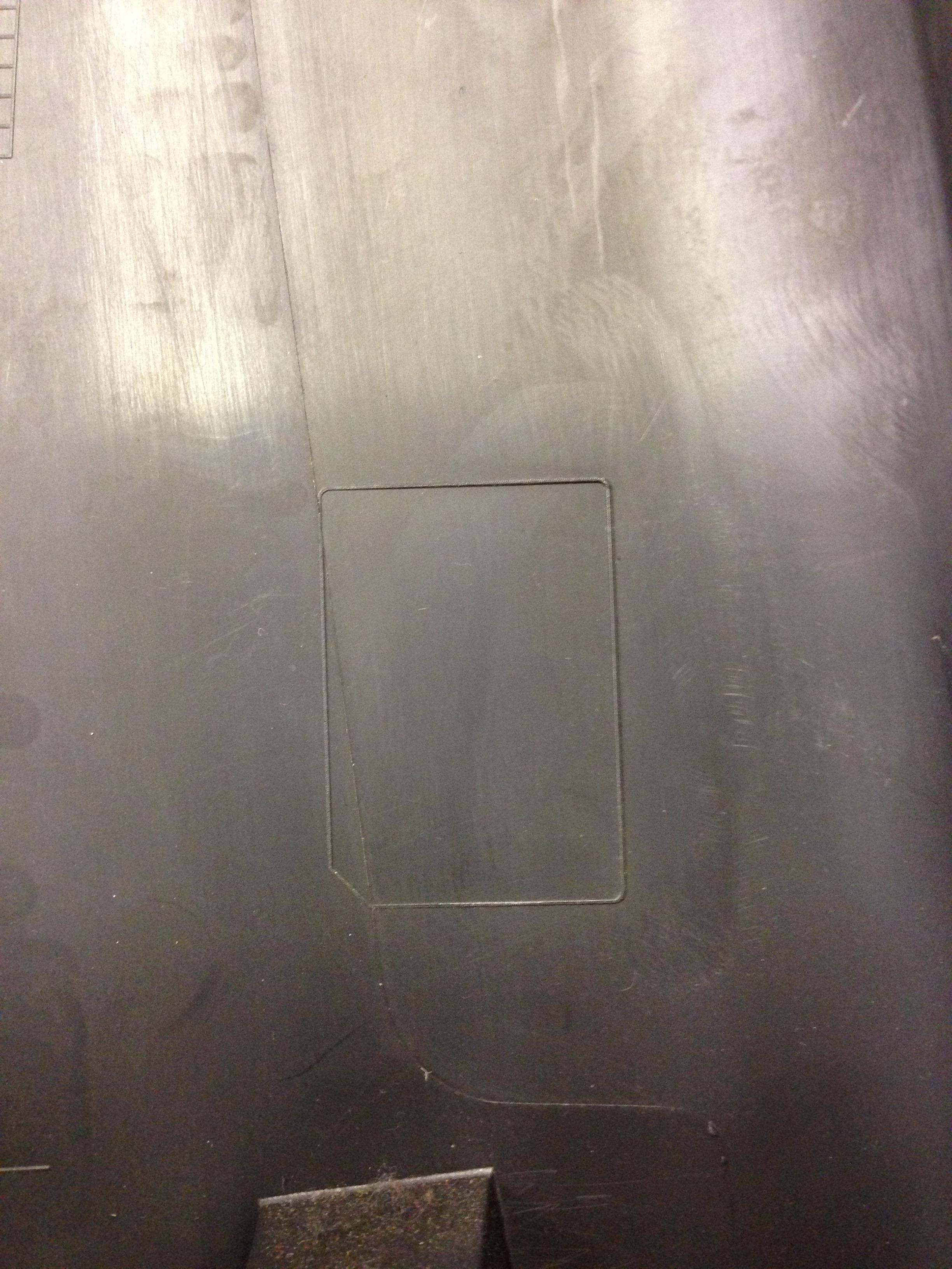

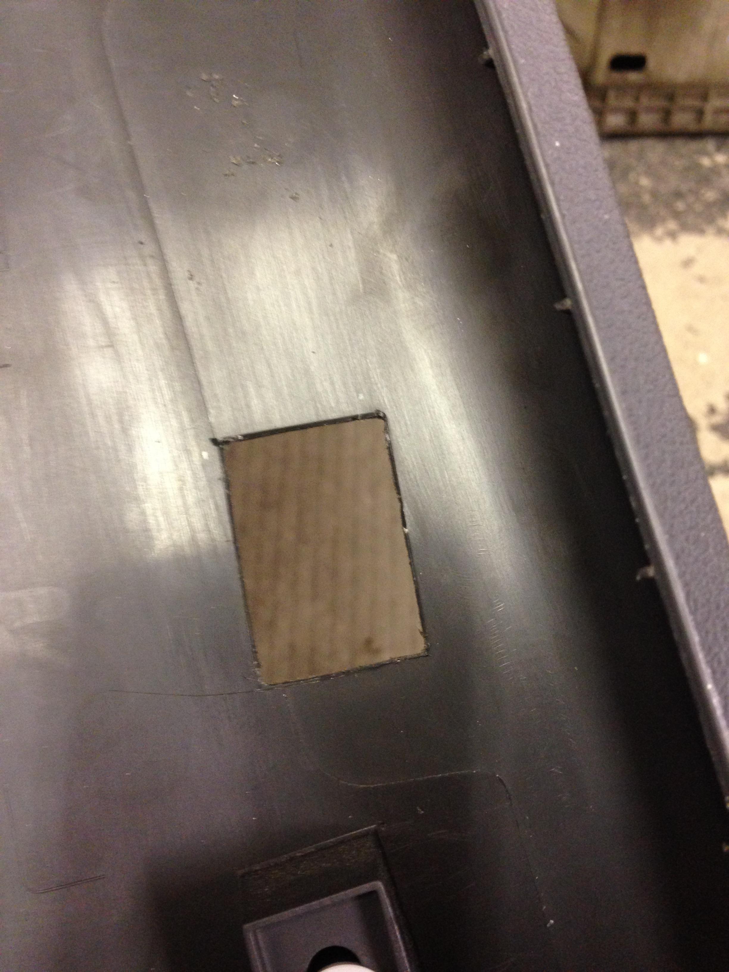

I also wired in and fitted mk5 alarm sensors (unfortunately no room in the headliner)

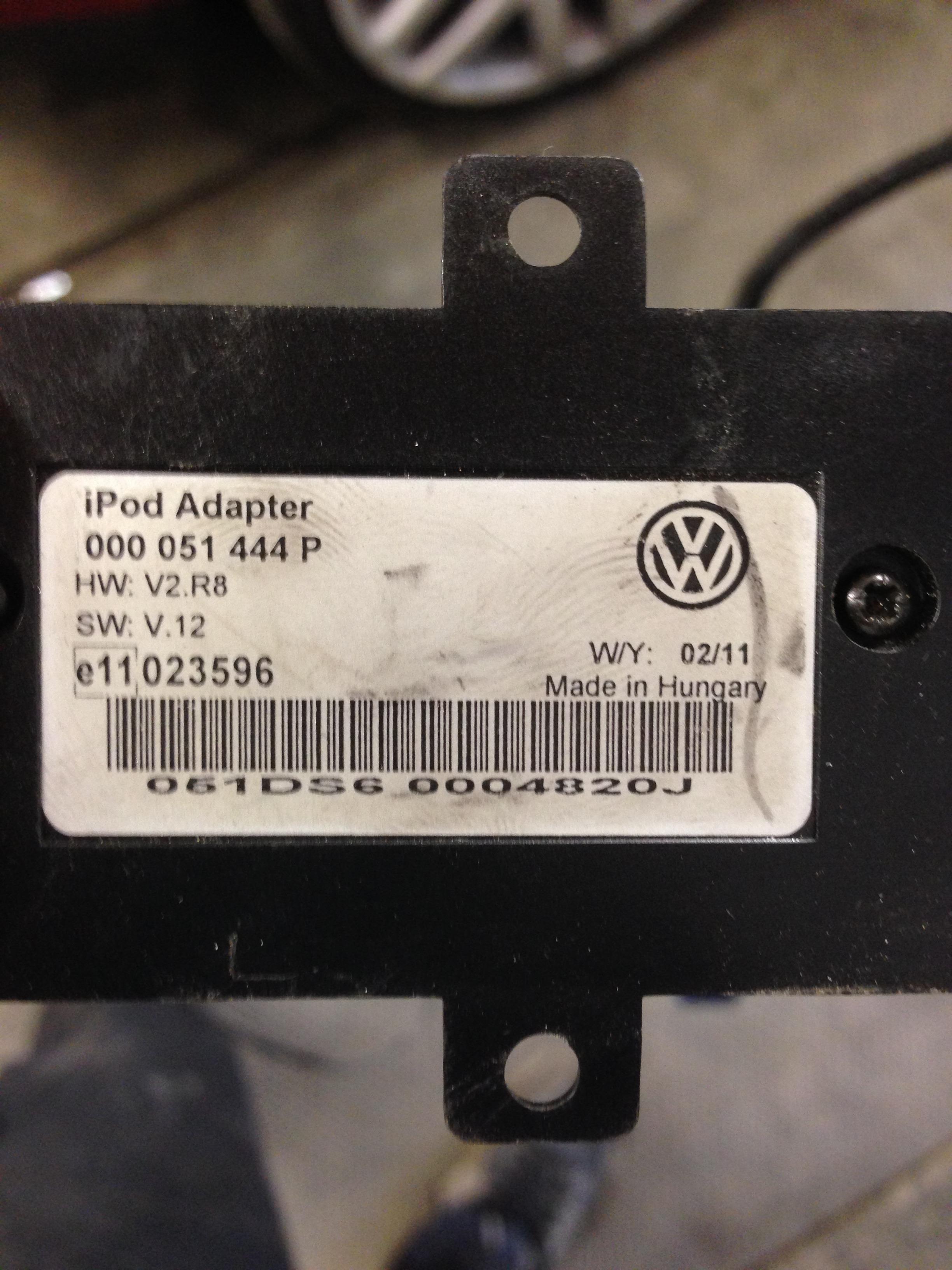

I wired in the rain/ light sensor too but waiting on special order parts to complete installation, i found this in a box of random parts from the mk5 so i've ordered adaptor lead to see if it works
Touran TFSI Quattro | stage 2+ BHZ | UK's first
