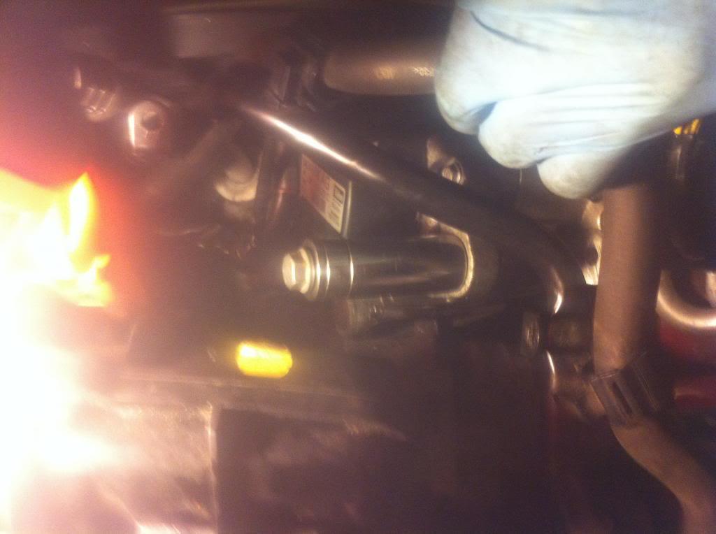

« Reply #1 on: February 22, 2016, 02:07:52 pm »
Yes there is a solution!! You need to draw the shims back out the way using a large deep socket and tighten the bolt through to pull them back through

« Reply #2 on: February 22, 2016, 02:10:37 pm »
Photo above is a bit busy, as I had the same issue when trying to reinstall the alternator, so did this in the bay.
You can see behind the socket is the black electrics of the alternator.

« Reply #4 on: February 22, 2016, 06:35:17 pm »
Im glad theres a solution but I'm massively confused now lol. The angle of your photo is puzzling me! The problem on mine was the shims on the right hand side which are harder to access than the left.  Are you saying they can move? So if I thread a bolt into it with a deep socket in between as leverage it wil draw it out and allow the alternator to squeeze in easier?

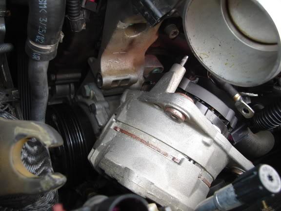

« Reply #6 on: February 22, 2016, 07:10:06 pm »
The pic posted earlier is the back of the alternator which had me confused at first.
Here you can see the shim (or whatever its called). You draw it or push it out. Then it fits on the mounting better you can also see the mounting in the back of the photo. (this is not a GTI but you get the idea).
05 | Tornado Red | DSG

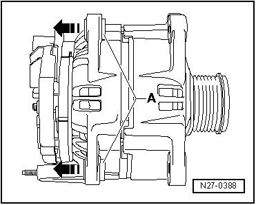

« Reply #10 on: February 22, 2016, 07:58:08 pm »
Thanks guys, although the it was only an idea I stole from someone else  :innocent:
I was in the same boat as @Patrick2691 and couldnt for the life of me get it back in, and after 2 hours changing the thermostat was a bit frustrating! But found that solution and was pretty relieved, could believe I'd tried ramming in for 20min prior to searching for a solution. That's why the photos a bit crap as was last minute thought. Here a better diagram from VW
So if I remember correct seat the socket the same side as the above arrows and draw them back through with the bolt.
