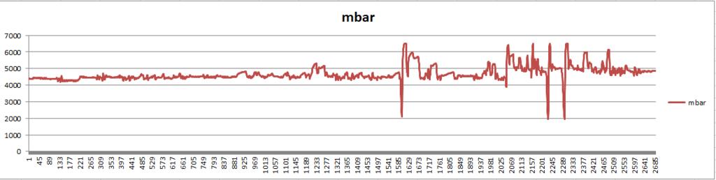

Hi guys,
So my cars been having issues with boost cutting out pretty randomly and intermittently. I logged block 103 as a starting point yesterday and these are the results. I really should have logged RPM's :/, I start the drive fairly moderately letting the car warm up before then using the boost and higher revs intermittently (where you see the spikes I guess).
Thoughts? Also the fault code logged was related to the low pressure fuel pump. The counter on it was something ridiculous like 255!
