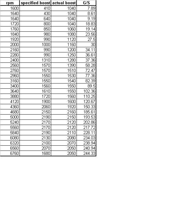

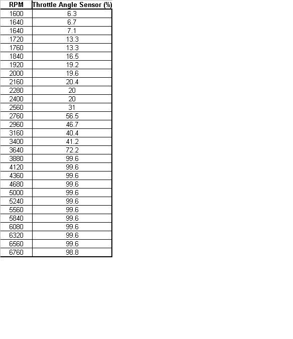

does the throttle register 100% when the ignitions on but engine off and foot down with VCDS connected ?

Offline subaru26675
  • Posts: 237
Re: New car on Tuesday ....Cited !
« Reply #141 on: December 14, 2009, 05:43:30 pm »
Not sure best way to get my log on here, this is not very good AT ALL !!! :ashamed:

« Reply #142 on: December 14, 2009, 05:47:45 pm »
sorry cant read that !
angle should be 99.x% at the point you go WOT (whatever revs your run starts at)  :happy2:
youll have to tell me if it does

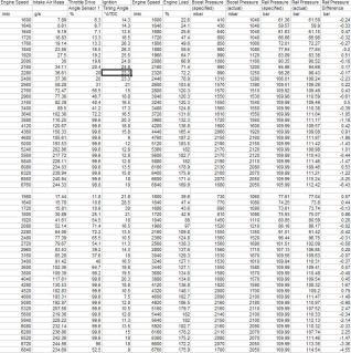

Offline subaru26675
  • Posts: 237
« Reply #143 on: December 14, 2009, 06:01:39 pm »
I know this is difficult to read but you can see the throttle angle does not go to 99.6% until 3880 RPM.  The throttle was burried from a very slow roll in 3rd gear all the way to the red line.

   160.36   6280   236.86   99.6   15   160.11   6160   178.2   2110   2070   160.23   109.99   107.74   2.25
   160.75   6520   242.36   99.6   18   160.5   6360   175.2   2080   2070   160.63   109.99   111.46   -1.47
   161.14   6720   244.56   98   18   160.88   6600   172.2   2070   2050   161.02   109.99   113.35   -3.36
   161.53   6840   234.69   52.5   9   161.27   6760   175.9   1700   2050   161.39   109.99   114.54   -4.55
   161.91   6720   56.31   8.2   13.5   161.65   6920   142.1   1420   2110   161.78   109.99   110.69   -0.7
   162.3   5920   16.97   12.2   9.8   162.05   6400   15   290   1500   162.17   124.82   124.82   0
   162.69   5080   16.36   11   3.8   162.42   5640   17.3   290   1220   162.56   125.36   125.36   0
   163.08   4960   17.36   11.4   3   162.82   5000   17.3   280   1140   162.94   125.56   125.56   0
   163.45   4920   17.69   11.4   3   163.2   4960   16.5   280   1120   163.33   125.65   125.65   0
   163.84   4600   17.08   11.4   1.5   163.6   4880   16.5   280   1100   163.72   125.65   125.65   0
   164.24   4040   15.14   10.2   -1.5   163.97   4400   17.3   290   1090   164.11   125.48   125.48   0
   164.63   3440   13.28   8.6   -3   164.36   3840   18   290   1100   164.49   125.45   125.45   0
   165   3080   10.61   7.5   -3.8   164.75   3000   18   300   1100   164.88   125.43   125.43   0
   165.39   3040   10.5   7.8   -3.8   165.14   3040   16.5   300   1100   165.27   125.36   125.36   0
   165.78   3000   10.17   7.5   -3.8   165.52   3040   15.8   300   1090   165.66   125.37   125.37   0
   166.17   2960   10.33   7.5   -4.5   165.91   3000   15.8   300   1090   166.03   125.25   125.25   0
   166.54   2960   10.53   7.5   -4.5   166.3   2960   16.5   300   1090   166.42   125.19   125.19   0
   166.94   2920   10.42   7.5   -4.5   166.69   2920   15.8   300   1090   166.82   125.13   125.13   0
   167.33   2880   10.03   7.5   -4.5   167.06   2920   15.8   290   1080   167.2   125.16   125.16   0
   167.72   2840   10   7.1   -4.5   167.45   2880   15.8   290   1080   167.58   125.04   125.04   0
   168.09   2800   9.69   7.1   -4.5   167.84   2840   15.8   290   1080   167.96   124.9   124.9   0
   168.48   2800   9.69   7.1   -4.5   168.23   2800   15.8   290   1080   168.36   124.89   124.89   0
   168.88   2760   9.64   7.1   -4.5   168.61   2800   15.8   290   1080   168.75   124.88   124.88   0
   169.27   2760   9.61   7.1   -4.5   169   2760   15.8   290   1080   169.13   122.2   120.81   1.38
   169.64   2720   9.67   7.1   -3.8   169.39   2720   15.8   290   1070   169.51   120.07   117.99   2.08
   170.03   2680   9.36   7.1   -4.5   169.78   2720   15.8   290   1070   169.9   118.04   118.98   -0.95
   170.42   2680   9.31   7.1   7.5   170.16   2680   15.8   290   1070   170.3   115.95   116.47   -0.52
   170.81   2640   9.19   6.7   -2.3   170.55   2680   15.8   290   1060   170.67   113.87   114.63   -0.77
   171.18   2640   9.33   6.7   -2.3   170.94   2640   15.8   290   1060   171.06   115.19   115.19   0
   171.58   2600   9.19   6.7   -2.3   171.33   2640   15.8   290   1070   171.45   115.42   115.42   0
   171.97   2600   8.92   6.7   -4.5   171.7   2600   15.8   290   1070   171.84   115.64   115.64   0
   172.36   2560   8.78   6.7   -4.5   172.09   2560   15.8   290   1070   172.22   115.85   115.85   0
   172.74   2560   8.44   6.3   -3   172.48   2560   15.8   290   1070   172.61   113.23   111.83   1.4
   173.13   2520   8.64   6.3   0   172.87   2520   15.8   280   1060   173   111.2   111.21   -0.01
   173.52   2520   8.67   6.3   7.5   173.25   2520   15.8   280   1060   173.39   109.34   109.61   -0.27
   173.91   2480   9.75   7.1   18   173.64   2520   15.8   310   1060   173.76   107.51   107.1   0.41
   174.28   2480   11.83   8.2   17.3   174.03   2480   18   390   1050   174.16   105.33   105.05   0.28
   174.67   2480   11.67   8.2   16.5   174.42   2480   21.8   390   1050   174.55   102.95   103.07   -0.12
   175.06   2440   13.22   9.4   16.5   174.79   2480   21.8   400   1060   174.94   100.2   100.23   -0.03
   175.45   2440   13.83   9.4   15.8   175.19   2440   24.8   440   1060   175.31   97.5   97.3   0.2
   175.83   2440   13.61   9.4   15.8   175.57   2440   24.8   440   1060   175.7   94.47   94.2   0.26
   176.22   2440   13.36   9.4   15.8   175.97   2440   25.6   440   1060   176.1   91.73   91.84   -0.11
   176.61   2440   13.61   9.4   15.8   176.34   2440   25.6   450   1070   176.48   88.78   88.25   0.53
   177   2440   13.42   9.4   15.8   176.74   2440   25.6   450   1070   176.86   86.21   86.02   0.18

is the riginal file in excel. if so its easy to get it sorted into graphs etc. much easier to peruse over at a glance.
Offline subaru26675
  • Posts: 237
« Reply #145 on: December 14, 2009, 06:18:19 pm »
yes it is an excel file, do you have an email i can send it to ?

thsi might work
Offline Janner_Sy
  • -Receive: 113
  • Posts: 5392
« Reply #147 on: December 14, 2009, 08:12:34 pm »
i was going to put up your rail pressures etc, but your actual rail pressure is pretty much bang on what the specified is.
there are no lambda logs there so cant do you an AFR.
The boost specified and actual graphs back up everything you have said about its delivery,

Quote
Offline john_o
  • -Given: 136
  • -Receive: 108
  • Posts: 2946
    • My Car Blog
« Reply #149 on: December 14, 2009, 08:21:11 pm »
you havent sent me the file but from what you posted the % throttle goes up then down then up again to 99.6%
that doesnt tally with every other logging Ive done, so something is effecting your throttle position.
edit : I see vrsy has added it  :happy2:
are you sure you dropped to low enough rpm then WOT from say 1500 rpm ?
simplest explanantion is that you started the run too late and didnt bury and hold the throttle.
I'm not sure if traction control would drop the throttle % (so it may also be that) , I would also suggest logging your 4 cylinder ign delays just to be sure its all ok.
for whatever reason you car was not WOT until 3880 rpm......
