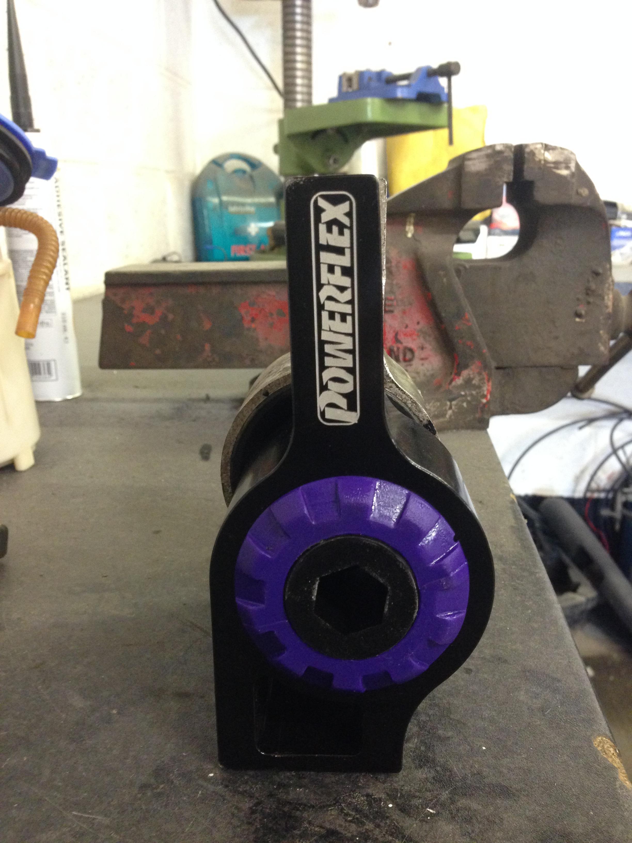

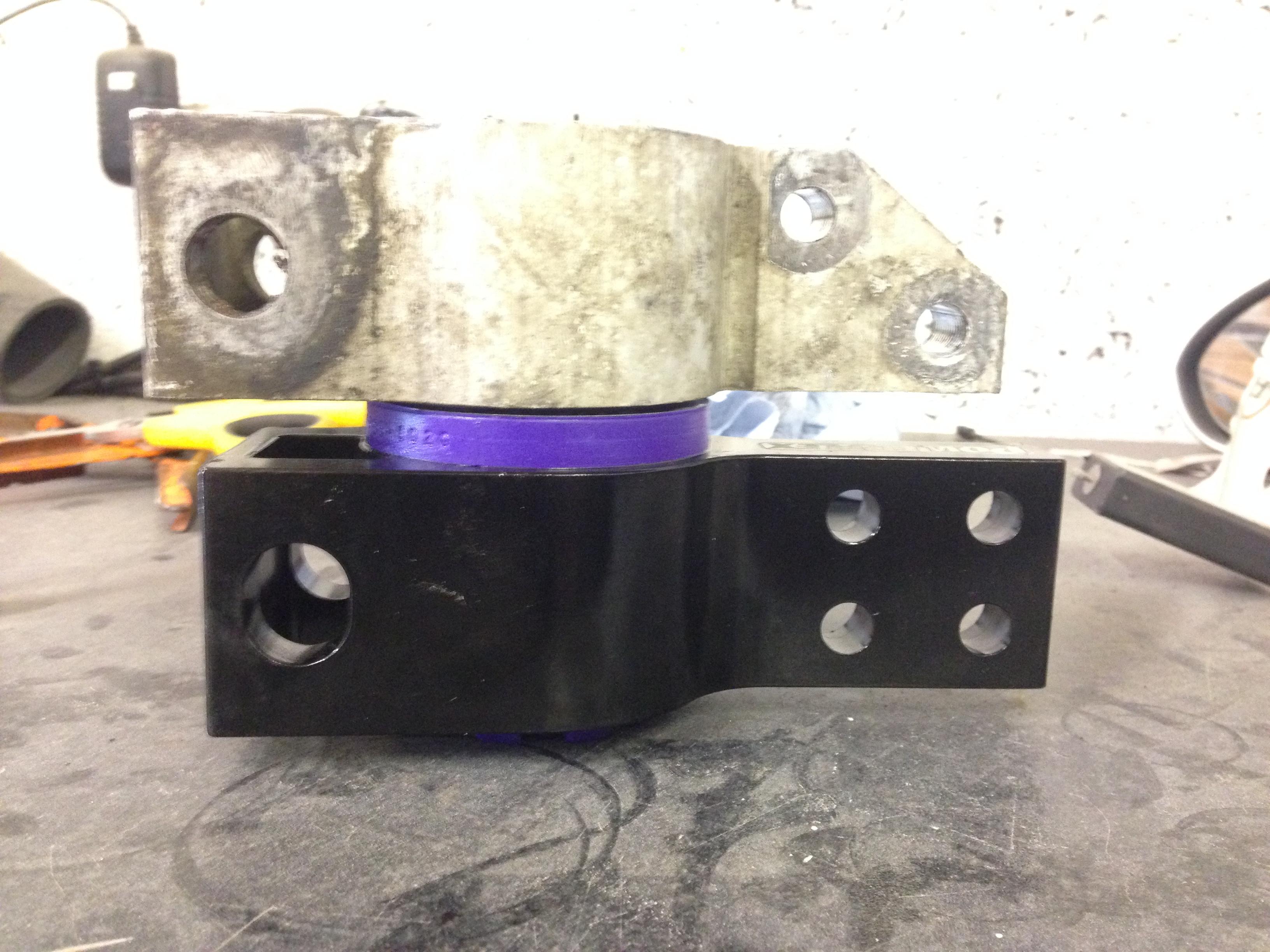

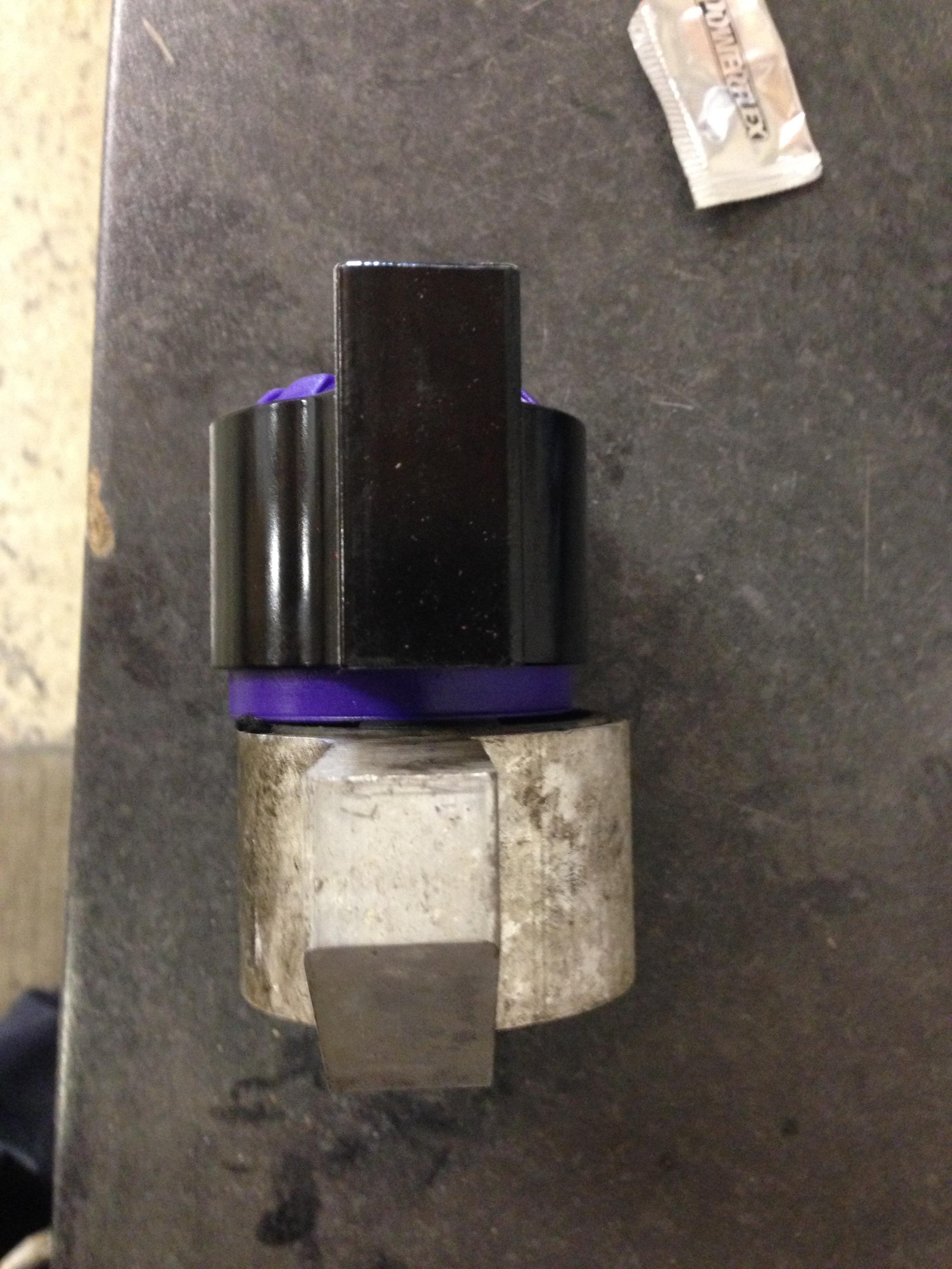

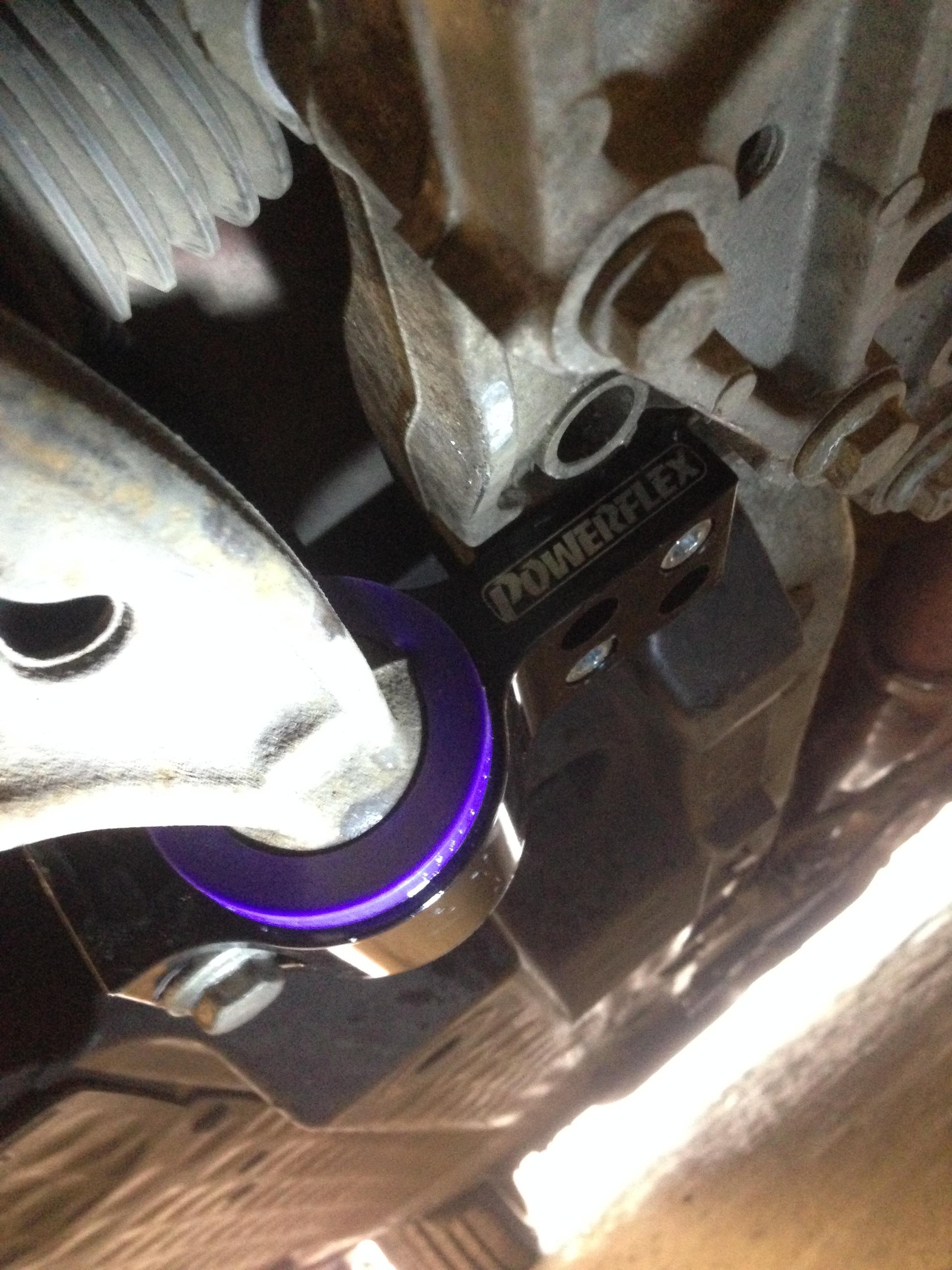

« Reply #9 on: May 18, 2015, 08:25:08 am »
They arrived at the end of last week
So saturday removed old units and compared
Then fitted
And my 3rd geo in a month
Touran TFSI Quattro | stage 2+ BHZ | UK's first

« Reply #10 on: May 18, 2015, 08:35:06 am »
ok so having used them for mixed driving for 2 days, 50 miles country b roads, 20 miles dual carriage ways cruising and fair share of hooning i'm happy.
obviously there is still wheel spin but a lot less fighting the wheel and it definately hooks up better
they are slightly more harsh (understandably) mainly over manholes and particularly ridges in the road that both wheels hit at the same time but not as bad as i was expecting
turn in is slightly better aswell
car feels more planted and definately more stable under heavy braking
oddly enough the old bushes (6 month old genuine) showed no sign of wear or tears, i guess the compound is just not up to the job
so;
slightly harsher ride
better grip in turns
more stable
almost no squirl under heave braking
almost no more wheelie action
massively reduced torque steer
wheel spins reduced and more controllable
so far so good  :happy2:
will report back in a week or so when i've put some more miles see how they're settling in  :driver:

« Reply #13 on: May 18, 2015, 11:27:44 am »
not too bad on a jack on the floor, old ones took a bit of persuasion to remove.
the hardest part was lining the bolt holes up after, just took a well placed lever bar and a little patience, i think took 45 mins all in including photoshoot  :grin:
i would have honestly preferred to use stock bolts rather than the allen head bolts, just makes me nervous if they sieze and you want to remove them will be ball ache.
but so far a very worthwhile mod  :happy2:
