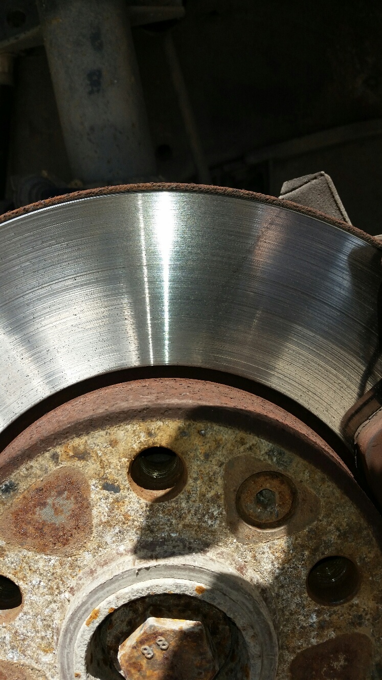

I pulled the wheels off to double check the discs and pads.
The inside rear pad is completely worn out the outside is nearly gone.
The front pads have plenty of meat on. This is how the front discs look. Should i leave the fronts??

They look ok unless there is a massive lip on then?

The lip is ok will just do the rears. Don't think them discs will come off easy.

As long as the discs are still above the minimum thickness I wouldn't bother replacing them. I'd take them off though and copper slip them now though as it'll make an eventual change a lot easier should you need it in a hurry. Make sure to give it all a damn good and treat her a little bit better, she may reward you efforts. :happy2:
